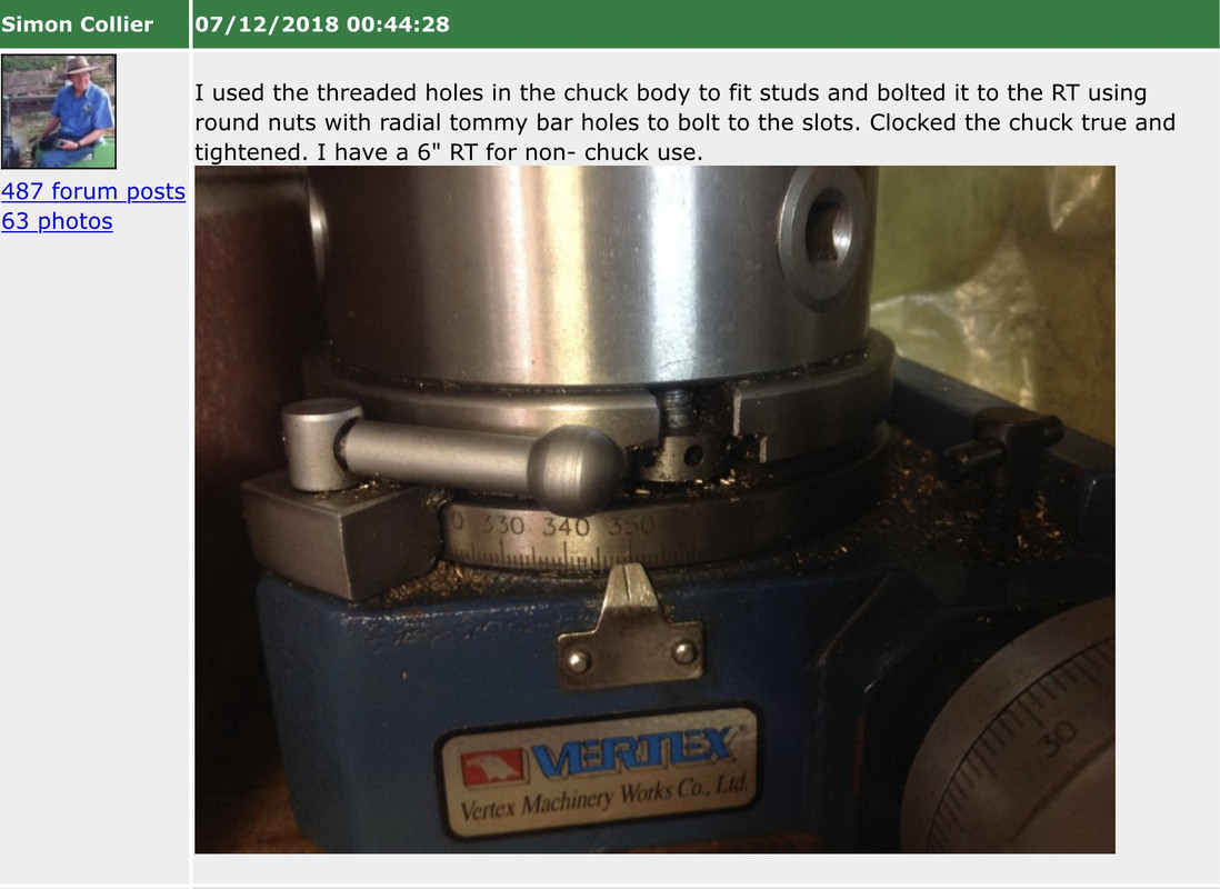

Thanks for the tip Dave, yes that search is so much better! Sorry, another question. Folks have said four slots are better but how do you fit a scroll chuck with three studs to a table with four slots? I’ve seen a simple way of mounting on a three slot table without any adapters etc, just using studs and round nuts with holes for a Tommy bar.
I hope Simon doesn’t mind me posting this but it’s such a clever and simple idea. I’ve seen a RT at a good price but it’s got four slots so I’d be keen to know how to mount my Chuck without having to make an adapter. And why are four slots better anyway?
Edited By Vic on 24/12/2022 18:46:50

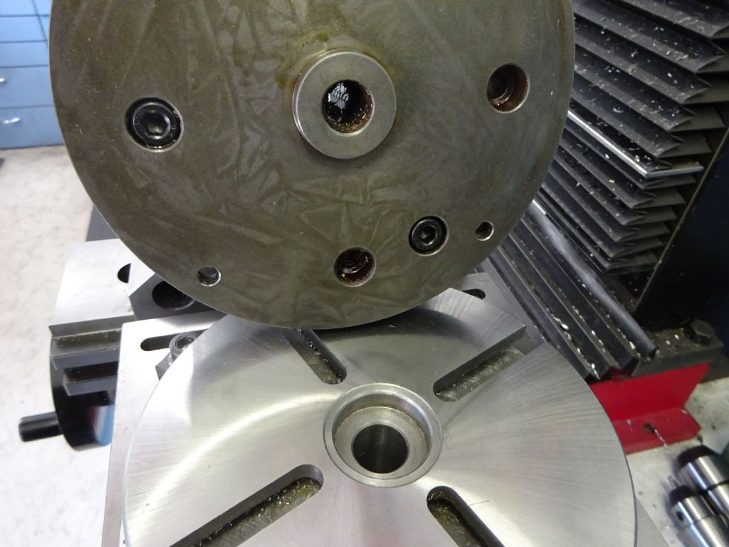

I have two 3 Jaw chucks mounted on backplates that are a bit larger than the chuck body which allows the backplate to be held to the table with tee nuts, a spigot on the backplate to locate in the table's central hole make sfor easier set up.
4 holes also make sit easier if you want to fit a vice to the table
I would go with 72:1 or 90:1 on a rotary table as anything lower like 40:1 is better for dividing that curved cutting.

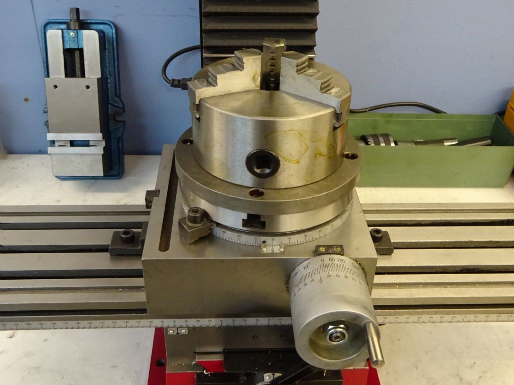

Yep - Jason beat me to it but my set up is the same - chuck to plate, plate to table. Plate has locating spigot to fit table bore, chuck has locating spigot to fit a recess in the plate and the chuck bore.
Ditto with the four versus three slots - four allows more versatile clamping of parts when using table alone. Buying a three slot just so the chuck can be mounted is limiting the versatility for something that is not used that often - well not on the R/T in the fashion shown. Both Jason and I have R/T's larger than the chuck body but you can still have a plate interposed even if the diameters are the same.
Though I do use a chuck as shown its rare in comparison to sub plate set ups and four slots are definitely more favourable there.
