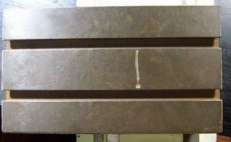

This is what it looks like from above:
The horror ...

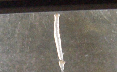

And this is a close up:
The horror ...
Fortunately, the damage is circumscribed/limited to just one section of the surface and does not extend past the border.
And allthough I expect that it does not affect how the table works, it is way past horrible.
I was wondering if the any of the members of the forum has come across this type of repair job and could offer some advise.
Thanks in advance.

Martin Connelly06/06/2022 17:18:14
avatar
2549 forum posts
235 photos
The best thing to do is to just use a flat sharpening stone to remove any high spots and stop at that. You could make things worse by trying anything beyond this.
Martin C
Brian Wood06/06/2022 17:32:16
2742 forum posts
39 photos
Julius,
That looks like an over-run scar of a milling cutter on break through into work clamped to the table without clearance below. Despite the appearance it is really only superficial, once any raised burrs on the side of the damage have been dressed off. Trying to fill it to hide it will be ineffectual.
A clean fine cut file laid flat on the table surface will remove any raised material without harm to the rest of the table. Try to use the file to cut across the narrow dimension; depending on the length of the file you may have to stroke at an angle. When the raised material is removed satisfactorily, you should be able to slide a flat piece of steel across it without catching at any point
Regards Brian
old mart06/06/2022 17:57:34
4655 forum posts
304 photos
OK, it looks bad, but fortunately will have little practical effect on your milling. When the museum inherited the Tom Senior light vertical mill, the table was covered in scars much worse than that. I milled off 1.5mm from the surface and we then spent months rubbing it on the surface table to remove the milling marks. The surface table was covered with 120 wet and dry paper held on with double sided tape. I knew from experiance of using this method on aircraft parts which were then checked for flatness by the inspection department that 0.0005" or 0.012mm was easy to achieve. The mill bed has now only 5% of the damage showing. If the damage was similar to yours, I wouldn't have bothered.

This can happen if a cutter pulls out of the collet, I have had that!

Welcome to the party ! I can't see it in the first picture so I wouldn't worry about it. Just remove any high spots and carry on. Best wishes Noel.

Yes, that was the first thing I thought of: a good sharp/very flat stone, I've used that before.
And yes, I agree that the possibilities are against me.
I'm sure there probably some milling table Dr. who could TIG up the scars and then level it all but I fear the price, given the amount of work involved, would surely be hefty, to say the least.
Brian W.:
Yes, I agree that it would be just for keeping it tidy, so to speak.
Nothing much besides that and my being excessively meticulous.
It's just damn ugly but should I decide (given it's value) to part with it, a talking point to consider.
I'll have to find a nice flat file, preferably long.
Or maybe 200+300+400 W&D paper on a piece of plate glass?
I've used that method once to recover a heavily battered but high quality kitchen knife without the aid of a proper belt sander.
Old Mart:
Yes, I agree with the general consensus: once the burrs are taken care of, it's of no practical effect.
Stuff will get in there but the gouging is shallow.

I understand the confusion, there are three photos.
One (the first photo) is of what was usually sold to the public ie: the complete milling machine setup.
The other two (second and third photos) are just of the damaged surface on my table: from above and another closer up.
This old Minolta thingy I take photos with has a focus issue but it gets the idea across.

You could mill that damage out. A shallow cut in the Y direction just over the damage would look as if it's part of the design.

It's only a small table so you could have it reground.

I have not measured how deep the gouging is, my guess is at least 0.5mm at the deeper parts.

I would not mill it or rub the table on emery paper on flat glass. Too likely to do more damage than good.
Stick with a quick rub with a flat stone or fine flat file just enough to remove any raised burr around the very edge of the gouge mark.
You don't want to turn aesthetic damage into dimensional damage.

If you were going to mount a vice on the table most of the time, the vice could sit centrally and just avoid the scar. In this case, the scar being there would be no practical problem whatsoever.
It's hard to tell how damage like that would have happened. It looks at this distance like someone was milling a slot with a blunted drill bit whilst moving notionally in the Y direction but with small deviations in X and Z.

And if the aesthetics really bother you, after filing/stoning the burr off it, you could fill the gouge with epoxy casting repair compound such as JB Weld and then very carefully file that back down flat, without filing down the surrounding area. Personally though, I would stop at filing or stoning off the burr. Once its all covered in swarf you won;'t notice it. Or as Bill says, bolt your vice over it!

I find that scratches often look worse when they reveal a different lighter colour underneath. After you have stoned the burr off rub a little cold gun blue cream into the scratch to brown/blacken the silver and it will make it much less visible. 🙂
