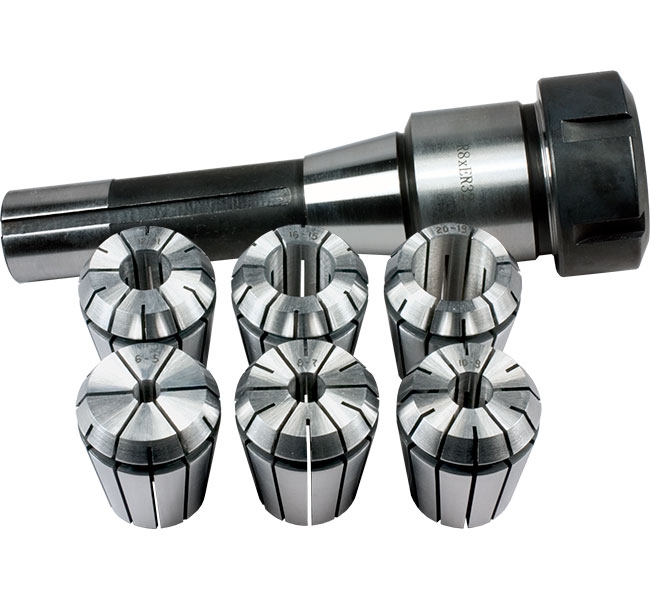

Collets usually have excellent concentricity but only a tiny grip range. In many systems you need a 6mm collet for a 6mm drill, and the number of collets needed to cover all the common imperial and metric sizes is scary.
Good news! A relatively new collet system, ER, has collets that squeeze down a full millimetre much reducing the number of collets needed. The picture below is from ArcEuroTrade, other suppliers available. There's a collet chuck which plugs into the mill (be sure to get the right taper for the machine R8, MT etc), and then a set of individual collets. The most popular hobby size is ER32, covering 1mm to 20mm. ER40 does larger sizes, ER25 smaller. ER collets are used to hold drills and milling cutters (including threaded shanks), plus wobblers, in a mill, and are also suitable for holding work accurately in a lathe. (For which another chuck may be needed.) Have a look at Warco's offerings for prices and what's available.
When buying collet chucks, prefer the type with ball-bearing nuts which are easier to tighten than the plain type. (They like to be tight!) Ball bearing nuts can be bought separately and retrofitted.
I only fit a drill chuck to my mill when drilling lots of different sized holes all in one session, which is rate. The drill chuck allows faster tool changing, which is worth it when drills are being constantly swapped. Otherwise collets are somewhat slower but you get lower run-out and much better resetability.
