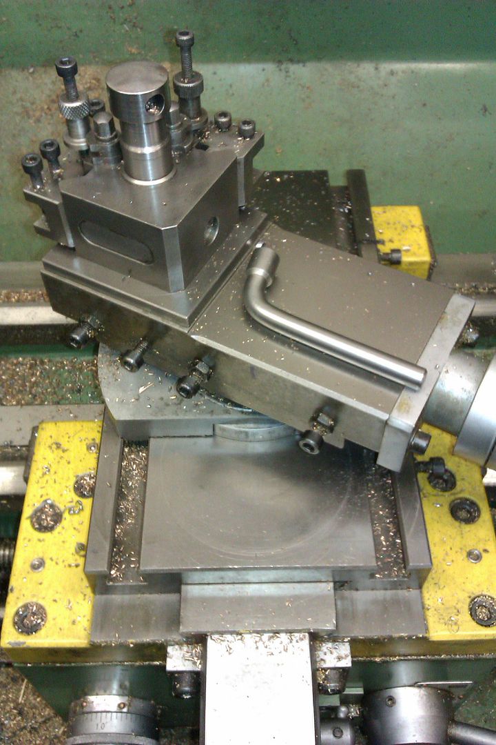

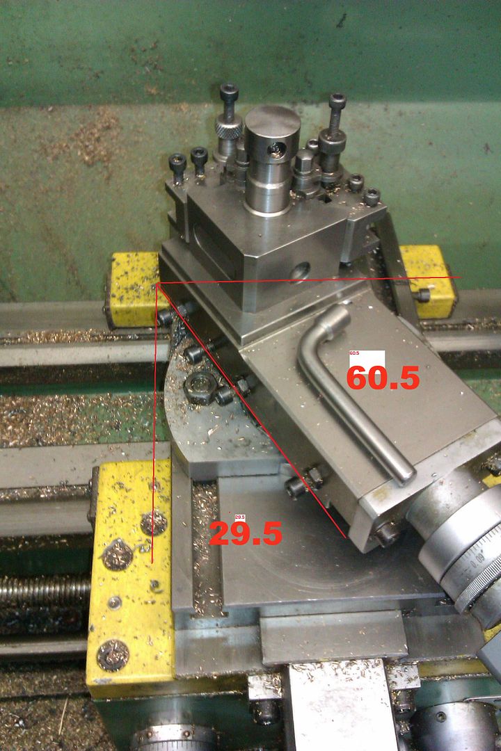

Hello everyone, I'm looking for some advice on a screwcutting problem that I have come up against.
I'm trying to cut a 3/8" x 24 t.p.i. on my Myford ML7. I have set the cutting tool height exactly using a DTI and a height gauge just as I have for all my other cutting tools. The compound slide is set at 30 degrees and checked using a friends vernier protractor, and the tool set to the correct angle using a Moore & Wright screw cutting gauge.
I put a piece of waste mild steel in the 3 jaw chuck with a dead centre in the tail stock lubricated of course. The cutting tool was moved to just a scratch cut using the cross slide (and the reading noted ).and the half nut engaged. The cutting was taken away from the material using the cross slide and the half nut disengaged etc. A new cut put on using the compound slide, cutting tool moved back to the original position and another cut taken.
I repeated this perhaps 4 times, only putting on a cut of 0.004" each time and then examined the thread cut so far using a magnifying glass only to find that it seems to only be cutting on the tailstock side of the thread not the headstock end, so doesn't seem to be advancing.
I haven't done any screwcutting on a lathe since I was an apprentice, but have looked in my old college work books, some workshop practice series books,L.H. Sparey the amateurs lathe and some videos on utube etc. They all do the same as I am doing, except their threads seem to be advancing, whereas mine don't, can anyone offer up any advice please, as I am at a total loss.
Many thanks in anticipation and advance.

You can't set a standard ML7 topslide to 30 degrees from square to the lathe axis. It won't turn that far. When the graduations on the topslide say 30 degrees, it is 30 degrees from parallel to the lathe axis. Which is not where you want it for screwcutting.
With the ML7 you have to use the method common in industry, to save time resetting the topslide. Leave the topslide in the normal 0 degree position, ie parallel to the lathe axis. Then use the topslide to advance the tool by half of the depth of cut every time you put on a cut using the cross slide. So if you feed the cross slide in 10 thou, advance the topslide 5 thou,and so on. This by the miracle of sines and cosines and dumb good luck, moves the tool point in a path that turns out to be a very slight bit under 30 degrees, so perfect for screwcutting. It works for 60 degree and 55 degree threads.
For 29 degree Acme threads, you advance the topslide by a quarter of the infeed. So 10 thou on the cross slide and 2.5 thou on the topslide.
Super 7s and ancient Drummonds and just about every other lathe can pivot the topslide to the correct 30 degress from square, or 60 degrees from the lathe axis, but they forgot to do it on the ML7 for some reason. Cheapness of manufacture I would suspect. You can modify the ML7 with two strips of steel attached to the sides of the cross slide with holes drilled and tapped to take the topslide anchor bolts, putting them at 90 degrees from the original position. Too much faff. Everyone uses the above described method instead. Or just plunges straight in and hopes for the best.

Thanks gents, it makes perfect sense to me now hopper, I have set it to 30 degrees from parallel, not from square to the job.

I don't offset either but took these photos some time ago which illustrate Hoppers point about the angle as it crops up quite often
You want it like this
But I suspect you have it like this
