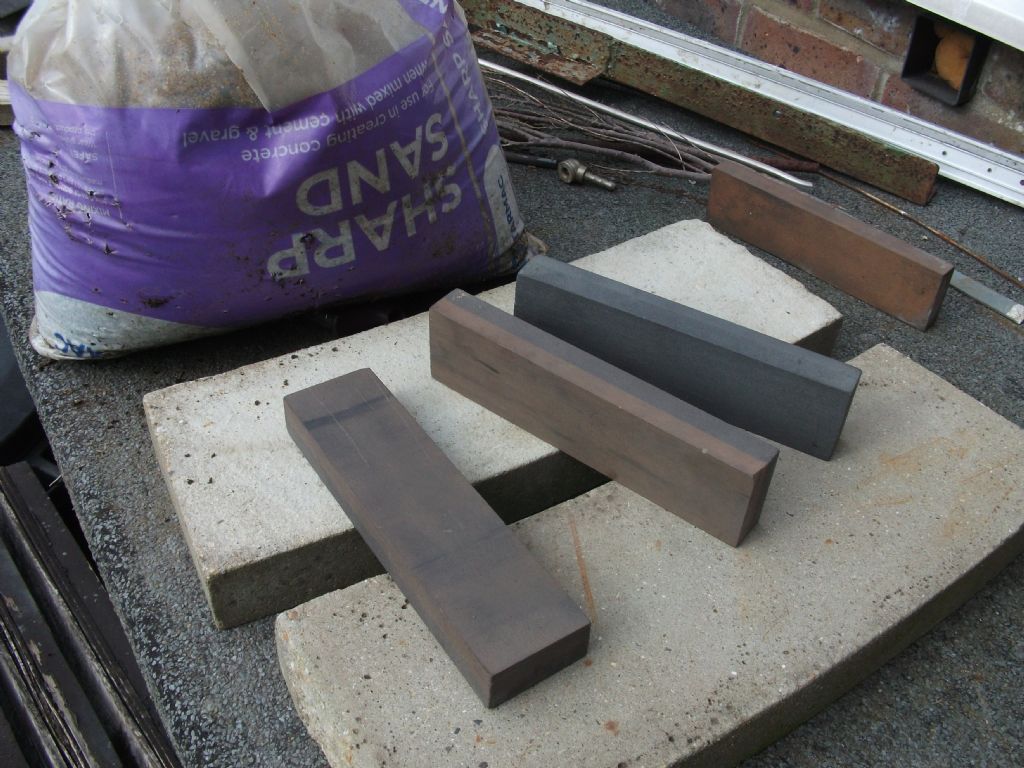

Here are some flat stones that made some time ago ,as Brian Wood has
said they can be easily formed by rubbing in three's to eventually get to
a flat condition, two of these three i already had but were badly hollowed
the third i bought from a second hand shop in much the same condition.
Using two concrete slabs that are fairly flat to start with and some sharp sand
they can be conditioned to bring them to a flat surface and from
there on the oil stones can be flattened to take out the dips,it is a long
process and best done in short sessions,Final finish using wet and dry
paper on a surface plate with paraffin as a lubricant and then lapping them
together.
You can not get to the same finished edges as described in
Robin Renzetti's video here
https://www.youtube.com/watch?v=DVLXsq7pi9Y
but they work well enough on just plain flat surfaces, not worth doing
if you don't have a surface grinder to finish work in the first place.
