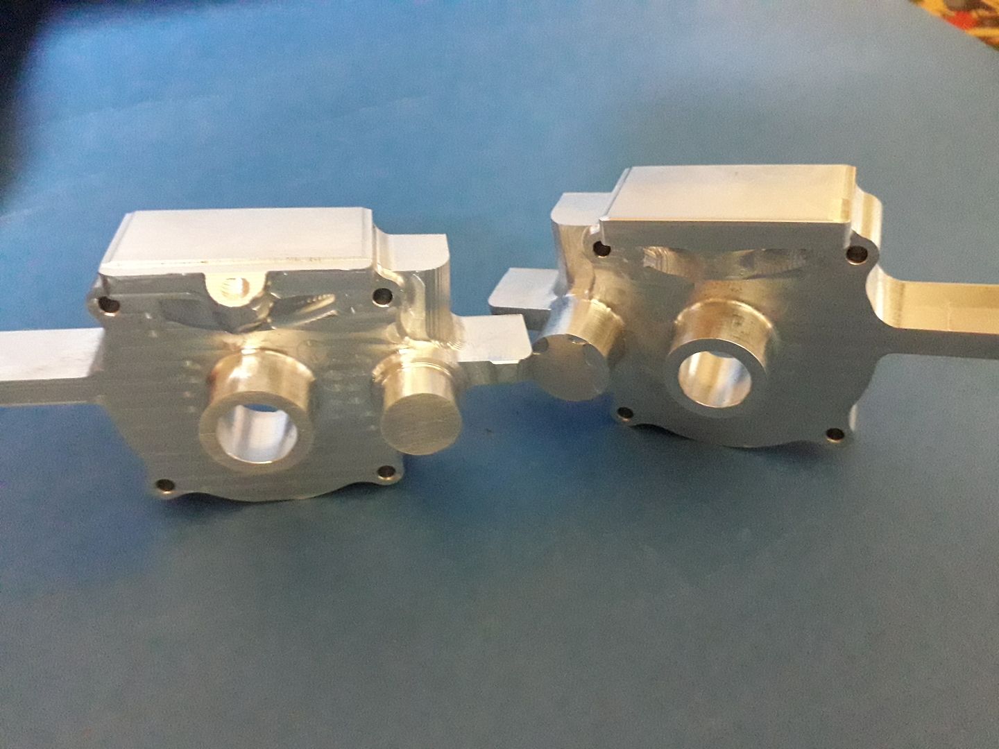

Rather than Hijack the "Whatch this Space" thread with further discussion of CNC machines casting kits I'll repost something I wrote on another forum a few months back:
I have mentioned it before a few times about being able to resurrect some of the older designs where patterns have been lost or if they are still knocking about and usable the owner can't find a foundry to cast them. With modern CNC it should be possible to reproduce these castings with the added bonus of none of the usual casting defects such as blow holes, undersize parts, hard spots, over fettling , etc and leaving the builder to do the final work such as finishing bores, drilling and tapping of holes etc. much as they would with a traditional casting
This video of E T Westbury's "Whippet" being machined would be the perfect example if the machining were stopped before the final holes were done, I'm sure they would sell
And what a set of "castings" may look like
I have enquired about costings but as the company can produce a fully working engine for $499 I should think that the castings would be quite favorably priced compared with what is available in this case from Hemmingway at about $200. If so it would be nice to see some of the "lost" engines from the likes of Wall, Westbury and the Motor Boys plans being made available to those who like to build them rather than just the collector of ready to run engines.
A couple more examples of my own making, a bedplate for a small long out of production steam engine
A flywheel again from a 1930s design long lost.
Crankcases never a commercial casting but taken from a 1936 magazine design
There seems to be a market for part machined barstock kits from the likes of Bengs so it would only be a small step further to have some more shapely parts. I think even Stuarts are supplying some of the smaller items CNC cut these days like the valves for the 10series so it may not be as far away as you think.
Discuss.

The "castings" that Jason shows above say to me "investment casting".
Perhaps the dividing line is between gray iron and tempered 356 aluminum; ie: tempered 356 cuts pretty well, and would probably be easier on a CNC machine.
Gray iron machines well too, but it seems like more power is required.
From a mass-production standpoint, investment casting is the way to go.
For one or two off production, CNC would seem to make sense as an option to castings.

Pat, yes the CNC will produce a much better finish than the average sand casting even oil bonded ones so a lot less fettling to do to get a good surface for paint. I think those whippet ones have been bead blaste dto remove the visual machine marks though I expect it is almost impossible to actually feel what can be seen.
That bedplate for example was cut from poor quality salvaged grey iron and what you see is straight off the machine, there is a 3deg draft angle on the vertical sides made with a series of cuts as the CNC ramped the cutter down gently as it went round and round the contour. I just lightly deburred around the tops of the bosses with a bit of Emery and this is it straight after the first coat of primer, the few dark specs are small voids in the iron. You won;t get that straight out of the sand pit.
There is no real dividing line between metals, the bedplate and the flywheel were cut from solid iron, the crankcases from 6082. In much the same way as you would on a manual machine a slower speed and lighter cuts are used on iron and steel than you would with aluminium and non ferrious. This assumes a rigid enough machine, a lightweight router type machine may not cope so well with iron but it's much the same for the home foundry as not many can get upto iron casting temps but aluminium is not such an issue with a small furnace and burner.
For decent investment casting then it's better to print using a wax fillament and melt it out than a plastic that has to be burnt out as it's easier to join them onto trees and you don't risk leaving ash in the mould
