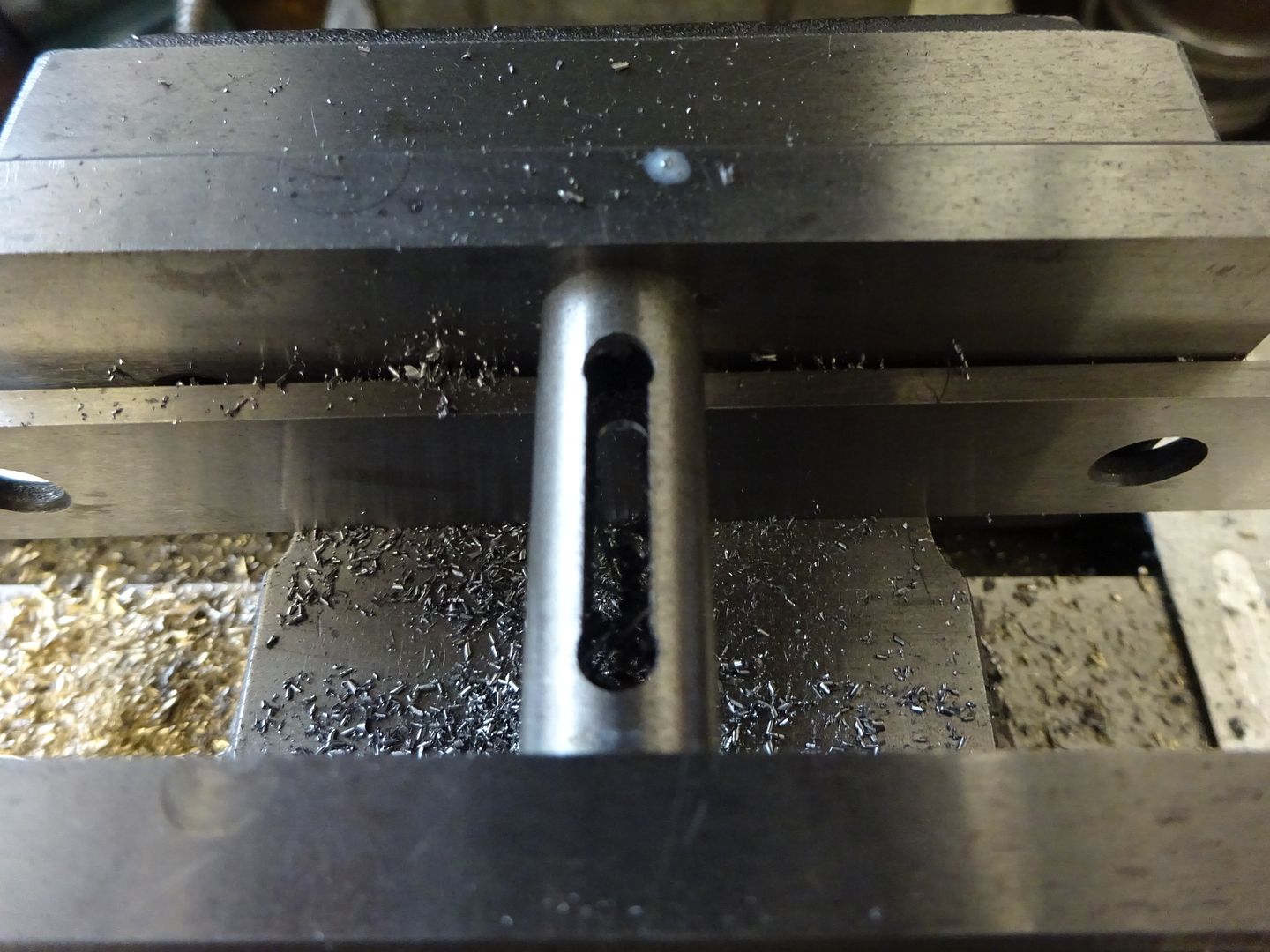

Posted by Mike Donnerstag on 07/01/2022 18:35:39:
. Can you also mill the slot using the 3-flute cutter, or would you switch to the 2-flute?
I tend to use 3-3lute most of the time just changing to a 2-flute if I have the size when I want a very accurate slot as the 2-flute should not cut over width, or you can use a slightly smaller cutter and then either move sideways to get the width you want or run down the middle of a narrower slot which is less likely to see a cutter being pulled sideways and cutting over width.
This recent one was drilled 4.8, milled 4mm and then finish milled 5mm both 3-flute cutters even though it was not a critical width. Both milled in one pass each of the two 1mm thick walls
Edited By JasonB on 07/01/2022 19:04:22

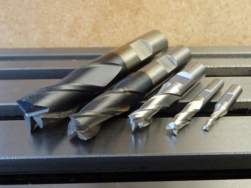

JasonB08/01/2022 07:06:12
avatar
25215 forum posts
3105 photos
1 articles
Yes they are the cutters that have a flat on the side also sometimes called "sidelock". Supposed to be named after the Weldon Company in the US who first invented spiral flute milling cutters and needed a way to stop them being pulled out, prior to that they were parallel flute.
