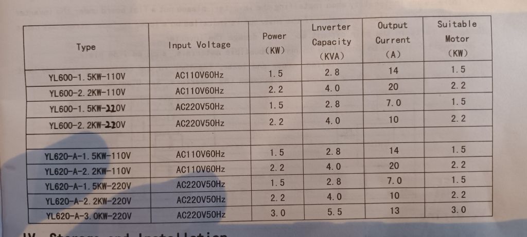

I'm running a 3hp 3 phase lathe via a VFD. I matched the VFD to the motor but on reasonable sized cuts 1.8mm off the diameter (on steel) it trips. Is this likely to be one of ghe settings or is it better to oversize the VFD?

Remember that when you turn the speed down the power available will be less, using the belts or gears to keep the motor running at near its rated speed will maximise the power available. The VFD should have the motor current set to the full load current of the motor. Does the VFD error indicate an over current trip?

I have a chipmaster so I vary the speed via a mechanical variator and it has a clutch so the vfd runs the motor at a constant 50hz. It is tripping on error code 4 which covers a load of sins one of which is over current. I definately bought cheap (you can tell be the manual!!). I am thinking I will simply replace it with something better. That's really the reason for my question will a quality 3hp vfd (3hp motor) be enough or is it still better to somewhat oversize.

Just saying it trips with an overcurrent fault does not tell us much. For the particular setting that is currently programmed into the VFD, 'over current' could be 0.5A.
As Mike says, the maximum current value is normally a user-settable parameter in the VFD. Read the manual or post a link to it and the VFD here and we can advise further. Try to measure the current the motor is actually pulling: separate one of the phase wires from the others and put a cheap current clamp meter on it.
Make sure the ingoing supply to the VFD is adequate - cross-sectional area of wires and length of cable, even more so if you decide to pursue your 'somewhat oversize' route.
Is the output of the VFD wired directly to the motor?

img_20211106_081920.jpgimg_20211106_081901.jpgimg_20211106_081754.jpgimg_20211106_081451.jpgI'm happy that the motor is operating OK as best I can. All the insulation resistance was checked on installation. I'm OK with the incoming feed. Its on a stand alone ring (2.5mm twin core and earth) and is no more than 5m from the main box. It all runs fine when I am taking it easy but starts to trip when the tool loading goes up. I do struggle understanding the manual I've copied what I think are the relevant sections below. At the moment the display is set to frequency I think this can be reconfigured to motor current would this be equivalent to actually measuring one of the phases?

A typical motor rating plate for a 3 phase motor suitable for use with a single phase input VFD will quote a voltage for star and delta connections and also a full load current (FLC) for both connections. Typical figures for a suitable motor will be voltage in Delta 220v and star 400v, currents for a 2.2kW motor will be around 8A in Delta and 5A in star, The VFD parameters should reflect these figures for your particular motor. I believe the Chipmaster had a two speed motor and these are not usually suitable to run from a VFD. If this is the case then a more suitable motor may be required. A picture of the motor plate would be great but I understand it is probably not very accessible in the machine.

The motor plate shown in your Album is from a 4 pole (1450rpm) so you need to change that in parameter settings if the plated motor is on your lathe.

I reconfigured the motor to 220v 3phase. I sized the vfd on a simple 3 hp motor is 2.2 kW so I bought a vfd rated at 2.2 kW. I am seriously wondering because I went cheap it's only going to be good for 2.2kw on a good day. My lathe is nearly 50 and driving through a similar aged variator. I think I might just go better quality and a bit bigger say 3.5kw and get a bit spare in the bag.

Colin before running out and buying a new VFD check that P12 is set to around 8 amps

What is the actual current setting on the VFD? This is P12.0 (motor) and P12.5 (drive). The tables you show say 5A set but that a 2.2kW VFD output is 10A max.
