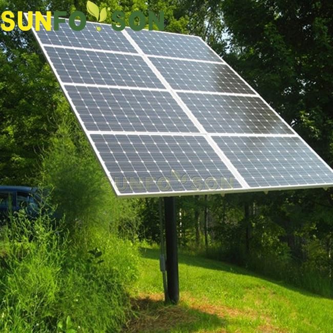

I'd looked at bearing like used on a washing machine etc but all are too small/flimsy. On the other hand there are "proper" slew bearings as used on 360 degree excavators etc but very pricy /large to experiment with.
Its a single axis tracker I was interested, single pole mount is quite popular around the world and even in the UK.
This is a similar size to what I am doing. The support is very much like a roof with the panels attached to the correct alloy rails with clips
However it is fixed, I want mine to rotate as the next step, hence the question in case someone has already done it or has practical experience of it.
I may end up with a grid ties inverter etc but it's heating water, matched to an imersion heater. At present its running at 156v and 312w in todays cloudy conditions, full sun is 1100w.
