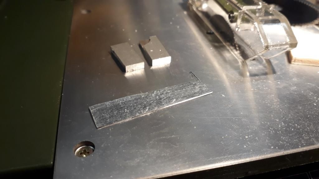

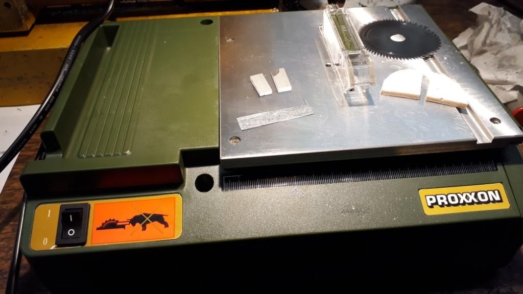

I use one of these small Proxxon saws with a HSS blade for cutting brass, aluminium and thin steel. You would need to check the clearances if you are working with larger sheets. The fence will go either side of the blade.

Both Chronos and Axminster Tools sell the various Proxxon saws and blades .

This is the closest example I have of what you would like to do. This was 0.3mm Phosphor Bronze. I have cut up to 3mm thick Brass.
**LINK**

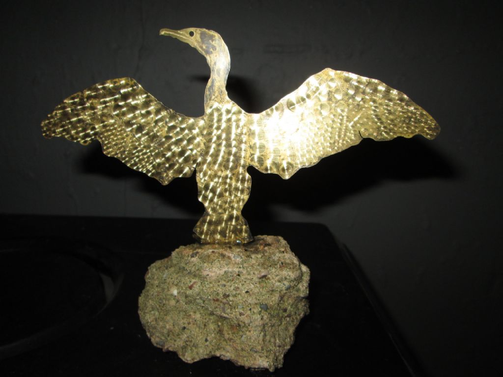

This is the sort of thing you can make from 0,9 or 1mm brass/copper with a scrollsaw. If you're after accurate square or rectangular work you'll need to make a fence.cormorant1.jpg
