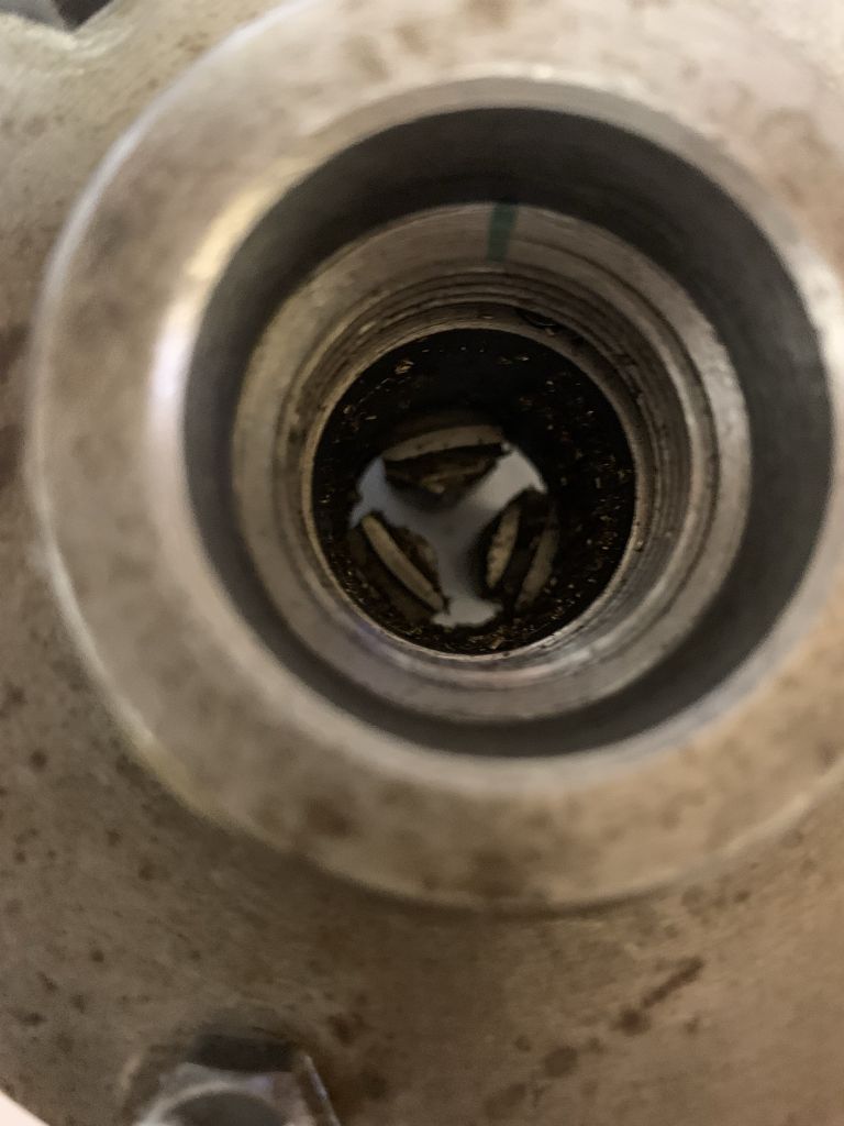

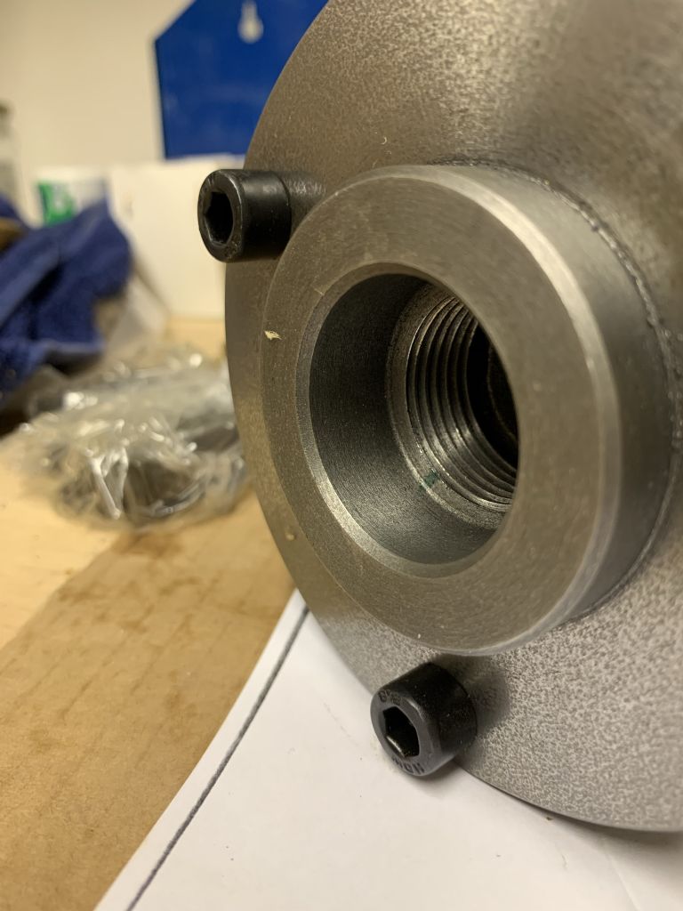

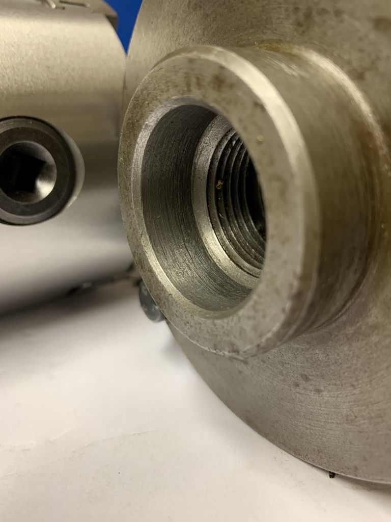

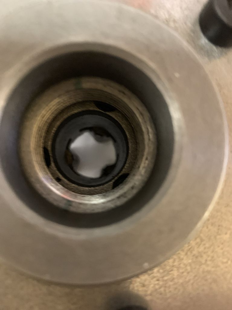

7560fbfb-f111-43ca-bbe9-ac026cd0f81b.jpegRight it says file for video too big, but I managed to do pictures, I have marked the start of thread with pen it starts at 12 o’clock position and my chuck is a full turn to form the thread whereas new chuck seems to have it formed just after half a turn. The way I have written that is not very clear hopefully you can decipher my poor explanation. I have managed to post the same picture twice but I can’t see how to delete the second copy.ac21575e-8dde-404e-a37d-05c7fbf059cb.jpegac21575e-8dde-404e-a37d-05c7fbf059cb.jpeg

e25aee9f-5063-4cbb-8f17-1bc0fdda111f.jpegThe Chuck on the left is the new one, the first thread is nearly square but on my old one on the right it seems to be formed correctly or does that not matter. I found a thread gauge and they both read at 12 tpi but I am sure the gauge hits the top of the threads on the new chuck but I think the gauge has a small gap between it and the top of the thread on the old one, I think the thread is not deep enough.Thanks Richard

You will all be getting fed up with me now, only one picture downloaded, here goes this is the new Chuck.

Hi ,I had the same problem with a backplate for an ML7, I bought a tap ,tapped the hole and backplate went on ok by hand

Maybe the thread needs to be truncated by a couple of thou, to prevent root / crest interference?
Put a substantial bar into an existing chuck.
Skim to obtain a concentric diameter.
Clamp the new chuck to the bar.
If the chuck on the mandrel is a 4 jaw, clock the register of the new chuck and centre as accurately as possible..
Skim the thread of the new chuck, to take out just a thou or so.
With a thread depth of 0.053", the core diameter should be 1.019", so you are looking to enlarge the ID of the thread to about 1.022 / 1.023.
Possibly, before you start work on the new chuck, turn up a piece of bar to 1.022/3" to use as a plug gauge.
Hopefully, the truncated thread will allow the chuck to screw fully onto the mandrel.
