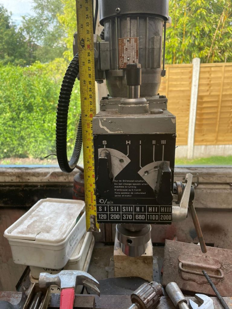

Hi,
I am stuck at the first hurdle, the drawbar won't screw into the internal thread so im assuming its damaged and needs to be re-tapped. I have no idea what how the spindle/chuck/draw bar interface with one another.
There is currently an "s" Type autolock in the machine which i can't remove, but i don't know how it fits into the machine whether its by taper or screwed.
I've madfe an album but will try and attach some images when i can figure out how, if someone can assist it would be appreciated!

top of spindle.jpeggeneral mill.jpegautolock.jpegSee below the images, which will hopefully help get some answers!

It's held in with a #2morse taper.
The thread is likely imperial

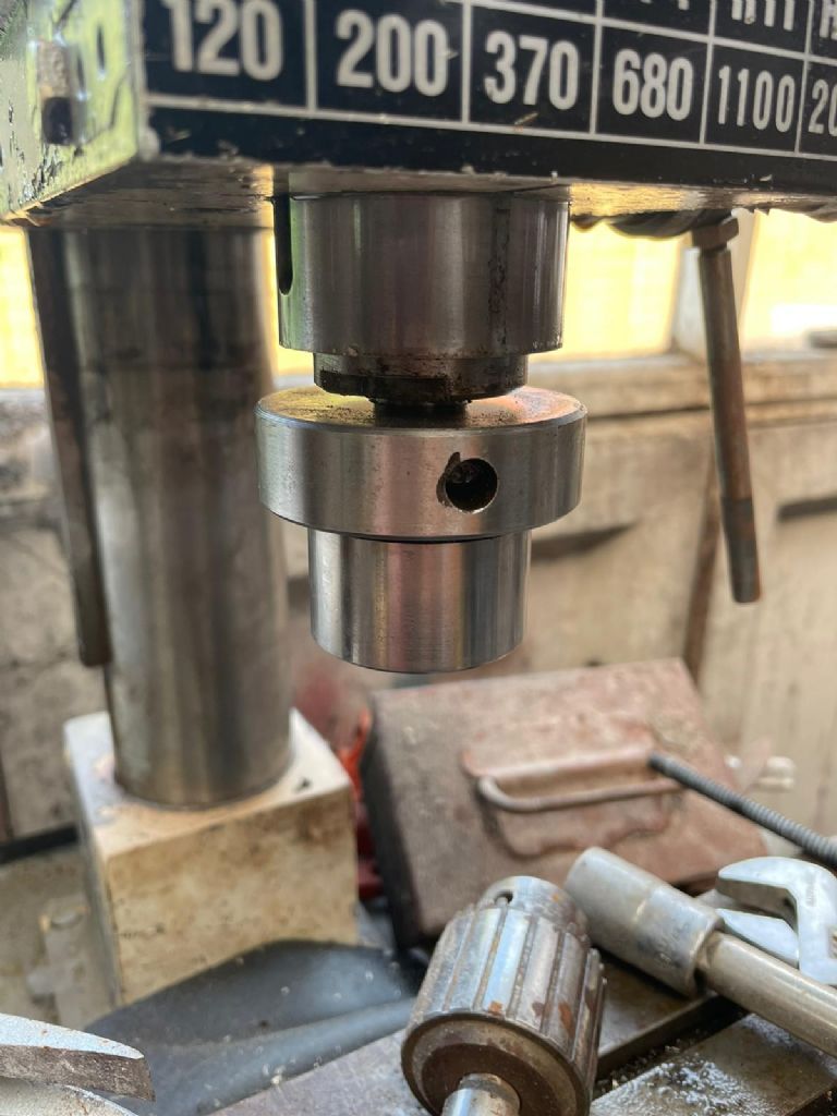

If I remember correctly the drawbar thread is 3/8 whitworth, the large ring on the chuck should unscrew, it is supposedly a stiffening device but can also be used as an ejector by winding it up hard against the bottom of the spindle and giving it a good wallop.

I would not be hitting the spindle of an FB2 (clone, by the look of it). Light duty parts & IIRC a "strange" bearing arrangement for the spindle and indeterminate parts situation - easy to damage something you may not be able to easily replace & when parts were available they were pricy.
If you got all the tools with the machine, there should be a thin sheet metal spanner to fit the flats on the end of the spindle nose - hold the spindle against rotation with the spanner & use a tommy bar in the support ring on the tool holder to jack the tool out of the spindle. It may well go with a bang, so have a piece of wood on the table to prevent damage when the tool is ejected. The drawbar should be axial restrained under the nut at the top of the spindle & this usually jacks the tools out. IIRC the original drawbar was M10 (actually an M10 socket head cap screw) - I can check when I get home if that helps.

The collar on top of the chuck is probably threaded with a fine pitch left hand thread. In use you are meant to snug it up against the face of the arbour to stiffen up the mt2 taper. You might be able to use it to jack the taper out,but try to get a proper Peg spanner rather than just a Tommy bar

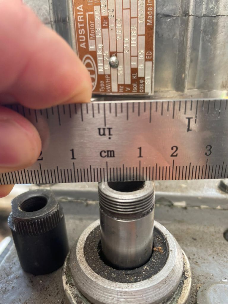

Duncan has just reminded me of the method that I now use . I have a 32mm spanner machined down to 3mm thick which goes on the nose of the quill and using a "C" spanner in the dampening ring of the Clarkson (as Duncan mentions and from memory a left hand thread) you can eject the chuck easily. Use a cloth for the chuck to drop onto to avoid damage to the chuck. Best of luck.

Michael, the Emco has a self ejecting mechanism for the MT2 tooling, it uses the draw bar and the small cap in photo 1. The draw bars are Allen screws and with the black cap in place you unscrew the draw bar until it comes to the black cap then continue to eject the taper.
I appreciate you say the thread is damaged so maybe you cannot use this method, however the type of Clarkson chuck you have has a stabilising collar that is threaded onto to body of the chuck, during use it should be snugged up to the spindle face. You MAY be able to use this feature to release your chuck by using a spanner [supplied with the machines] on the 2 flats on the spindle and a tommy bar in the Clarkson chuck collar it will hopefully eject the chuck --- put something under it to stop it dropping onto you mill table !!

Looking at the gap in the photo, and knowing that the ring can be screwed up and down, I would try a pair of motorcycle tyre levers. A block of wood placed underneath to limit the sudden movement to about 1/2" when the taper breaks would prevent any damage. The thread seems like being a choice of 10mm and 3/8 Whitworth. Tom Senior mills with MT2 definitely used 3/8W.
