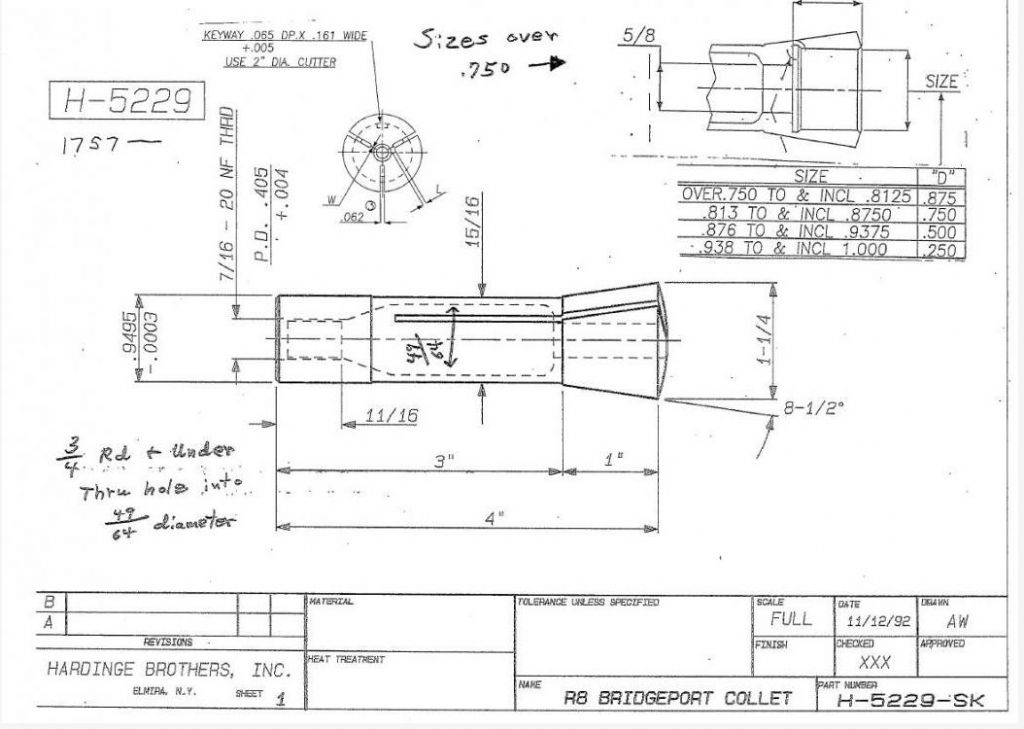

Anyway, I've just tried to get my R8 ER32 collet chuck mounted and it won't! Pretty pleez take a look at this pic and tell me which keyway is correct, new chuck on the left or Warco supplied arbour on the right (which does go in the quill). There's a good old difference in depth there. All I can feel about 60mm up inside the quill is a single pip, not a key as such. I suppose I could get a file up there but should I?

Pip is the end of a grub screw, try unscrewing it slightly as your ER32 shank looks to have a shallower slot.

The "pip" is a dog point screw; it isn't a key. It's purpose is to stop the R8 taper turning while the drawbar is tightened. It's more trouble than it's worth. If possible take the screw out and recycle it. In my experience import R8 tapers often have problems with the keyway not being correct.

I believe the R8 groove spec calls for .094" depth, but isn't it possible to unscrew the peg to allow the shallower groove depth tooling to be used. ?

Hardinge have the groove at 0.065" to 0.070" deep

Also check the diameter of the plain section at the top of the R8 (0.9495" in drawing above ) . I have bought a few R8 collets that would not go in my mill because that part was just a tad oversize for my machine (although still within the R8 spec ). Removing about 0.0005" from the diameter cured the problem.

Thank you all again! The grub screw is easily reached through the vertical slot in the quill. I've left it in but withdrawn enough to get it out of the way.
However, at first I still couldn't get the final 12mm or so of the R8 chuck pushed up to its seat!
Douglas Johnston, spot on my friend, I had to do exactly the same, the top of it was slightly oversized!
