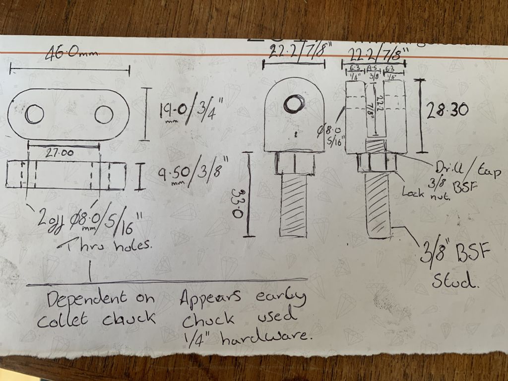

William S07/05/2021 12:54:08
avatar
80 forum posts
335 photos
Hello
I hope this is of some use: e1b424fe-dd58-4ad5-a170-ee5c8caba503.jpeg
Sorry for the crude sketch, its got all the info I think you should need! Like I said on the drawing the holes may be smaller depending on your generation of chuck as shown bellow there appears to have been at least 2 iterations of it!
Mine appears to have been welded at some point, although I think its just threaded now as I detailed above
Shows the 2 different versions
William

Lathe-argic08/05/2021 23:28:09
9 forum posts
3 photos
Thank you to everyone who is contributing. I feel well eqiuiped now. Will, the drawing you posted is a great form of reference.
