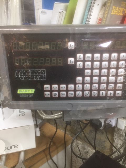

Hi, I'm setting up a 'new to me' Warco WM280V-F that came with a 2 axis DRO. I'm just starting out learning lathe work and everybody tells me a DRO on an imperial lathe like mine makes life much easier.
However I'm puzzled: X axis Longitudinal traverse (large hand wheel) is measured by the DRO but is quite coarse. The Compound rest traverse on the same X axis is much finer and would expect it to get most use for boring, turning and facing? In my ignorance I can't understand why the DRO scale would be on the Longitudinal traverse, unless it is more often used for thread cutting which I don't expect to do.
Could somebody explain how this DRO setup comes about, or do lathe users add a second axis readout for the compound traverse?

I use my topslide for screwcutting and turning short tapers, ie fairly infrequently. I have actually considered taking it off as unless it is set round a bit (which mine usually is) it is always in the way of the tailstock. More useful would be a saddle stop to limit the travel of the saddle towards the headstock, must get round to making one, but as I've managed without for 50 years it's not high on the list.

I don't have a DRO, but I wouldn't think a scale on the compound would be much use as it would only give meaningful readings if exactly parallel (or perpendicular) to the lathe bed.

It's unusual - almost impractical - to have a DRO scale on a compound since it tends to not be used much and even then only over short distances of less than 1 turn for the most part. There is also the complication of space constraints and the fact that the compound rotates meaning that you'll have to have loops of leads that are prone to snagging.
Most of your turning will be done in the X and Z axis, X being across the ways and Z being along them. There are a myriad of functions that a good DRO will provide with scales on X and Z.

DRO on the carriage travel is all you need. It's what you use for most turning and boring. Compound is usually only used for turning tapers and screwcutting. Feed on the carriage by the handwheel is fine enough for most work. And a handwheel on th eend of the leadscrew gives very fine adjustment indeed, ala Myford.

The 280 does have a very coarse apron handwheel feed that makes it hard to put on a few thou cut when say facing a job or cutting a spigot to a set length. My topslide is set parallel all the time except when cutting angles and I tend to use that to put on a cut or space out things like cylinder cooling fins along the length of the cylinder as the aprons 0.020" divisions on the handwheel together with it's action make it very hard to hit a set position.
There are some machines where the owner has hollowed out the underside of the topslide and hidden the readout inside, even new factory Myfords can have this. You then ideally want a DRO console that "sums" the carrage and topslid ereadings or you can get a unit that the two plug into and the output goes to a single socket in the consol

DRO is less use on a lathe than a milling machine, but I wouldn't be without it now I've had it. For a start it allows metric and imperial without a calculator, then when starting a job just take a skim off the bar, measure its diameter, set the X accordingly, touch the tool on the end, set Z to zero and you're done with measuring unless you're going for very good limits, even then you can get very close before stopping to measure. If you can understand the Chinglish you can tell it which tool is in use and it changes all the values to suit. As I said before I keep the topslide set over so it doesn't clash with the tailstock, so I apply Z with the saddle handwheel. On mine this works well. Perhaps someone needs to design a reduction unit for the WM250

I have DRO's on the x and y axis of my lathes, no problem moving the saddle very small amounts even on a 7.5" lathe. That one has a dial on the saddle hand wheel, I used that for lengths before fitting a DRO.
I keep the compound slide (top slide) set at 45 degrees for chamfering, occasionally moving it for screw cutting and taper turning.

You don't actually have a problem wrt DRO. The cross slide, as Duncan says, is mainly to facilitate some of the more complex processes, especially increasing depth of cut on a thread, for which setting it to 30degrees, (or 60 depending on your lathe) is ideal.

I have just bought a WM290 from Warco which has a factory fitted 2 axis DRO.
I haven’t used it in anger yet, but as Jason says, the carriage hand wheel movement is quite coarse at 0.5 mm per increment on the scale.
I am only a beginner having had a mini lathe for only a couple of years, but fitted a diy dro system to that using 4 cheap digital calipers, a homemade Arduino interface and the TouchDRO app on a tablet.
I have just ordered an extra linear scale from Warco to fit to the compound **LINK**
I am going to make a combiner similar to this one **LINK** to add the new compound scale to the existing z axis.
I suppose it depends on your level of experience and what you want to make, but I find it difficult to take accurate cuts with just the carriage hand wheel and use the compound.
