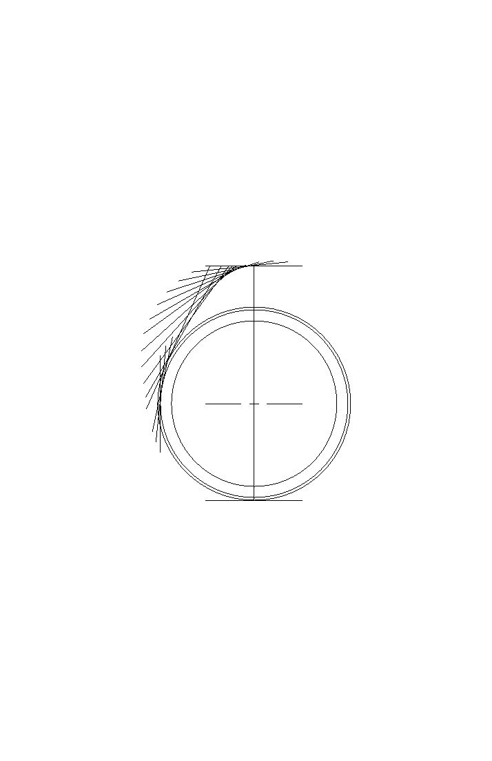

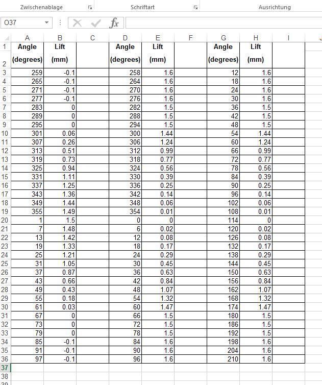

The method I use mills the cam using a series of tangents so various angles can be used. I set them out on a spread sheet with the angle and depth of cut, ticking each one off when complete. There are various programmes around for generating the steps from the cam data.
This engine was built on a minilathe using a vertical slide. I initially used an O ring to seal the piston but later made a cast iron piston ring.
**LINK**
