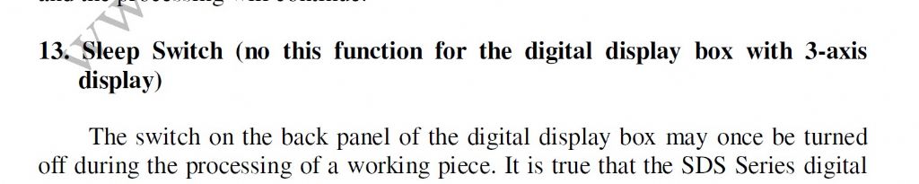

I've got a factory-fitted two axis DRO on my Warco WM18, the type that comes with the SDS6 user manual. I've been doing a bit of milling over the last few days, having not had much chance to do any lately.
I seem to recall that in the past I could switch off power to the DRO [whilst keeping the rocker switch on the back of the DRO display in the "on" position] and, if I had moved the table during the power-off time, when I powered back on the DRO would indicate the new position accurately [i.e. work like the battery powered Z-axis DRO I fitted myself at a later date]. Am I imagining this?
I ask because what is happening at the moment is that when I power off the DRO whilst x and y are both set to zero, say, when I power back on having moved the table a little during the off time in one or both axes, the DRO somewhat unhelpfully still displays zero. This makes repeat work with vice stops somewhat inconvenient because on powering on after some down time I have to edge-find all over again if I've inadvertently moved the table during the down time.
Page 13 of the manual talks about a sleep switch that sounds tantalizingly like it might alllow me to overcome this problem [i.e. get the DRO to function like a digital caliper or my battery-powered Z-axis DRO] but it's not in very intelligible English, and in spite of following the instructions [mainly concerned with the HA button] it has not helped.
However, as I say, I may just be mis-remembering how my factory-fitted DRO works.

According to my manual, the Sleep function is only available on the 3 Axis version.

In my version of the SDS6 manual, there's an ambiguous reference to the 3 axis display in the Sleep function heading.
On my 2 axis display, pressing the HA button puts the display to sleep, while the unit remains switched on and continues to calculate x and y axis positions. Pressing HA again turns on the display.
I think that the section heading may be intended to say that the sleep function is not available on the 3 axis display but cannot confirm if this is so.
Gordon

According to my manual, the Sleep function is NOT APPLICABLE TO the 3 Axis version.
Just been to the workshop (BRR) and tried my 2 axis DRO on the milling machine
The DRO must be in INC mode, pressing HA puts it to sleep mode and the displays go blank as if powered down but still tracks any axis movements which are displayed when HA is pressed again. But if the DRO is switched off either by the rear switch or wall socket any axis movement is not stored.

Many thanks to everyone for your helpful replies; they've cleared things up considerably, and helped me to see firstly that it was my own memory that was at fault, and secondly that I can at least get the DRO to keep a record of table movements whilst having a blank screen even though I have to compromise by keeping the power on. If I'm not prepared to compromise and do want the power off, I can always follow Clive's advice and apply table locks between sessions.
If I could guarantee I'd be able to finish batch work in one session or at least one day, it's likely my "problem" would never have appeared to be a problem, but circumstances tend to call me away without much warning at the moment, often without the possibility of going back any time soon.
I see the critical bit I misinterpreted in the manual's instructions on page 13 was "In not ALE [my underlining] working state, if there [sic] a need of Sleep Switch Off, key HA, the digital display box will turn off the display."
Thanks to your help, and Ian's input specifically here, I see I should have interpreted "in not ALE working state" as "in the INC working state or one of the 200 other modes where you can establish separate reference readings". I'm almost certain what the Chinese will have said for "in not ALE working state"; if I'm right, the instruction would have been both idiomatic [where the English isn't] and much more readily intelligible.

Just to back up my previous post, here's the relevant section heading, from my manual:-
I've just tested this (to make sure I wasn't mistaken) on my 3 Axis display and the HA Sleep function does work.
This section also has  "In not ALE working state", so to use sleep, the unit must be in INC ( the HA button is disabled in ALE), as suggested in a previous post.
