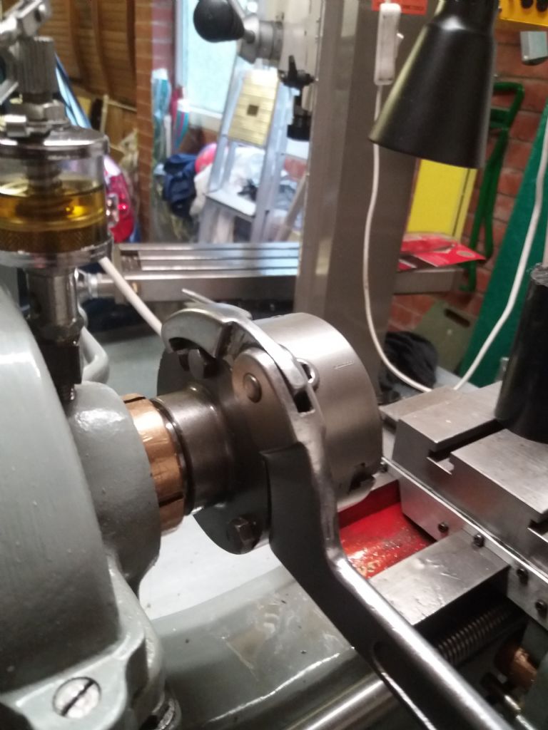

avatar
1602 forum posts
I remove the chucks by engaging back gear and putting a large adjustable spanner on the sides of one of the jaws. A bit of pressure releases them.

Pete Rimmer10/11/2020 18:48:46
1486 forum posts
105 photos
Posted by Dr_GMJN on 10/11/2020 14:57:44:
You risk shearing teeth off the back gear. Many have been wrecked doing this.

Posted by Pete Rimmer on 10/11/2020 18:48:46:
So what's the best way of locking the spindle?
David George 110/11/2020 21:03:50
avatar
2110 forum posts
565 photos
On my M Type I have a notch and use a C spanner to unscrew the chucks. Just put on C spanner put a hand on the pulley and give the C spanner a tap with a No 0 copper hide mallet don't lock the back gear and don't disturbed the chuck alignment. As supplied by Myford.

Dr_GMJN10/11/2020 21:30:36
avatar
1602 forum posts
My ML7 also has a 100mm chuck, and appears to be standard from what I can tell from the manual.
I have no way of using a c-spanner to lock the spindle. As far as I can see the only practical method is to engage a gear. I don’t need to apply a shock load, slight pressure on the long adjustable spanner always breaks it loose with not much effort. I never felt I was applying enough load to strip a gear.
