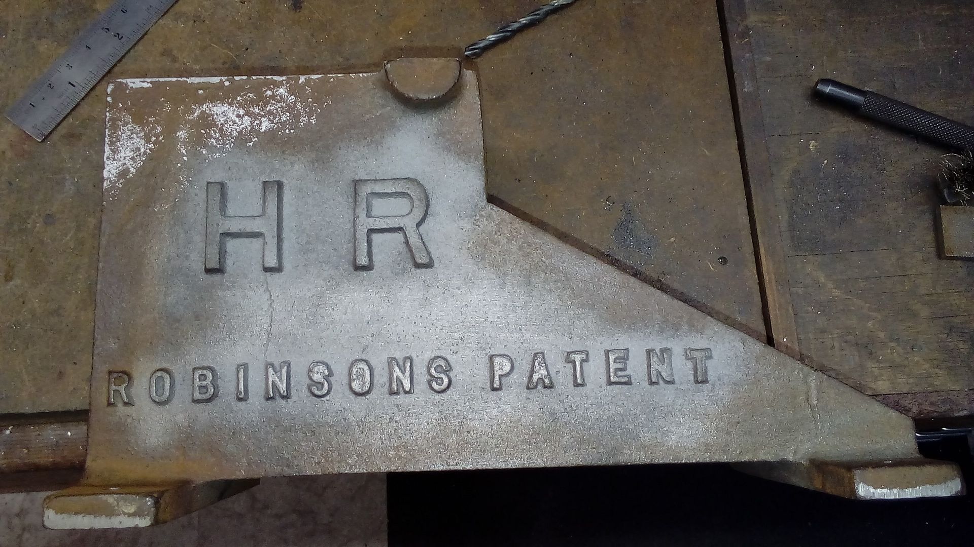

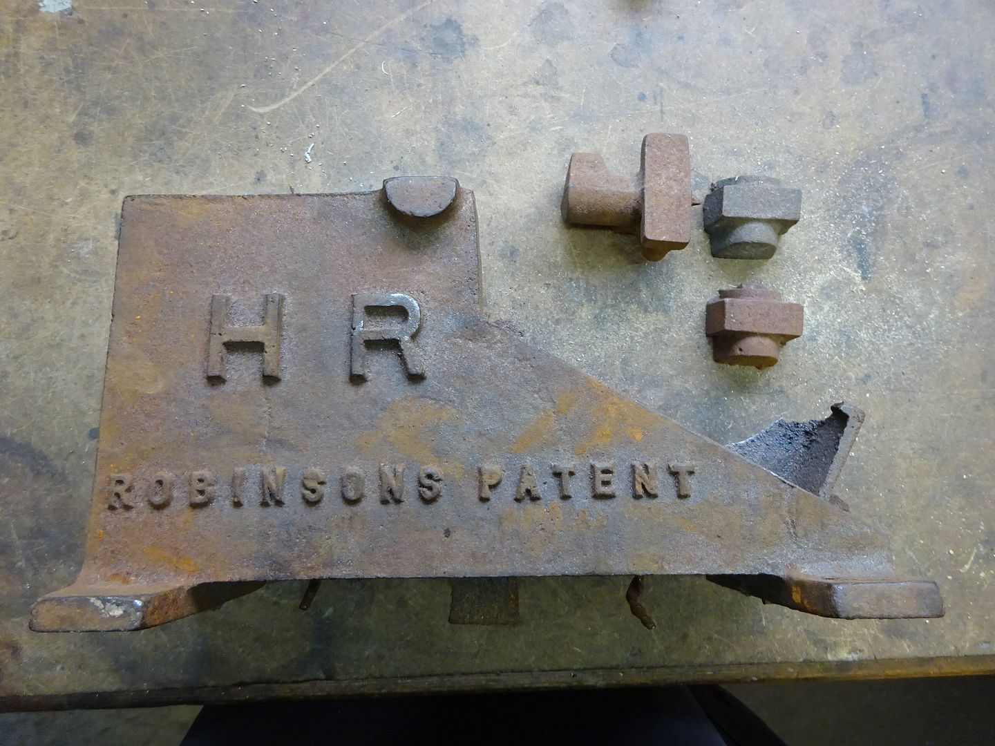

I suppose it depends what you call "small scale" sand blasting. This casting is about 9" long
After a couple of mins with a very basic Lidl blaster powered by a 5CFM input compressor with 12lts tank. I'd call that small scale and OK for the odd old model casting or small fabrication.
Taking your model that has a displacement of 0.245lts so ticking over at say 60rpm and a few psi will need 14lts or half a cubic foot. I did find some output figures for these compressors but only the single motor ones and they give an output of 95lts/min @ 1bar and 70lts/min at 4bar so hopefully the 14lts engine will be OK unless under high loadings.
