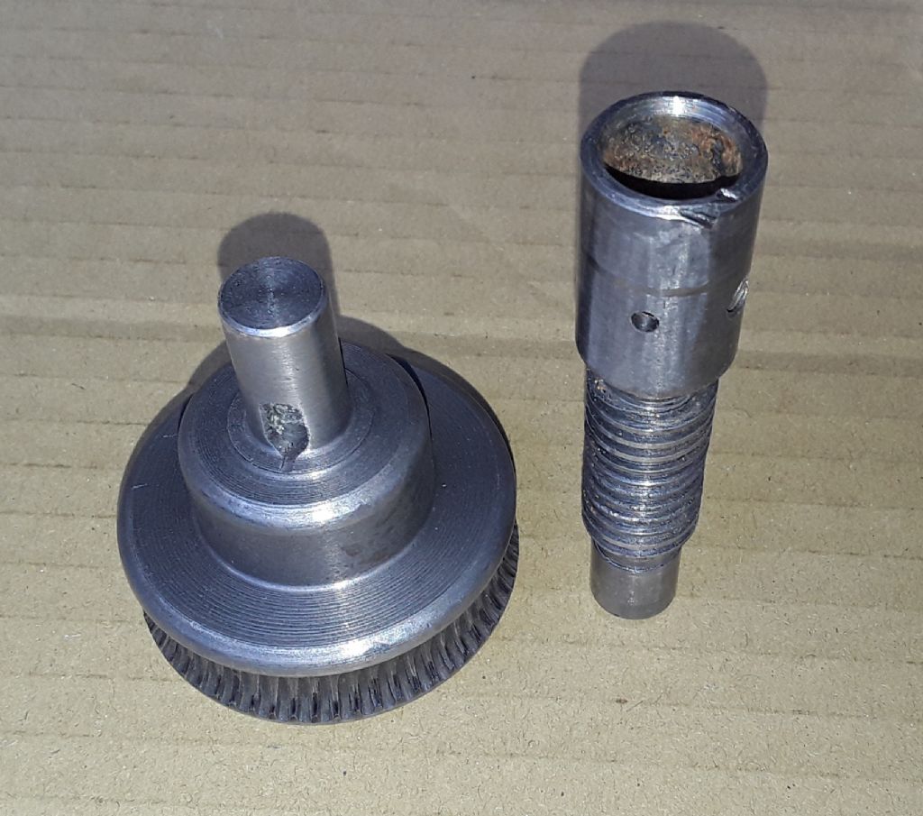

Hopefully somebody can assist with this issue, my AEW Viceroy milling machine has a stripped worm wheel in the bed feed gearbox (it was like this when I bought it).
The worm coming from the motor is not too bad but i think its best to replace both, the 2.1/8" od 60DP wheel has totally stripped its self and need replacing.
Does anybody know of a company who do one off gear work and could make me replacements whch wont break the bank!!

60DP is very fine for a machine feed of that era. Could you put up some pictures of the offending part Ian.

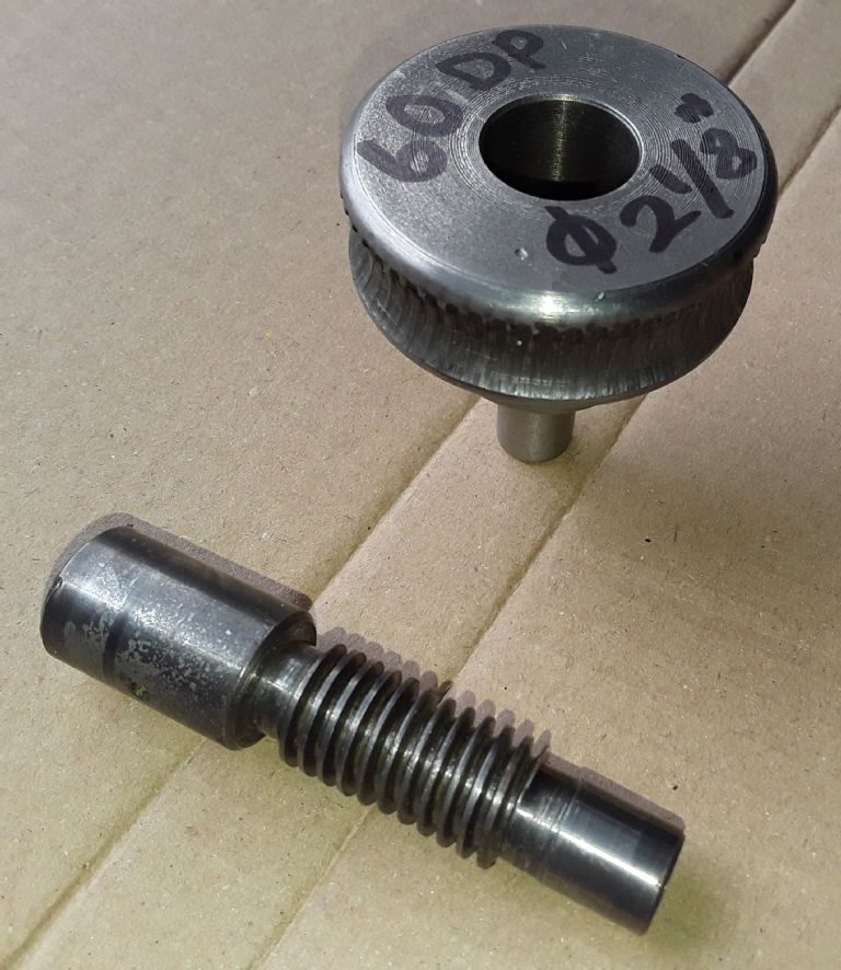

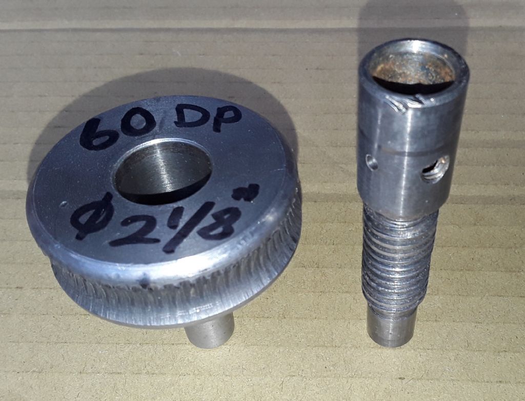

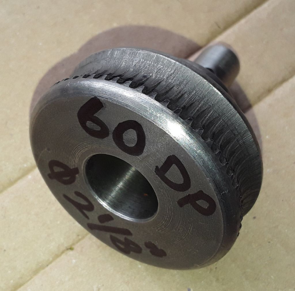

Thanks for all the contacts i will follow these up and hopefully get something sorted out, just posted a couple of photos to show the damaged gear wheel, this was done years ago i would think and the worm wheel also had the drive key removed and a shear pin installed instead, presumably to act as a safety feature.
I have been through several gear catalogues but cant find anything close to the old one so asume its a special gear made for the machine by AEW.
I thought of turning off the old gear and pressing on a blank replacement gear bored out to fit over the boss, saving all the work involved and keeping the cost down.

Sorry, Ian ... but I struggle to see that as 60 DP

If that gear was 60DP it would have around about 125 teeth. Looks like it has about half that.
What is the pitch of the worm Ian? And the diameter?

The usual formula for calculating spur gears is OD = (Number of teeth +2 ) / DP. This will be more difficult with a form wormwheel, but a wheel of 2.125" diameter with 60 DP would have very fine teeth.
Could it be that the worm is single start and the wormwheel has 60 teeth?
This would provide a non reversible drive (needed for the feed on a heavy knee ) and fine adjustment.
Although, if an Imperial machine, I would have expected 50 or 100 teeth to make the graduations on the handwheel to be 0.001" or 0.002" with a 10 tpi leadscrew.
Counting the teeth on the wormwheel may shed some more light on your needs.

Counting the teeth on the worm wheel over a quarter of the circumference implies that the worm wheel has about 60 teeth. Given that the OD of the worm wheel is 2.125" OD the length of the worm look to be about half that. I think the worm is single start. It has 11 threads so the pitch of the thread is about 0.1". That implies that the DP of the worm wheel is about 30, not 60. If one of the parts has an integer DP or thread pitch then the mating part will be irrational. It's common to make the worm wheel be an integer DP value so the worm thread has an irrational pitch.
If I twiddle with the change gears my lathe will screwcut a worm with a range of DP threads including 28 and 32, but not 30.
