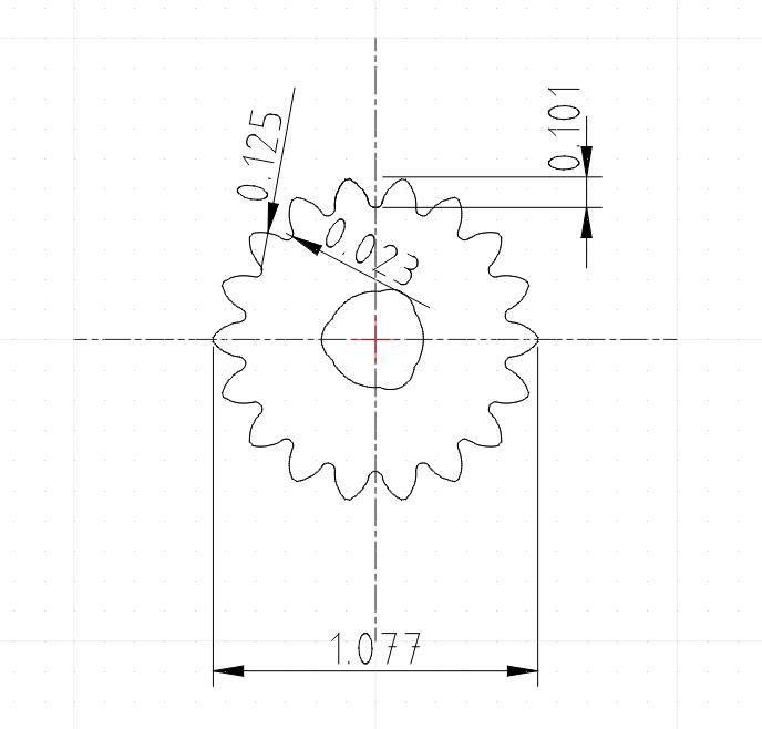

Where can I get hold of meccano chain wheel drawings in .dxf format ?

If you have CAD then you could draw them up from this

Yes everything is on the drawing *, the only thing I had to make a call on was whether the 0.015" was a straight line between where the two arcs meet the OD or if it were the length of the small arc, though it would not make much difference on such a small dimension. I did learn a little as it made me think how best to draw it and did use one option that I don't use often. I'm just waiting for Dave's pencil drawn on nowsmile p
I learned from this one too. My attempt in Qcad:
It's wrong! Right at the beginning I misplaced the tooth valley by centring its radius on the pitch radius circle, which is not what Meccano Ltd drew.

Here's mine in MoI.

Started drawing my version - thing I can't work out is how to establish the centre for the 0.125inch radius? The valley and 'flat' on the tooth I can work out, but finding the centre is defeating me!

I did not find it but could measure from my drawing. I drew a 0.250dia circle and made it tangental to the 0.046" one for the valley and then also made it pass through (coincident) one end of the 0.015" arc.
