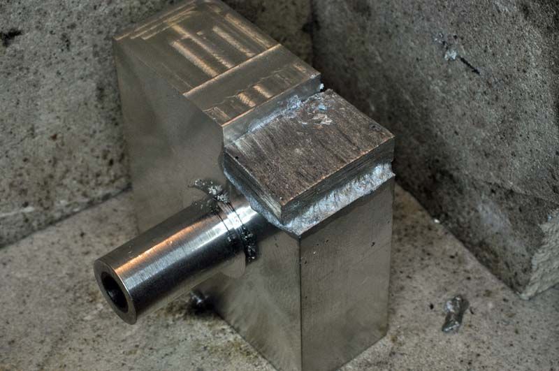

Roderick Jenkins06/09/2020 22:05:09
avatar
2376 forum posts
800 photos
I used HTS2000 for this:
HTH,
Rod
