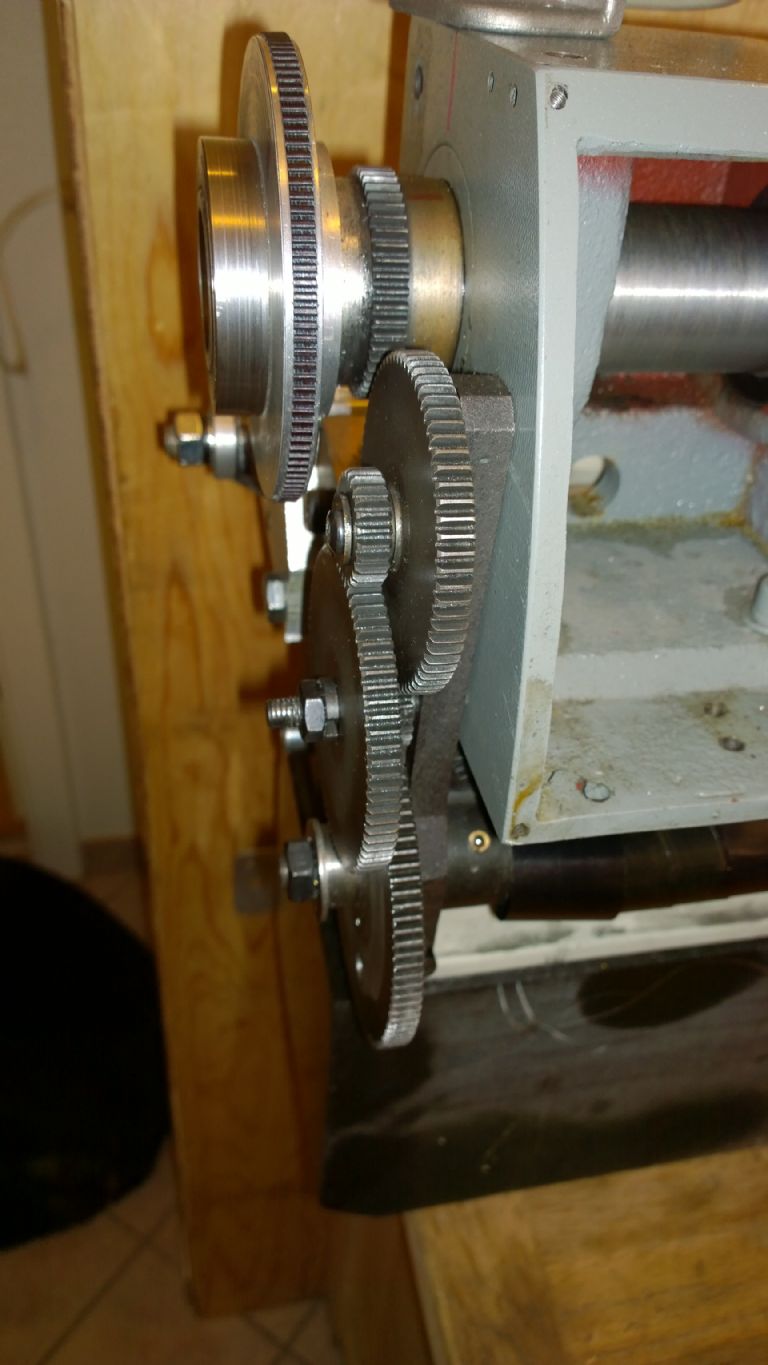

Hi all I have just recently purchased a Warco WM180 lathe. The machine runs very well however the fine feed selection gear wheels run very noisy. Over greasing them would possibly cause belt slippage to the motor drive. I am open to ideas from anyone who has experienced of this problem.

The noise may be caused by incorrect meshing of the gears. Too little backlash will cause noise and premature wear. Too much backlash will cause noise and an inconsistent feed rate.
The gears should be meshed with a piece of card or paper between them, about 0.003" (0.075 mm ) thick to set the correct amount of backlash.  Obviously, remove once the meshing has been set.

Um, metal change gears are noisy so could be normal.
However, the amount of meshing between teeth can make a big difference. I set each gear apart on the banjo with strip of thick paper (or a strip of ordinary A4 printer paper doubled over). Setting the gears too close makes grinding noises and having them too far apart causes banging and rattling. A mixture of too close and too far apart on the same train is the worst combination. Too close can cause problems if a pair of gears aren't quite circular because they can cam together at certain points, adding to the racket and stressing the teeth. Experiment with different thicknesses of paper.

.. 'The gears should be meshed with a piece of card or paper between them, about 0.003" (0.075 mm ) thick to set the correct amount of backlash. Obviously, remove once the meshing has been set'...
+1 for all comments. I've set my backlash as above with a piece of A4 paper, doubled over, for each gear on the banjo... as for lubricating the gears I use motor bike chain oil...

As well as correct meshing close attention should be paid to the washers that fit between banjo and gear as they are different thicknesses, if you get them wrong the sides of the gears can rub giving a ringing sound. Thin washer should go against a large gear and thick washer against a small one.

I find it easiest to adjust the gears on the banjo first starting by the last gear on the train. Using the paper method is good but too fiddly so I just make sure there is some backlash by eye and feel, you will soon get used to it after spending some time on it. As Jason mentioned above pay attention to the side clearance as well, apart from the washers, moving the banjo in and out will also effect this clearance.

Wm180 change gears further to my post I as advised contacted You- Engraving .com. He supplied all the gears required in Delrin at a fair price a few spares. My lathe is now running a lot noise free therefore no more infernal din from the metal gears supplied by Warco. I have have no connection with company only a satisfied customer.
