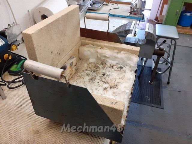

mechman4826/07/2020 11:28:09
avatar
2947 forum posts
468 photos
I bought some vermiculite blocks from eBay some time ago, & a blanket from CupAlloy's when last at Doncaster show & made myself a small hearth. I'd already made the metal frame some years ago but was using the firebricks from a coal fire which didn't reflect heat too well. What I have now is much better.
George.
p.s. Usual disclaimer applies.
Edited By mechman48 on 26/07/2020 11:29:29

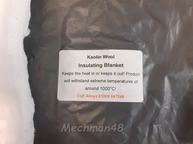

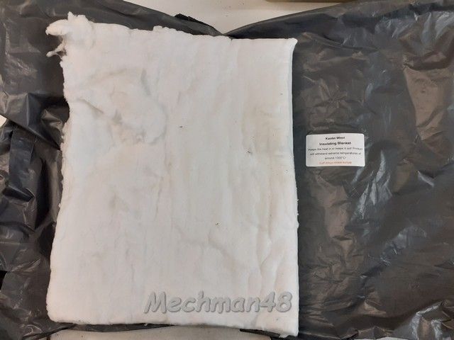

Neil Wyatt26/07/2020 11:34:15
avatar
19226 forum posts
749 photos
86 articles
Hi George,
Could you take a picture of the blanket?
mechman4826/07/2020 11:38:34
avatar
2947 forum posts
468 photos
Posted by Neil Wyatt on 26/07/2020 11:34:15:
Hi George,
Sure', I'll be in the cave later on today; hopefully.. will post when done.
G.

mechman4826/07/2020 14:27:45
avatar
2947 forum posts
468 photos
Posted by mechman48 on 26/07/2020 11:38:34:
Hi George,
G.
As said pics...
Usual disclaimer applies...
George.
Neil Wyatt26/07/2020 19:04:42
avatar
19226 forum posts
749 photos
86 articles
Thanks George, I've actually got some of that stuff and the blocks too.
I used the wool to insulate under my 3D printers bed. I didn't realise it would stand up to silver soldering.
IanT26/07/2020 23:10:42
2147 forum posts
222 photos
I use the same Kaolin blanket - and it is possible (actually quite easy) to heat it to the point where it becomes powdery and very friable. Apparently the resultant powder/dust is not at all good for you. There was a thread that mentioned this hazard a few months ago - but I cannot find it at the moment.
Anyway - I'm a bit more cautious in my handling of it these days and wear a mask & gloves to move or rearrange any 'used' blanket - with any badly burnt/fused bits getting bagged and binned rather than re-used - e.g. the blanket is viewed very much as a consumable.
Regards,
IanT
