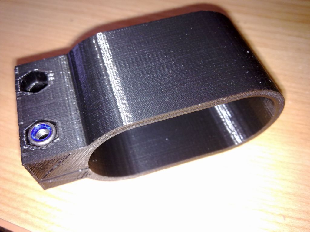

If you ever need to make the nuts snug in a part so they don't fall out during assembly, a tiny tapered spike printed up 3 of the hex pocket walls, interfering with the nut by a few thou, works OK
Very early days for me with 3D part design (FreeCad), but the first part I came up with had an M8 hexagonal recess for a nut.
The recess was specified as 8mm AF and the nut is a firm press fit without any "fudging" requirements - was I just lucky ? If this post is an an inappropriate place, please remove / relocate.

@Jeff the little spikes idea is a good one. I've devised a few different clips and joiners, and I use a lot of thread direct in the print, just tapping a thick walled print for small threads and M6 up printing them direct. The spider is secure as a clip on fit, the base with the mirror is heavier so had four tapped holes for M4 screws through the tube, just in case. I once printed a cubical maze, with a captive 10mm ball bearing inside.
