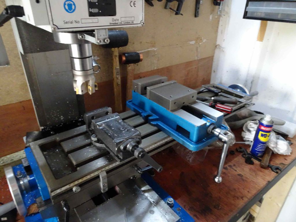

So I boasted of my new vice on the 'What did you do today' thread and Jason suggested I start a separate thread so as not to get swamped by the flood of advice..
Or something
I've put the keys in and they fit most precisely into the T slot and the base of the vice, however the face of the vice is out by around 0.1mm across the width.
Henry has skimmed the base of his and I gather Jason has been waving his magic engineers wand at his as well, so there are clearly things that can be done.
The responses (and a good night's sleep) have suggested that I should clock the various other faces to make sure that I'm addressing the right problem in the right place.
Looking forward to answers and opinions.

Opinion: That vise looks far too big for that mill in that orientation, to me, unless bolted down on the outside table slot.
Fact: My large vise just overhangs the rear of the table and preliminary setting up usually means simply touching the back of the vise, in full contact, against the column.
Opinion: You are not doing very well if squaring the vise is only to the nearest 0.1mm!
Choice: The swivel base is sort of OK - if you have plenty of head space which, for most of us, is at a premium. The intermediate ‘layer’ is bound to cause further levelling/alignment errors unless everything is absolutely spot on.
Suggestion: You start your measurements at the table surface.

Stevie, there is a channel in the bottom of the vice which holds keys which slot into the t slots - a close fit. If all is working right, it just means that you pop the vice on the table in the slots, tighten up the t clamps and it's spot on.
not done it yet, I think it worth checking the surfaces from the table as well as the spindle, so thanks for that idea. I *think* that I can mill across the full opening of the jaws in this orientation, though I will double check that.

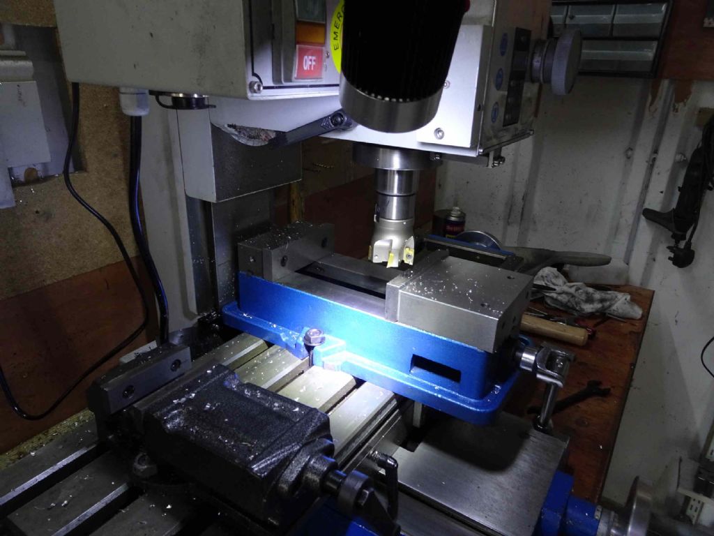

Well I was going to save this for MEW when I did a "pimp my SX2.7" article but you can have it for free.

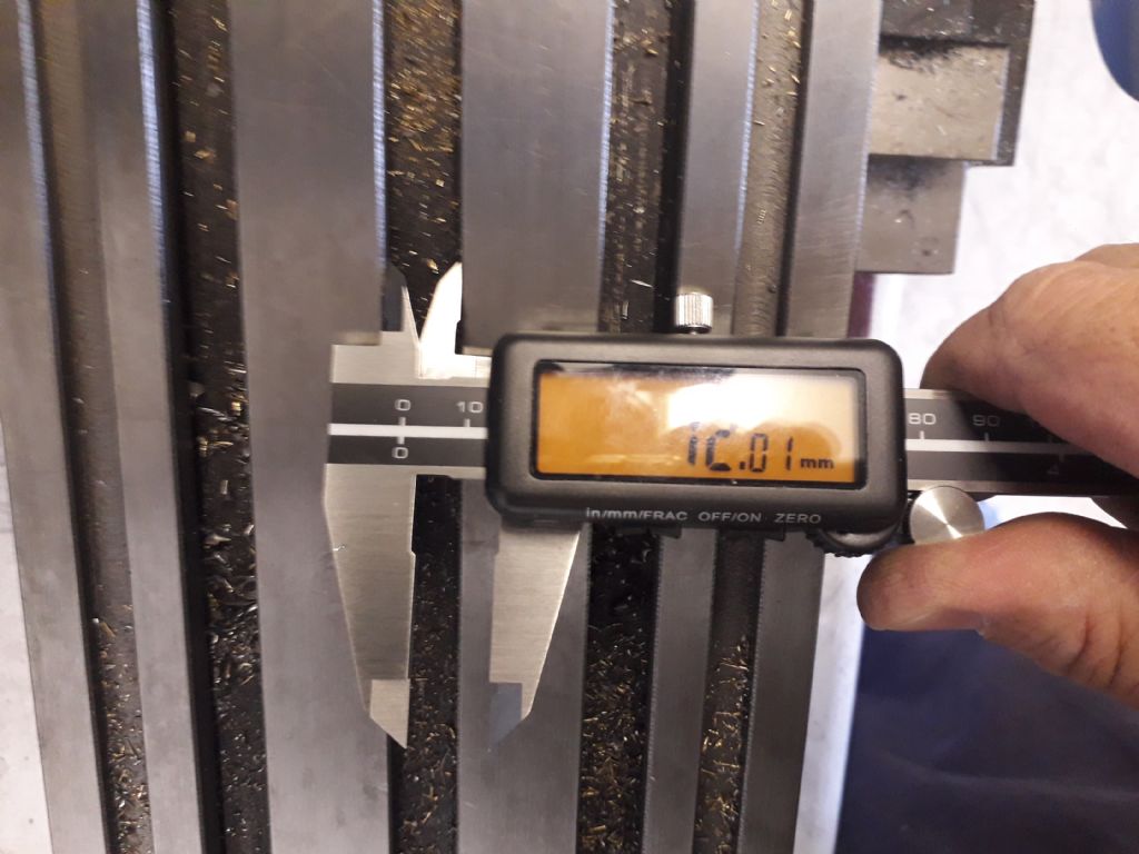

Firstly The reason for doing this work was that the slot in the 80mm vice is a nominal 14mm along with the supplied blocks but the SX2.7 has 12mm nominal tee slots
Secondly I generally prefer to clock my fixed jaw rather than use the keys but it made it simple of when staging photos for the beginners series to have the keys fitted.
Firstly a check of the supplied blocks shows them to measure just under 14mm and they are a firm fit into the premachined slots in the bottom of the vice not falling out when you turn it over.
Slot in the table a nat's over 12mm measured in several places.

Set your chosen milling cutter height so it is just clear of the bottom of the vice

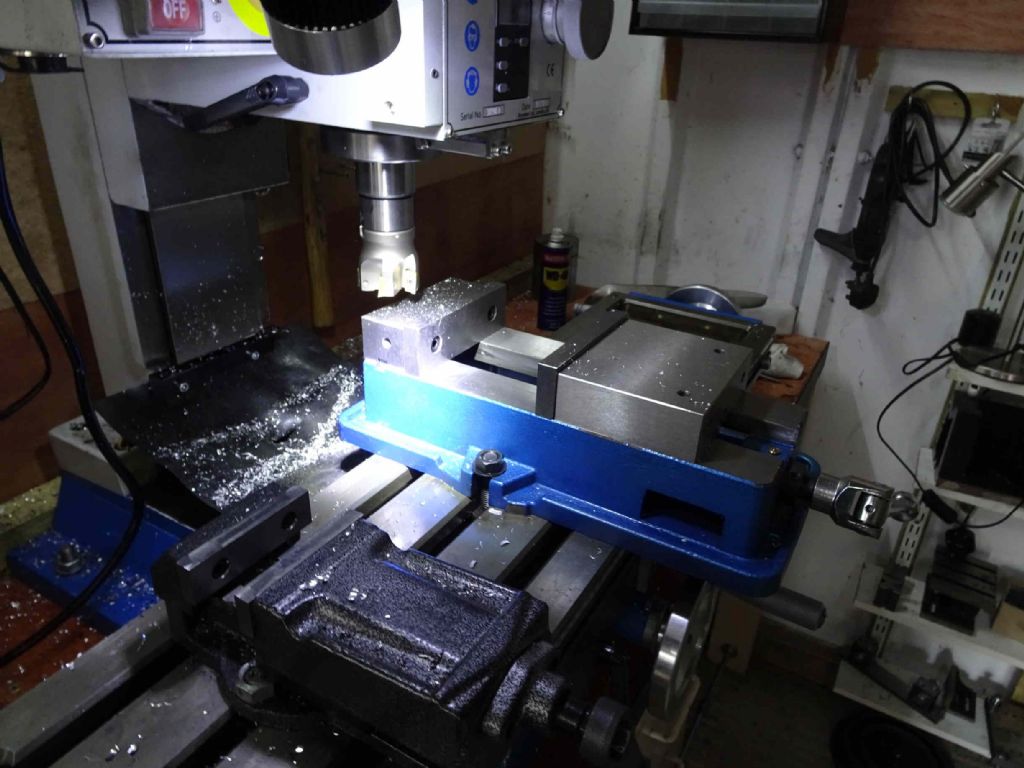

Then machine the blocks to size taking a bit off each side, I went for 0.05mm under slot avarage so that I could also use on the other mills and the bit of wiggle room would allow for any fine clocking should I need it for high accuracy jobs.
Ian, you would only need to skim one side which I suggest if the fixed jaw side
Job done. I have actually been using this vice on all three mills particularly the CNC and locating it simply by pushing it back against the rear edge of the middle slot as I tighten up the fixings and not had any issues (no other work done to the vice either)
0.01mm over the length of the jaws, good enough for most work and clockable when you feel the need for anything better.

Firstly, not done it yet thought the vice was too big. It is a beast but ...
You can mill across the whole span of the vice from full in
To fully out
So I'm happy that I've not gone mad from that perspective. True with the jaws in their alternative positions you can get to the rearmost, but are way short of the frontmost. Still it looks like I could hold an 8 inch wide piece and cover the entire surface.
