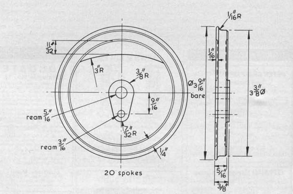

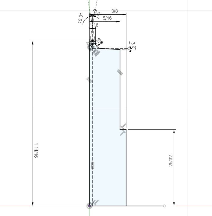

Hello everyone!
As I continue with 3D modeling Martin Evans Eagle, I have come across another feature I do not understand. I don't understand when the wheel flanges will start to cut into the side and make the 10 degrees angle that is set by the N25GA. If anyone could explain to me geometrically where the angles of the flanges and threads start and end that would be great! Thank you very much!
Noah
Noah Partida30/04/2020 08:21:40
5 forum posts
4 photos
Original drawingWheel Cad DrawingZoomed in Wheel Cad Drawing

I'd think there's risk of overinterpreting the drawing to a level of precision not achievable outside an instrumentation lab.

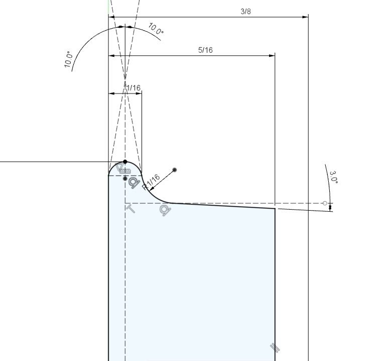

The flange edge radius isn't specified because it's supposed to be derived from the 1/16" flange thickness at an arc where a 10 degree tangent each side touches the radius. In practice it'll be a bit over a 1/32" rad - I think I could probably work it out if I put the time into it. A more considerate draughtsman would have calculated the nominal value of that rad and put it on the drawing as a 'reference' dimension.
Then the specified 1/16" rad runs from the 10 degree tangent down to a tangent on the 3 degree taper. It would be best to blend that transition as smoothly as possible. Absence of a step is *probably* more important than the precise value of the radius, or the taper.
But hey - I know drawings better than I really know railway wheels. There will be people here who know far more.

The 1/16 radius at the root of the flange is important, as that is what centralises the wheelset on the track.
The tread does not have to be tapered - a parallel tread will work equally well, possibly better,
The radius at the tip of the flange is not critical, on wheels of this size it is mainly cosmetic and can be formed freehand with a file.

It looks like you've drawn it properly.
As long as you have used the 10 deg lines to trim the 1/16" diameter 'arc' and then constructed the 1/16" radius tangential to it, then it should work out OK. From there, a tangential line at 3 deg confirms the profile.
Actually, the 10 deg line that intersects with the inner face of the wheel appears fairly pointless to me, as if you use it to trim the 1/16" diameter 'arc', you get a tiny flat/chamfer of a transition instead of a nice smooth blend.
Martin.

Contrary to Roger Best's post, there is a geometric relationship between the various arcs and lines but it is not clearly shown on the drawing. It can be worked out if you really want to be that accurate, but in my experience it is not really necessary as long as the critical dimensions (effective wheel diameter, effective width and depth of flange, and root radius) are close to the specified values.
IMO the best way to go about it would be to first face off each side of the casting to give you the overall thickness. Then turn a flat tread of 3-3/8" diameter ending in a square flange 1/8" thick and 3/32" deep to give the 3-9/16" overall diameter. Then reduce the flange thickness to 1/16" while forming the 1/16" radius at the root of the flange. Next, using a form tool and files (or just files) form the 1/32" flange radius and blend it into the root radius. Lastly turn the 3deg taper on the tread.
If you really want the accuracy of the given dimensions then I can mark up a drawing showing the relationships, but you would be hard-pressed to meet them exactly for all wheels unless you made a form tool having that compound shape.

Major league overthinking about the drawing forgetting its something that you just make, mosly by eye on unsophisticated machinery.
Start with a flat flange and wheel the right thickness and diameter. Use a concave tool to put the 1/16 radius on the wheel side of the flange. Probably end up with a thou or so undercut on the top but that is too small to worry about.
Use a convex 1/16 radius tool to cut the wheel taper stopping when the two radii blend. Again probably have a wisker of over or undercut. Polish it out and be happy.
Flip the wheel and put the radii on the back.
Do the rest.
With the right technique the theoretical drawing tricky stuff just falls out.
I wouldn't do it that way, heck I wouldn't build a loco anyway, but I have the gear to set up effectively the same thing by measurement and stops. But its still just a matter of relative tool cutting edge offsets and cut depths. Not circular geometry.

I used TC's SMEE dimensions to work out the distance from a roller held in the flange/tread join to the inside face, then using a tool with correct tip radius and approach angle machine along the tread angle to get the correct flange thickness, then round off the top of the flange with a file (that is the least important dimension). I used brazed carbide tool as if you don't have to sharpen it between wheels it makes getting them all the same size a lot easier
I've got it on CAD somewhere for 5"g. Send me a pm if you want a copy

The Model Engineers Handbook has arrived, very interesting it is too, with all sorts of stuff.
Page 13dot16 refers, specifying the radius position and tabulating the various dimensions. Unfortunately they differ to the diagram above in some dimensions but the principle of positioning the radius tool centre on the diameter point, and a specified distance from the back face is there.
The specified flange radius is only 0.030", so 1/32, and the angle 20degrees, so much less rounded than Noah's drawings. More to scale I expect.
