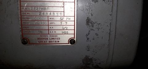

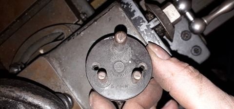

I have just bought a Myford ML7 Lathe but the motor has a problem which causes it to constantly blow the 5A fuse.
I reattached most of the wiring as some was in bad condition but this didn't fix it, as a last resort I tried using a 13A fuse and using this the motor seems to work fine.
The original plug it came with was very old with round pins and no fuse inside.
I presume using the 13A fuse is potentially very dangerous though, what do people think?

Martin of Wick24/03/2020 10:40:48
258 forum posts
11 photos
Hmm, your plate says 3.7 A
so assuming start up current can be up to 3 times that....
Dangerous not to use a fuse, but 13A will be fine, but if that blows regularly too, then you may have a problem.
If it runs smoothly and nothing appears to get too hot then you are good to go.

It puzzles me that the original plug says 5A on it, can anyone offer an explanation?
In the olden days they were two sizes of plug the one shown in your pic rated at 5A then there was a larger version of that type of round plug rated at 15A, then with the coming of the ring main 13A became the standard .

SillyOldDuffer24/03/2020 16:02:50
10668 forum posts
2415 photos
Posted by James Hemmingham on 24/03/2020 14:34:31:.
The round-pin style came in 4 different sizes: 2A, 5A, 15A and 30A.
Before square pin plugs and sockets, UK domestic wiring was wired on a spur system where each socket connected back to a separate fuse. Spurs could be of different current capacities and to stop people burning the house down different sized plugs were used to make sure a 2A device couldn't be plugged into a 30A spur, or a 30A device into a 15A spur. No need for round-pin plugs to contain a fuse because there was one in the fuse box.
The spur system was fine when people only needed a few sockets, but it's inconvenient in a modern home.
In 1947 the system changed to wire houses with ring mains rather than spurs. A ring main can have many sockets connected to it, which suits modern needs. Although the main is protected by a single big fuse, each appliance needs to have a fused plug. All square-pin plugs are the same physical size, but they can be fitted with different fuses as necessary to suit the appliance. I have 1A, 2A, 3A, 5A, 7A and 13A examples, but 3 and 13A are the most common.
A 13A plug and fuse would be OK for a Myford.
