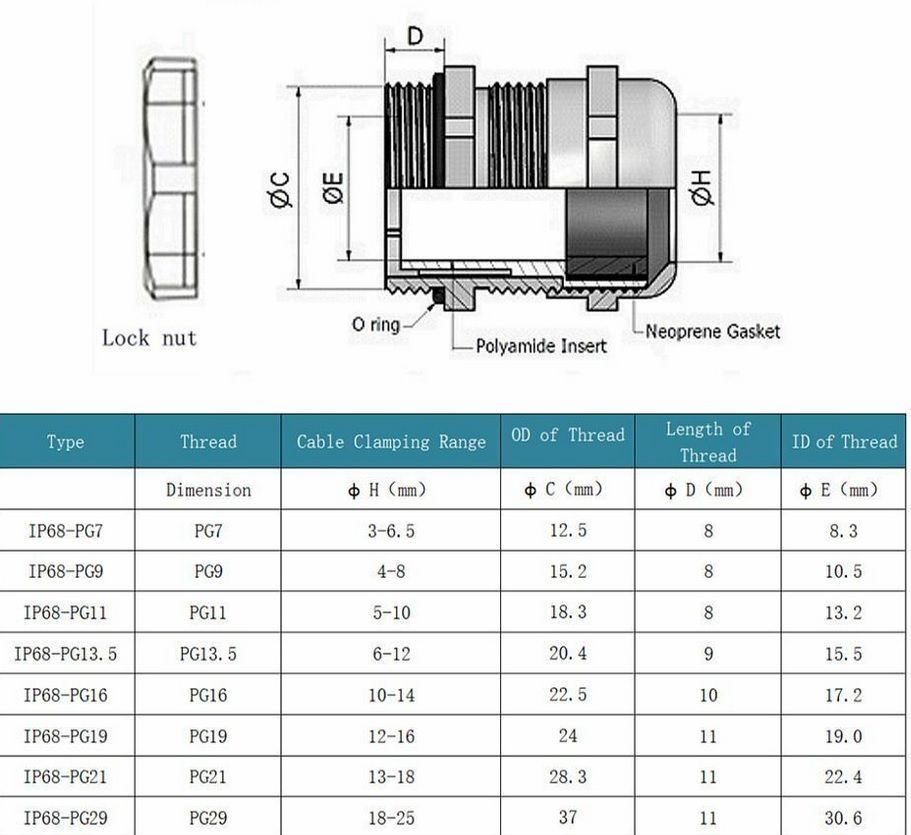

Hi Guys
I’ve got some 1.5mm twin multi strand cable, there is no earth wire with it and the outside diameter of the sheath is 7mm.
I need to run it through some 6mm thick steel and Iv'e been having a look at the glands in the image.
Namely the IP68-PG9, the only trouble is by the time the locking nut is screwed on there won’t be enough thread distance to accommodate 6mm, see measurement D, it's only 8mm to start with.
Question: Does anyone have any ideas what could be used??
Thanks to anyone who can help
Clive

Tap the steel plate to suit the gland thread.
You may be better off with a M16x1.5 threaded gland, probably enough length for your plate thickness.
Emgee

RS Components has 25 PG9 to choose from ... you may hit lucky
**LINK**
https://uk.rs-online.com/web/c/cables-wires/cable-glands-strain-relief-grommets/cable-glands/?searchTerm=cable%20gland&applied-dimensions=4294880905,4293395760
Alternatively; could you tap the panel ?
... or even counterbore it ?

Cable glands with a long thread are available.

Have a look at the double barrier range of glands (usually in Brass) they have a min 15mm thread as 5mm is required to be in contact due to the their application

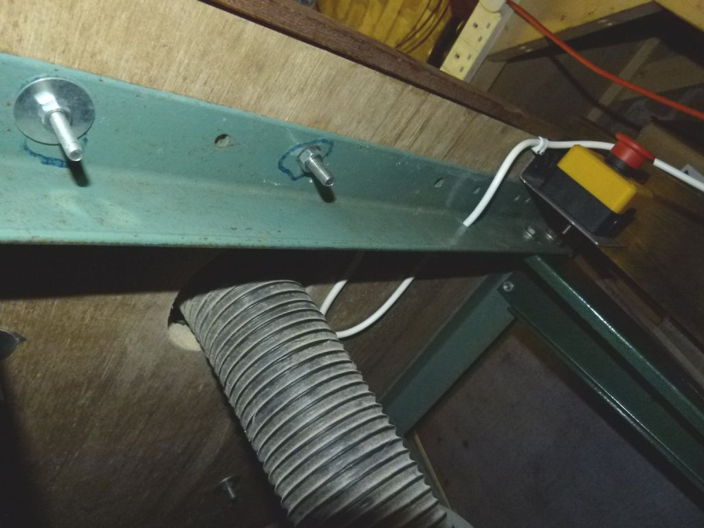

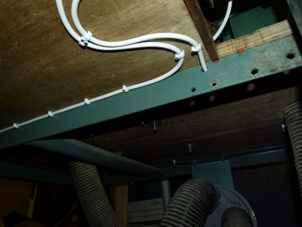

Clive B 121/02/2020 19:43:00
110 forum posts
76 photos
Hi Guys
Thank you for your comments, Emgee / Michael Gilligan I’m doing all of this with a hand held drill so counter boring is out of the question.
I would imagine a tap the size of a gland thread would cost an arm and a leg, but I do appreciate your comments.
Clive India I think you may have just cracked it for me I will certainly be checking into using one of those glands, I can always file the holes out in the angle iron.
You can see from my photo what I’m trying to do, I guess I should have posted a picture in the first place, my apologises.
You can see in the photo how the cable passes through the 50mm x 50mm x 6mm angle iron, which it also does in another couple of places.
Having said that there’s absolutely no way I would leave the cable like that even though its clipped to the underside of the table.
I reckon with the machines running the emergency stop cables will chaff through in no time flat, it will be hard work filling the holes out to suit the glands given the position they are in, but for my own safety they can’t be left as they are.
Thanks once again
Clive

Also when you used a grommet the grooves in them are only wide enough to accomodate thin metal, typical thickness of whats used for eletrical boxes which are sunk into plastered walls, my angle iron is 6mm thick.

Cut a groove in the wood and take the cable over the top of the angle iron, no gland needed.

Based on what I can determine from your text and pictures I would say that the type of cable and its installation are unsuitable, (if this is some sort of machinery).
If the cable is carrying mains voltage then it should really be three core (with an earth wire)
If the purpose of the gland is just to stop movement between the cable and the hole then the ones you showed originally are overkill. They are good for sealing and clamping the cable but provide no bend/strain support if the cable is flex and being moved frequently (that type of PVC cable would not last long in an industrial environment)
Routing the cable through a hole in the steelwork seems pointless, Going over rather than through the obstruction would only add a few extra cm of cable.
If the reason for not going over the edge of the metal angle is to prevent the cable being damaged by accidental trapping or being impacted, then it should be protected by a rigid cover or trunking. If there is a possibility of the cable passing over the a metal rib being damaged then I would surmise that even the less projecting wiring is vulnerable too.
Most of the above is just speculation without having more information on the application but its something that might be worth bearing in mind.

I can see why you don't like the cable going through a bare hole, although if everything is properly secured it probably won't matter. Rerouting the cable across or around the angle iron would look even more like a bodge. A screwed gland is massive overkill even if you already had a suitable part. Grommets are used to good effect in much thinner sheetmetal, and will work here. Or you could glue/cabletie a short piece of thick hose(6mm fuel hose would be a good start) over the cable where it passes through the hole.
old mart22/02/2020 15:02:12
4655 forum posts
304 photos
Nicholas Wheeler's suggestion of the hose would work best. Don't forget, you are weakening the steel by drilling large holes in it.

The reason I don’t like the idea of going through a bare hole in the steel is because even though the cable will be clipped, having machinery running above could/will cause vibration and the cable could chaff, better to be safe than sorry.
When you think about it why are rubber grommets fitted in steel boxes for house wiring. When they are plastered into a wall there is absolutely no way the cable will move once its plastered in, although I grant you the metal of the switch boxes in a house application is much thinner.
