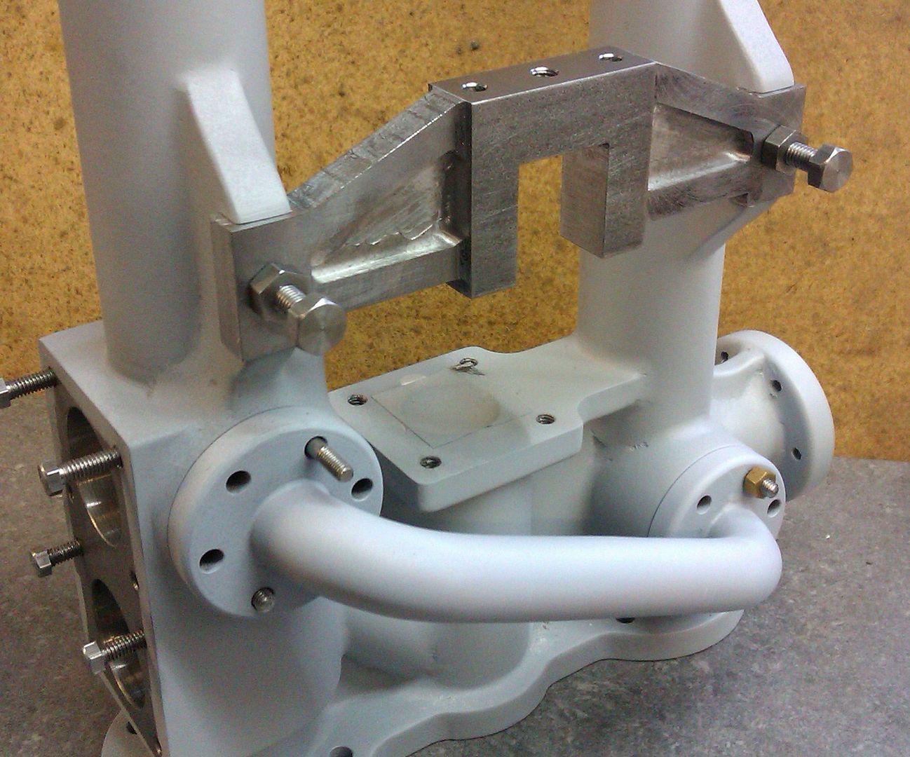

For the Stuart the bends are a lot tighter than most commercial benders can go down to. For similar plumbing I have used various end feed plumbing fittings that can be cut down and silver soldered to straight lengths, things like street elbows, full and half crossovers are the most useful.6, 8, 10, 12, 15mm etc.
Another option is to make the bend from solid with a couple of well positioned holes drilled with a ball nose milling cutter and again solder the pipe on before shaping the external profile, this is 6mm OD with a 2mm internal "bending" radius.
