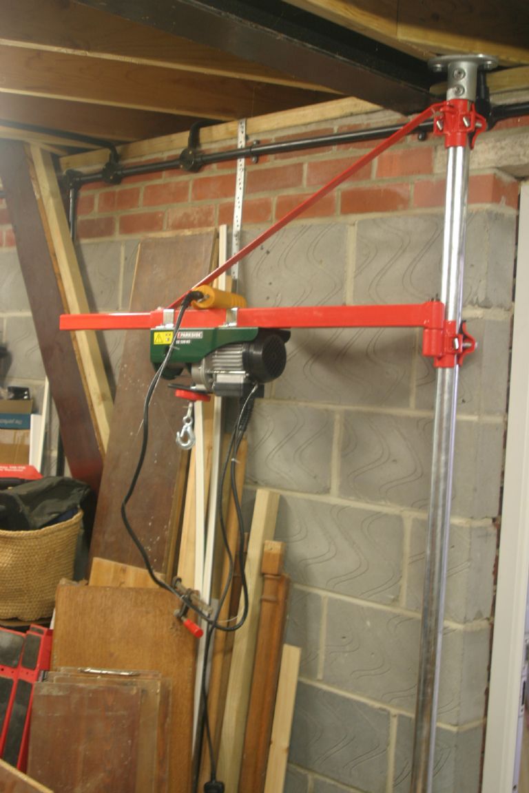

Has anyone used one of the hoist frames advertised on Ebay. You would normally mount your own electric hoist on the frame. They usually come in several versions, extending and non-extendiing. The assembly is bolted to a 48/50mm steel scaffold pole fixed against your wall. The short one (750mm long) with a 600 Kg load capability and when extended (1100mm long) 200Kg.
I need to pick up a indexing head (weighs around 67.5Kg) and be able to put in on the table on a Bridgeport sized machine. Problem I have is I have not got a brick pillar close enough. I really need a overall length of around 1.5 metres.
I am wondering whether if I replaced the extension arm with a longer one what the load capacity would reduce to, and would it be safe. So long as it would take between 80-100Kg.

I fitted this in my garage/workshop
- presumably similar setup to Clive's (Lidls sourced hoist) and specified length scaffolding pole from Ebay. Worked fine for a (unweighed but too heavy for me to lift) workbench, on the short arm. Haven't used it extended yet.

Pole location is my issue. There is a row of three heavy duty shelves where the pole would ideally need to be located. My wall pillar is about 1.3 metres away from machine.
Bill,
That is exactly what I am looking at using but the extension arm would need to be lengthened to give me a hoist position about 1.5 metres from the wall. The question is would it then hold the weight of hoist (identical to yours) and the weight of the indexer at around 67Kg.
Could you please let me know he height of your roof and the distance from the hook to the ground. I would also appreciate it if you could chdck the hook to floor distance when the hoist cable is doubled round a pulley.
Colin

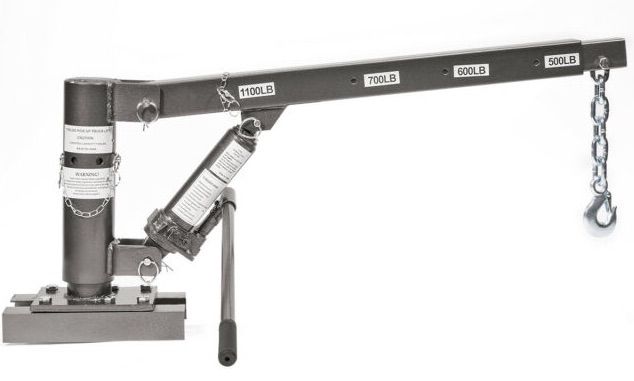

Don't see any great issues with extending the arm for the sort of weights you envisage. When putting up my extension the builder and I had mine working hard with the cable doubled and the hoist just outside the strut lifting a 15 ft RSJ. I never dared check the weights but Mr Builder said it would be fine. Scaffold pole support deflected somewhat.
Would it be practical to mount the pole in front of the shelves and swing the hoist around when access is needed to the one its normally parked in front of? Might need storage re-arrangment to put the rarely needed things behind the crane. Maybe handy if you have heavy stuff on bottom shelves.
Looked at from a different angle perhaps some inspiration here :-
A bit over hefty perhaps but as it comes apart rapidly with R clips and pin joints most of it can be stored out of the way if the main part is sat in front of the shelves. 500 kg point is around 5 ft out I think as the arm is essentially same as an engine crane.
I have been contemplating putting something like that on my work cart but the commercial ones are, realistically, way too hefty.

Colin - the various measurements are:-
Floor to ceiling - 92"
Hook to floor (normal) - 54"
" " (with doubler pulley) - 49"
The boom normal length is 28" and the extension is 40"
The support pole is fitted to the concrete floor and to the roof trusses (6x4) and about 2" from the wall.
HTH
rgds
Bill

Thanks for all the help and suggestions. I had wondered about using 41mm x 41mm unistrut and bolting it across a number of roof joists. Ceiling is plastered and there is a room above so reinforcing would not be easy, and was worried as to whether the ceiling joists would take the load.
I think I will go with the route used by Cornish Jack and make up an extended inner section. I already have a similar hoist. If necessary I can always put an additional support half way up the scaffold pole, so it has three fixing points. I cannot fix to any other wall area, a) because other machines are in the way, b) the wall is single skin between the pillars. The pillars were put in to support RSJ's which are used to support the double skin wall for the upper floor.

Hi Colin, maybe you could add another tie bar to your extension piece, take it to the top point of the existing one on the pole. It could be as simple as a suitable steel wire rope with an adjuster to get it taught. Just an idea that may give you that extra support.
Regards Nick.

Never gave it a thought to using wire rope for the extension. That will keep it all flexible. You've just made my mind up 100%.
