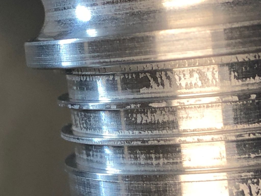

hello all, im looking for some help,
i just got a cnc lathe, but having trouble with turning aluminium, we did have some troubles with the machine and had to have a company come out and regrind the bed because there was some problems with it, but still cant get the ali looking any good
anyone know what is going wrong?

Looks like a cutting issue can you give some more info:
Type of tool and type of insert if not HSS
Speed
Feed
DOC
Dry or what type of lubricant and how is it applied
Grade of aluminium

Are you using inserts designed for aluminium? Grooving inserts seem to be elusive in the sharp grades. Some type of lubricant is required for aluminium, or it tends to stick to the cutters. Some alloys machine much better than others, pure soft aluminium is terrible to work with.
This is the sort of question which might be better on the Practical Machinist forum, they would be able to suggest the most suitable grooving tooling.

It's clearly tearing, suggests build up on the tool tip. Are you using suds or neat cutting oil?
I'm used to getting a near mirror finish on 6082 with inserts and just hand applied neat oil.
I have struggled to find ground and polished grooving/parting inserts but I would guess they would help.

hello Neil, we are using suds rather than oil, for the general parts we make out of derin oil is not needed but we are really struggling with this ali, i know part of the issue was machine alignment but i think its now something we are doing wrong

John, you say it’s a brand new machine and yet someone has had to come out and regained the bed, that is appalling on a new machine, can you supply details of size of machine, it’s not just the grooving that’s rubbish, the turning of the radius is pretty dire as well, soluble oil should be fine on that grade of ally.

Hello baz your very right its a bit shocking, i brought this large lathe and a 4 axis mill, + and load of other machines at the same time, for the most part im very happy but this finish on the lathe is way off what i would expect....is it machinist or machine is the thing or just the tooling.
my guy has been machining for 30- years but not this material.

Check the tool tips closely for any build up of material. If it is sticking to the tip, try using brush applied neat cutting oil or even paraffin and see if it perks up.
How sharp are your tools?

Hmmm, 6082 ought to be easy-peasy.
The finish is poor everywhere; looks like tearing, but could possibly be chatter? First are we really sure that the material is 6082? And where did it come from, commercial stockholder or other?
Insert tooling or HSS? You can turn 6082 with CCMT inserts, but CCGT insert are way better and give a better finish. I use aluminium specific inserts for parting off, although they're not polished in the same way as a CCGT insert. However, parting inserts need to have a continuous feed, preferably greater than 4 thou per rev, otherwise they can chatter quite badly. For accurate (manual lathe) grooving I use HSS tooling.
I generally turn 6082 dry, except for parting off, and still get a good finish. The biggest problem with 6082 is birdsnesting of the swarf, which then dulls the finish. Note it dulls the finish, it doesn't produce the results seen.
Summary: given the poor finish everywhere look for a common factor, which is likely to be the material or machine.

hi guys,
I've contacted the material supplier, weve brought about 20m if it.
We have tried machining from 500rpm to 2500 rpm using css and also fixed spindle speeds
dia turning has been done at 0.25mm/rev with a 0.06 dia finishing cut at 0.05 feed
All the tools are 25x25 shank WNT tools ali tips and using CCGT120404 inserts
the "o" ring tool is a 2mm wide grooving insert firmly gripped in a grooving holder
the radius grooves (5mm) are machined with a 3mm rad tip. roughed out and then finished with a profile program
we have brought aluminium specific polished tips for all the tools
we flood the material with coolant while cutting
parting is terrible, material goes snotty very easily,

I'm no cnc expert but it doesn't look like you are doing anything wrong to me.
I would try some material from a different supplier. That way you will know one way or another if its a bad batch of aluminium.

My view is your depth of finishing cut off the diameter ( 0.06mm - 2.3 thou)is too small for a carbide cutter.

Rpm does not really tell us much as diameter of work is unknown. M/min would give us a better chance. Your insert maker should have speeds in m/min and DOC data
Also what temper is your 6082. T6 is usual but if you have a lower number that is softer and not as nice to maching
