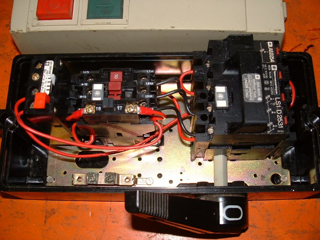

Emgee16/10/2019 23:37:32
2610 forum posts
312 photos
Posted by Colin Wilks on 16/10/2019 12:58:26:
Cracked it. Googling "enclosure junction box" produces what I am after.
Regarding a direct on line motor starter with a separate emergency stop, this makes sense as it protects against overload and allows me to position the stop switch in the most appropriate position, but is this technology compatible with my Crompton Parkinson 240v motor which uses a condenser to start via a centrifugal switch?
Overload size depends on the motor FLC, usually stamped/printed on the motor plate.
This is listed in Classifieds.
