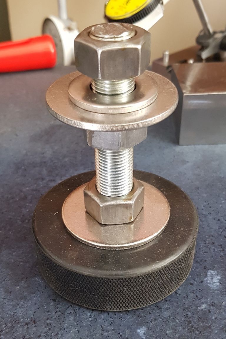

I used hockey pucks to make levelling feet for my lathe several years ago. Here is a photo of I took during the fabrication (not yet finished):
The pucks are easy to machine and has served me well for many years.
Thor
