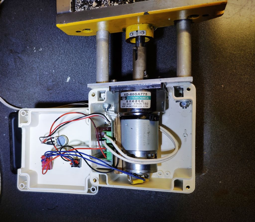

I've just acquired a Warco WM16 milling machine and wanted a X axis power feed for it.
I came across Mikes workshop **LINK** and liked his approach.
I've beefed up the motor/components to cope with the larger mill.
All the components were purchased off fleabay for around £45.
24v 150rpm gearbox motor 35W peak.. Runs at 11W on fast return on my mill.
24V 3A power supply unit
120X120x90mm Waterproof plastic project box
20A PWM Speed controller Module
Couple of switches
The power supply is adjustable slightly via a pot, so I've set it at 28v . The lead screw is a 2mm pitch and with this motor & gearbox gives 35cm/min fast travel. It slows down to absolute crawl yet still has enough torque to cope. The Power supply is screwed to the wall so the cable to the powerfeed is a safe low voltage.img_20190904_183844.jpg

I've been looking at this design for a power feed for a mill I'm working on. Two reservation, firstly is that there is no means of instantly disengaging the drive to the table. Secondly, electrical stops, how accurate are they? OK for limiting the overall feed. Does the motor stop instantly or is there a finite period of slowing down?
Neither of these are "show stoppers" for me, I'll sort out a lever operated dog clutch. As for reliable/accurate stops I can work around that one, disengage the drive near to where I want to stop the feed and manually feed up to a point on the dial/DRO.

The amount of extra beef applied was really in the end... determined by best bang for buck. That 150rpm gearbox motor combo is £20 .. after that the price of them quadruples. 24V power supplies are dirt cheap £7, 20A PWM module £4
I figured the more power the better for torque at very low rpm.
I determined the torque of the smaller and slower 60rpm motor/gearbox used originally by Mike, that apparently struggled a little under some circumstances. And then went bigger until my Yorkshire wallet complained.
I haven't implemented the stops as of yet. On the website link its stated that stop accuracy is 0.01mm, which would be more than accurate enough for me.
The motor does stop instantly at cutting speeds. I may add a panic stop button in the future if I feel the need.

I would think there would be a difference in stopping time between feed speeds and fast traversing due to the inertia?
Not the same drive, but the table power feed on my Centec 2B certainly doesn’t stop instantaneously. There is likely a programmable brake on the VFD (if I wanted to use it), but the table does not move far at switch off. The important thing is consistency - like how far it takes to stop at the same feed rate and cut. I would think a mechanical trip would be better - my lathe is very reproducible when using the carriage trip.
Question might be as to whether there is a brake on the motor used in this design.

Thinking some more over the question of stops. I believe that electrical switches that limit the overall length of feed are important. I would suggest that a quite considerable the torque is applied to the lead screw. If it was not disengaged before the limit of travel is reached then some damage will be done. Something may "give" in the motor/gearbox, worse still damage to the lead screw and nut. Even worse still the work table on these very lightweight machines could be twisted.
With no limit switches it would only take a momentary distraction , then the damage is done!

I've found that I have a "natural" limit switch in my design and so the limit switches for end of travel are not so important. I found this out due to a plastic box getting underneath the rotating hand wheel whilst under power. The power from the motor under high torque conditions overwhelmed the speed controller or 3A power supply causing it to shutdown in a kind of PWM mode. .... Handy that .

No, just been experimenting with it. Its the power supply which cuts in and out... It must have some over current detection. Its a great safety feature
