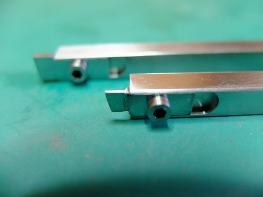

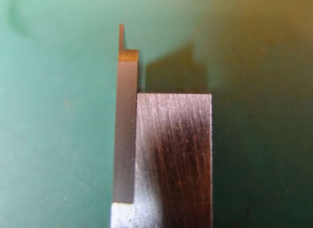

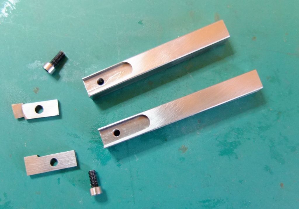

Now I'm sure that this not a new or original idea but I'd thought I'd share it anyway.
I need to cut some 0.5mm wide grooves around 2mm deep in 1/2" brass bar. I don't have access to a grinder and the only insert system i can find for that size is the "Mini-Thin" from MSC at around £70 for a holder and £18 each for the inserts.
I had some small scrap pieces of 1/16" Ground Flat Stock and some mild steel 1/4" square bar so made these-
The pictures are self explanatory. The top "insert" has been filed to shape, hardened, tempered and sharpened with a diamond lap. The bottom insert is a soft blank.

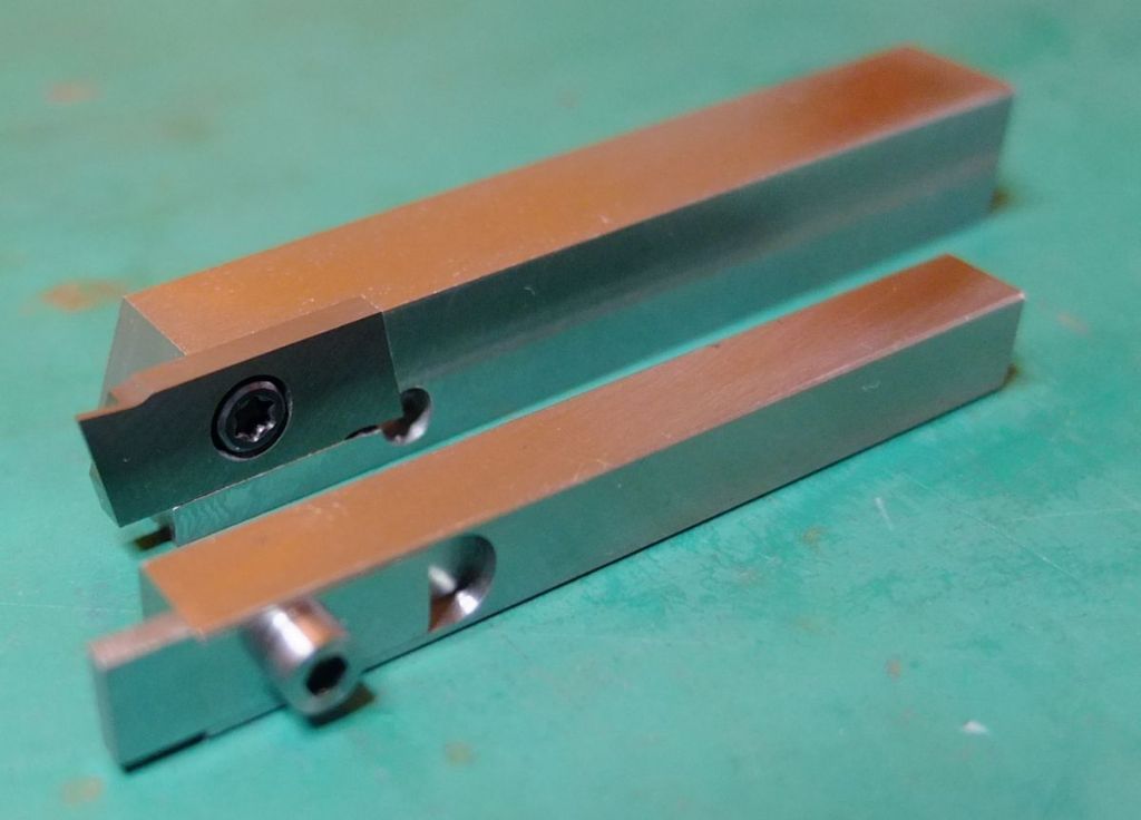

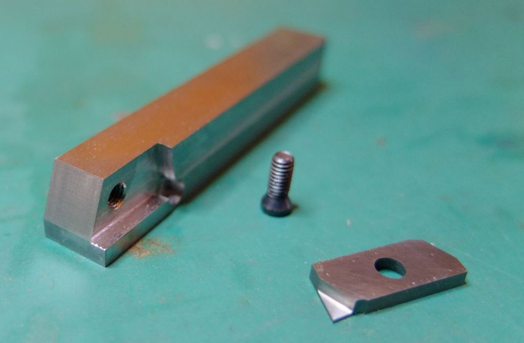

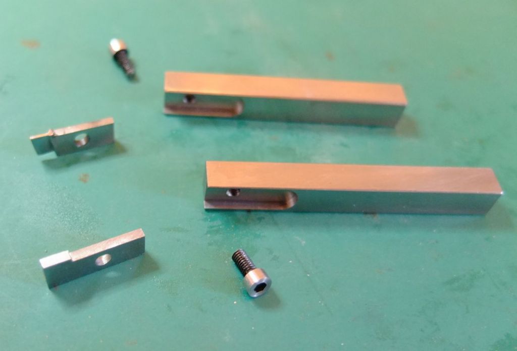

Some more photos-

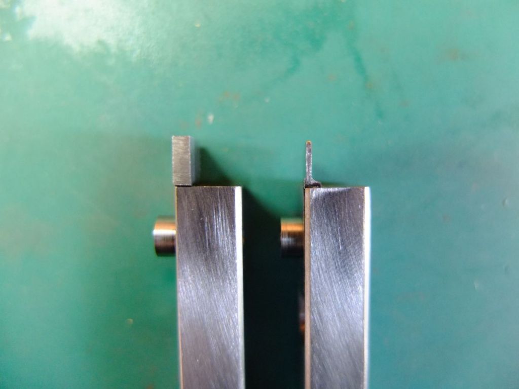

This hasn't been a success so far. After cutting two good grooves things got a bit noisy and warm. The blade has lost it's temper now and will need rehardening. I will also have to pay a bit more attention when it comes to sharpening.
I didn't put any rake on this as it was for brass but I've noticed that a lot of parting/grooving systems seem to have a negative rake. Is there a reason for this?
Any hints, tips or questions are more than welcome.

Michael Gilligan27/08/2019 14:58:21

Nice work, Steve yes
It would obviously involve much more effort, but I think your next try should be to replicate the idea using HSS: Machine Hacksaw blades being an excellent source of material.

If the ground flat stock is gauge plate, it is the equivalent of silver steel. I would try hardening it, polishing it and then heating it very slowly from the other end until the tip area is light straw, before quenching. After tempering, finish hone with a fine diamond lap. If the dimensions allow, grind the end so that the plan view is biased to the right, yours is to the left, which is not so well supported by the groove in the holder. So far, I haven't needed anything narrower than 1.6mm, the width of my smallest carbide inserts for 26mm blades. I'm not sure of the best profile for brass, it is a matter of trial and error.

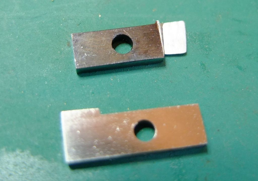

I tempered it in a domestic oven to around 190 - 200C then stuck the tip in a potato and re-tempered the shank. This was from Tubal Cains heat treatment book.
The cutting part is on the right so I can get as close as possible to the chuck - even a couple of mm helps.

Posted by Michael Gilligan on 27/08/2019 14:58:21:
Thank you Michael, that got me thinking. If I hand grind the teeth of a piece of junior hacksaw blade, it will fit nicely in the 5mm slot of the holder. I could sandwich it in place with a rectangular insert with about 3mm of blade protuding.
Do you think this might work?
The trouble would be finding all-HSS junior blades and then drilling a clearance hole for the M2.5 screw.

Sorry, I don't understand when you say the cutting part is to the right, (picture 5). As for chuck clearance, what about the SHCS sticking out? I also cannot understand why the steel should go blunt so quickly in brass. Have you tried a file on it after tempering, if the steel is low carbon mild steel, it will still be soft after any heat treatment.

Sorry, my mistake, I meant the left.
The screw on the left was unavoidable without a lot of messing about. Anyway, with my tiny Sherline 3 jaw it actually gives enough clearance. It's fine with collets too.
The steel is gauge plate. I've used the same piece to make cutting tools before. I always test with a file.
As for the bluntness, my fault. Not sharpened correctly which caused it to rub. I'd forgot to put back the tailstock centre, The work shifted slightly in the chuck, this cause a lot of heat and led to loss of temper.

I would probably avoid 'Junior Hacksaw' blades ... many of them have a wavy set to the teeth and the steel is of questionable quality.
Ordinary 10" or 12" 'Hand Hacksaw' blades might be a suitable source of material though; and they conveniently have a hole at each end.
The reason I suggested 'Machine Hacksaw' blades is that they are [or at least were] more readily available in solid HSS. [but I accept they are over-size for what you are making].
An abrasive cutting disc should make easy work of roughing-out pieces from a Hand Hacksaw blade and it also is possible [but rather demanding] to work HSS with Carbide tools.
Experiments are definitely in order, I think.
