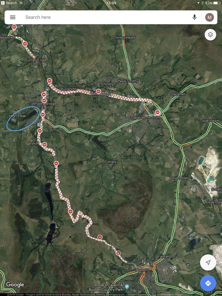

Here is one that I didn't post yesterday: **LINK**
https://www.newcivilengineer.com/latest/engineers-battle-night-save-derbyshire-dam-02-08-2019/
[please note the publication date though]
I have just returned from a walk, and can confirm that even more roads in the area are closed, and there is a significant Police presence ensuring compliance !
Rain and thunderstorms are forecast for tomorrow.
