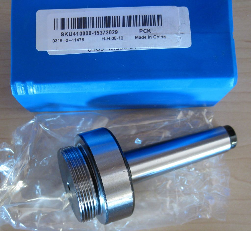

I ordered an MT2 arbor with a 22mm Spigot for a face mill cutter:
and received this instead : ( good old banggood..)
The big end is threaded 1-1/2 18UNF - what would this tool/adapter be used for??
Joe
Emgee03/04/2019 20:34:24
2610 forum posts
312 photos
Perhaps a boring/facing head.
Emgee
Richard -03/04/2019 20:38:57
62 forum posts
7 photos
It's a morse taper screw in adapter for a shell mill holder/face mill or such like.
Richard
JasonB03/04/2019 20:39:52
avatar
25215 forum posts
3105 photos
1 articles
Yes looks like it is for a boring head as Emgee says

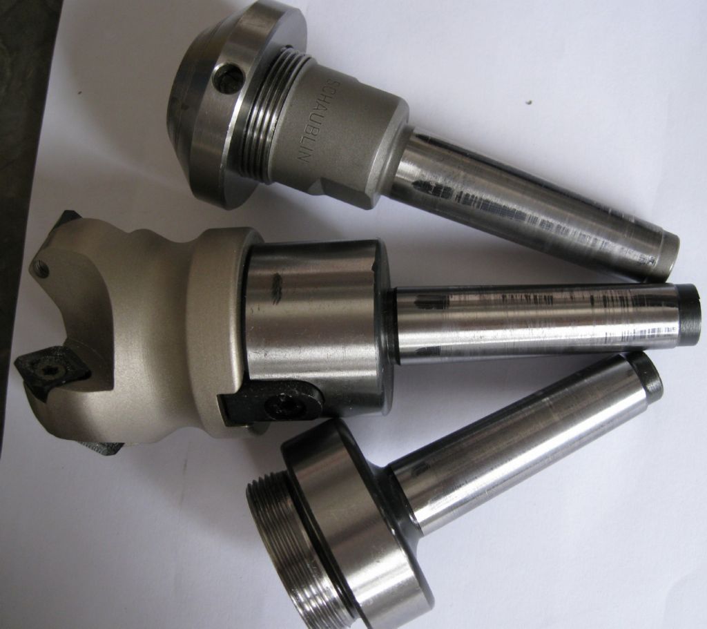

I previously purchased an MT2 arbor as in my first photo, also a 100mm diameter MT2 revolving center ( for pipework) and quite a few other lathe carbide insert holders and have not really been disappointed.
Regarding the MT2 fit - here is a photo of my Shaublin ER16 MT2 chuck, the MT2 shell mill adaptor with and the threaded adapter incorrectly supplied - I use permanent marker and made thick stripes down the taper and then wedged/rotated it in the EMCO FB2 MT2 spindel. All the fits are good...particularly the incorrectly supplied arbor!

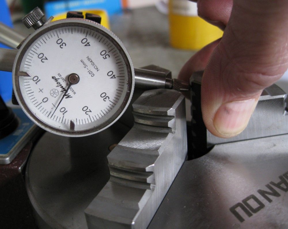

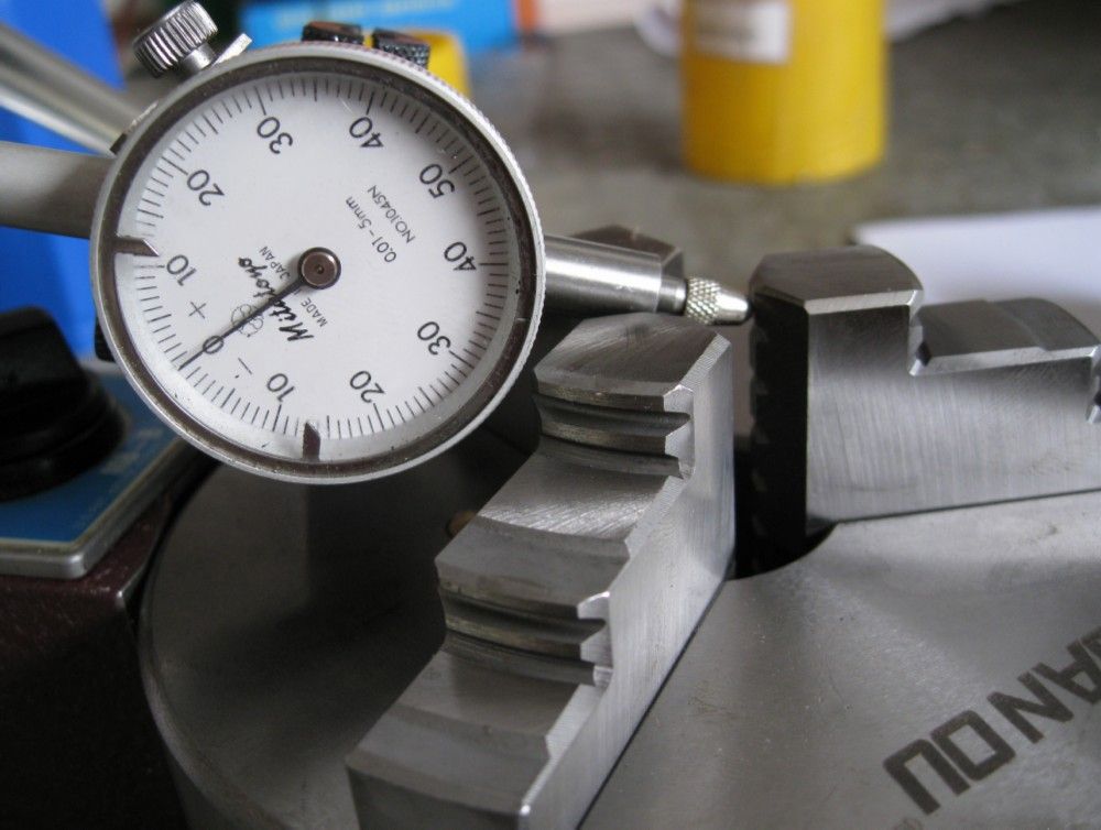

There are exceptions...I also purchased a SANOU 125mm 3 jaw chuck. Very nicely made, clean, chuck key turns smoothly, but its useless..
The jaws have a lot of play into and away from the chuck face ( ie, not the play when sliding the jaw across the scroll spiral, there is also play there and not too little either!)
The first photo shows the dial up against the outer tip of the jaw, with the jaw firmly pulled against the scroll, away from the centre of the chuck, but with the jaw pressed down against the chuck face.
Dial set to zero, and the the jaw , at the dial tip, is lifted up, away from the chuck face..while kept back against the scroll, away from the chuck centre.
So any workpiece that does not extend fully through the jaws will make the jaws bell-mouth, with tapered contact on the workpiece. I intend to get my money back..and they do respond - I have good email relations with them on such issues and they respond everytime within 12 to 18 hours. Refunds occur within 48 hours..
