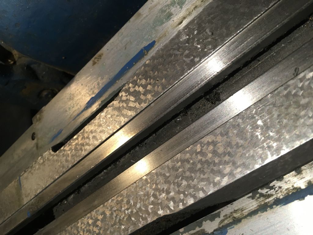

I recently bough a used and misused Habegger DLZF. While some areas of the lathe are practically unworn (and I still have more cleaning to do Before I can measure the wear in the machine) other areas have pretty nasty defects from crash damage in the slide ways of the lathe bed. I suspect this lathe has been run primarily with a chuck, as this is where most of the damage is. I intend to run it mostly with the W20 collets that came with it and this places me with the saddle just over the damaged areas. I've run a fine stone over the affected areas to see if I can reduce any high spots and I Think i can manage that. Still, I would like to fill in any larger voids in order to prevent chips getting between the bed and slideways causing undue wear.
Does anyone have a good way of doing this?
I've tried to read up on the subject and came across JB weld (deemed to be too soft and prone to embedding chips and dirt) various spray welding techniques (a bit complicated for me) and a two Component putty called Moglice, made by the German Company Diamant. Moglice is advertised as a slide way casting compound with low friction coefficient and high wear resistance. It seems quite ideal for this apart from the fact that I don't intend to cast the entire length of the bed. I also can't find it for sale anywhere, at least not in small quantities. Something matching in colour would of course be preferrable but in this case I'll take function over form.
If anyone has used Moglice on their Machines: is a repair such as the one I'm discussing above feasible? Would it be able to stone the Moglice down to the level of the surrounding material after it's hardened?
Any and all other suggestions are welcome!

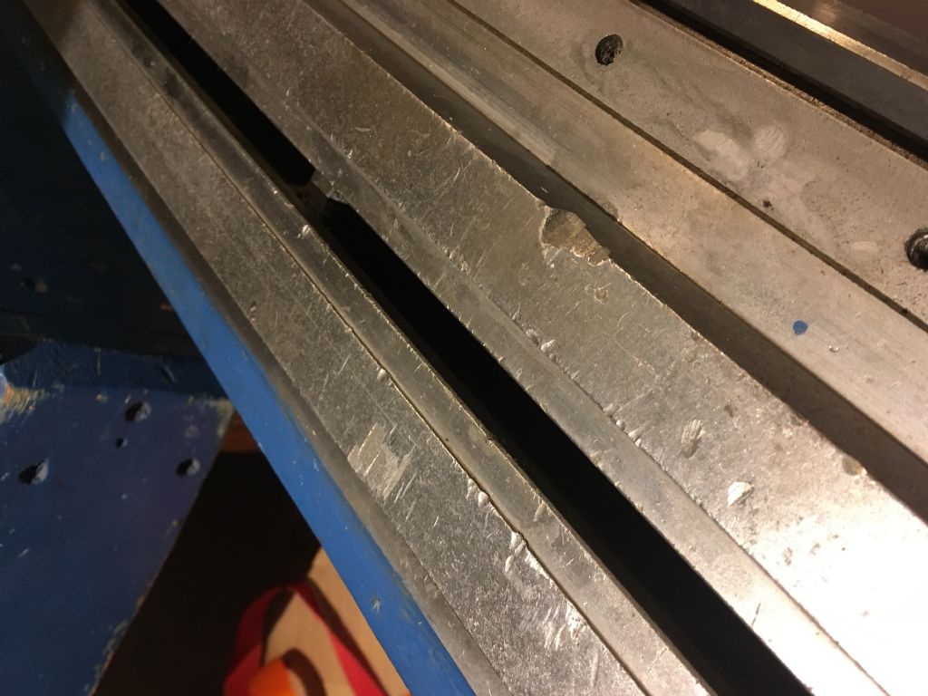

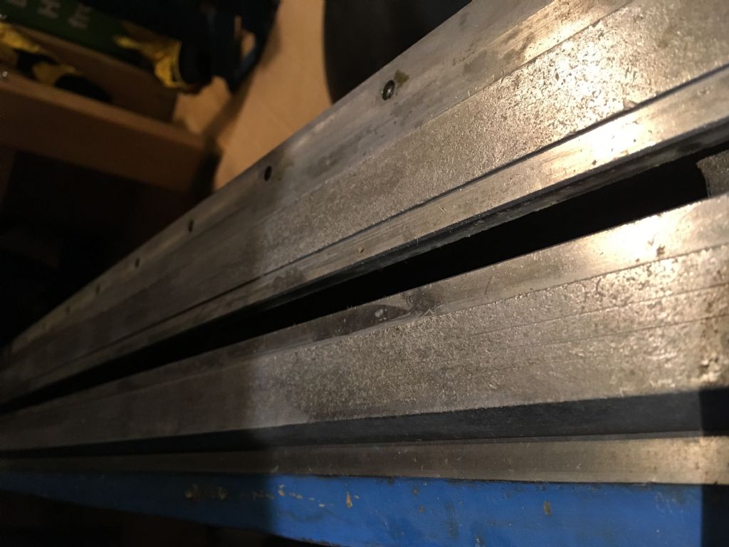

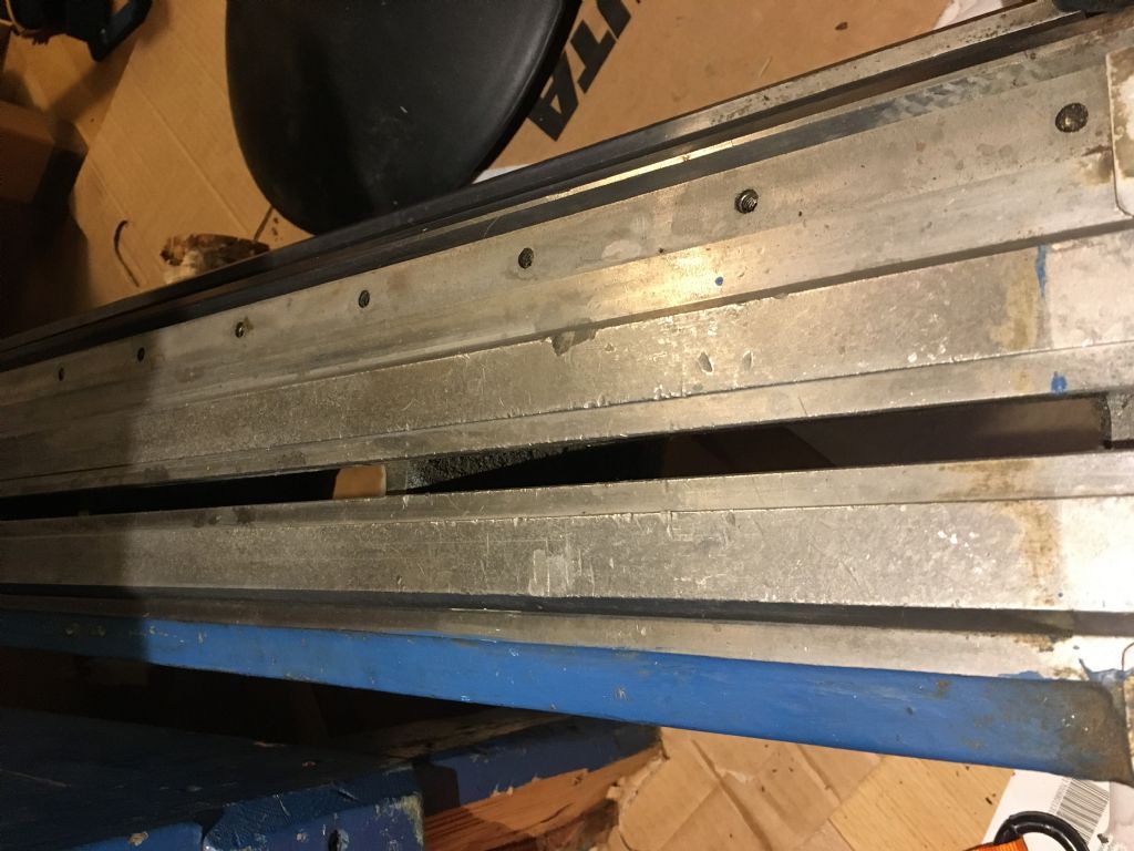

Karl Mansson12/02/2019 16:46:58
34 forum posts
17 photos
Chris, I had not looked at Devcon until now. Their WR-2 seems like a good fit. Still, I don't know how any of these hold up over time as I dont' have experience with them. It does appear to be cheaper than at least Moglice.
Photos of the crash damage. There seems to be pretty extensive pitting as well, I'm not sure how that got there. The castings on these machines are supposedly very good. You can see the perfect, scraped surfaces from underneath the headstock. Sorry about the orientation of the images, the forum doesn't seem to recognize orientation data from my iPhone.
