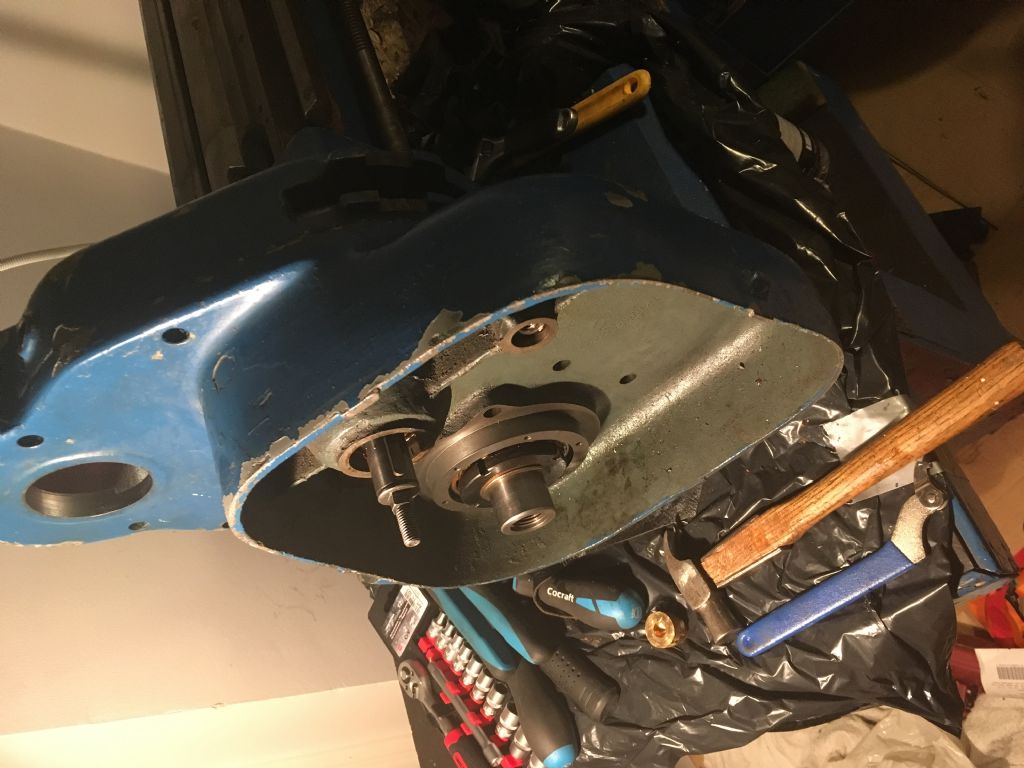

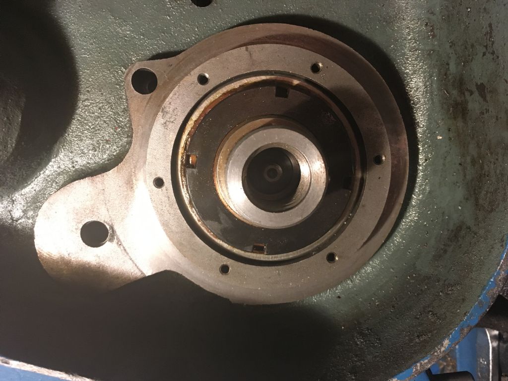

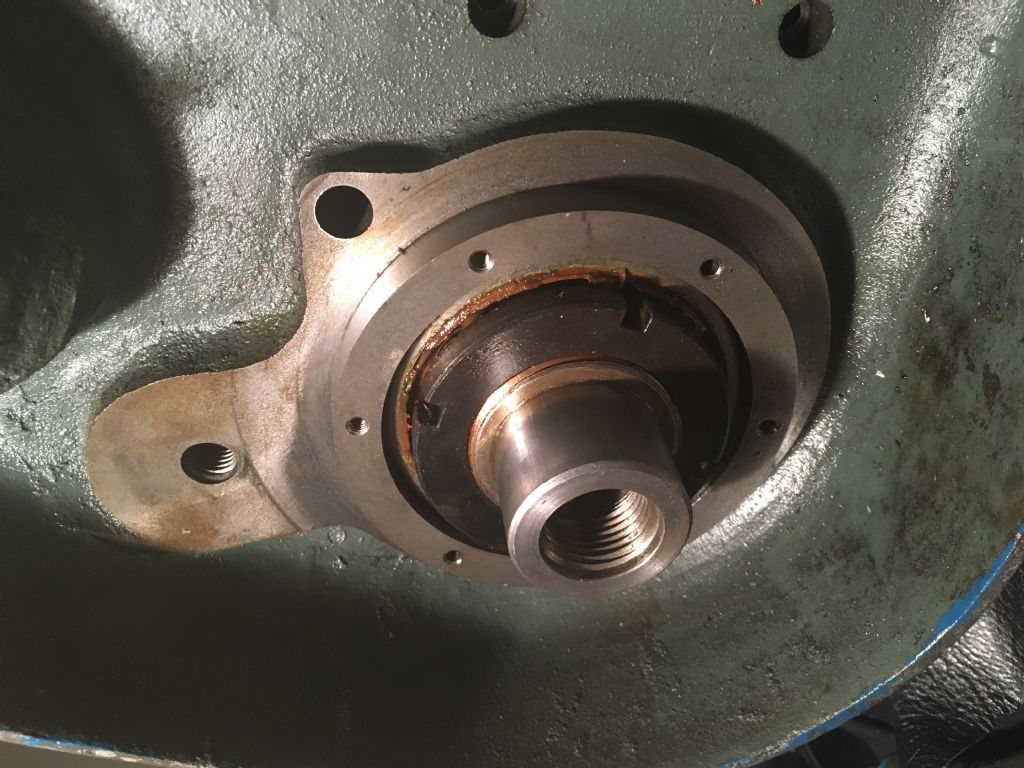

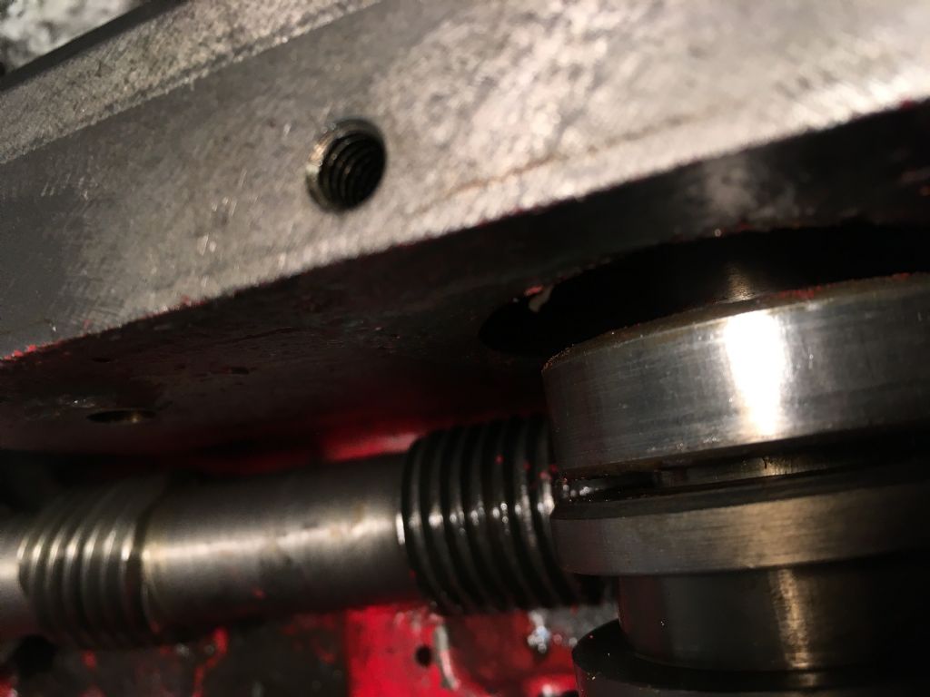

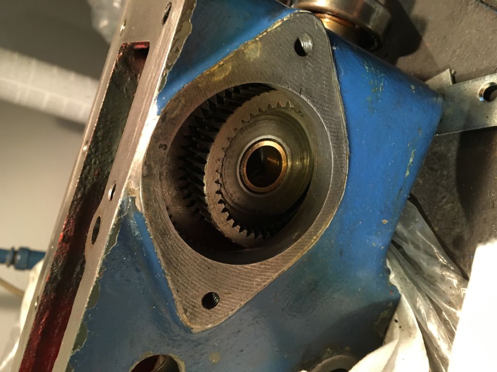

Thread: Removing large flange nuts
16/03/2019 16:51:23
I could have sworn I posted an update on this earlier but apparently not.
I got the parts apart! The last two screws were hidden behind the large bearing for the lead screw. Very complicated disassembly, this... I got the gear box off of the shaft but now I can't get the tumbler out of there.
As I mentioned earlier the shaft for the central tumbler wheel had a C-clip on it, indicating that the shaft is supposed to be a sliding fit through the bearing. I tried tapping it out earlier but it went a mm or so before sticking. So I thought I'd try to get the bearing out of the housing instead as most other bearings have been a slip fit into the castings on this machine. Got it a cm out or so but the the sound from my brass drift became very solid. I think I may have wedged a piece of dirt between the journal and the bearing. I've tried re-seating the bearing on the shaft and I've used a plastic bushing to take the strain off of the bearing while attempting to tap it home. I'm going to make a better bushing out of brass or copper as I suspect the shock isn't transferred properly. I don't have a press so I'll have to use my trusty old hammer and a brass drift.
Thanks againfor all the suggestions! I'll post pictures of what I'm dealing with this time around later. Any more suggestions on tackling this would be most welcome!
Best regards
Karl
16/03/2019 12:15:32
Thank you for all the suggestions, gentlemen!
I did get the nut loos last night! I got myself a larger c-spanner and grabbed the shaft with a pipe wrench with some aluminium in between as protection.
The bad news is that it made no difference whatsoever. I got the leadscrew out but the sections of the gearbox still won't budge. I removed a C-clip from a shaft that I then tried tapping out. I soon realized that it was probably designed to be removed once the cover for the change wheels was taken off and had an integral gear on it. So I stopped and tried tapping it back the other way but I must have moved someting on the shaft because now it won't seat fully. So now I HAVE to get the thing apart.
Suggestions? I'm afraid I'll break a casting if I try prying more. I've tried tapping a knife edge into the seams between parts but so far nothing has given way. I'll inspect it again today with fresh eyes but I've already gone over it something like 20 times and still can't find any screws holding it together.
Best regards
Karl
Edited By Karl Mansson on 16/03/2019 12:15:44
14/03/2019 22:42:31
I give up.
I've tried getting this gear box off for something like two weeks now. I've taken every screw I can see out of it and it won't budge. The whole gear box is a layer cake with four parts. I've gotten the front end off, which holds the feed rod for the apron. What is left is the rear cover for the changewheels and the tumbler mechanism in a separate housing behind it. I've take pictures from inside the the rear foot of the bed and can see at least one threaded hole there which I assume holds a screw that I haven't undone. To get at it I need to get the change wheel cover off. I've removed everything fastener I can see except for the large flange nut pictured. It holds the large bearing for the leadscrew (this lathe has dual feeds). I find it strange because in the rest of the lathe the bearings will come out of their housings rather easily axially. Then again, this is a bearing that will see a fair amount of axial load being a lead screw bearing. So you'd want to keep it very closely aligned axially.
The casting flexes a little bit when I apply pressure at the top and reveals the separation between the parts. It does not at the bottom. Almost all of the parts have been painted over so it's hard to tell if that's why the parts are stuck together of if there are som fasteners I've missed left in there. The only thing I can SEE though is this nut and I think it may be compressing the other parts.
This became a long winded buildup to my question, just wanted you to know what I've tried so far and how the problem looks at the moment.
How do I get this nut off? This is the largest of its kind on this lathe. I have a single pronged spanner that I've used on the others and the best way to use it has been to use it to lock the nut and then turn the screw. I can't get a grip on this without damaging I'm afraid. I've used one of the change wheels for leverage but then getting the spanner in behind it becomes a problem. Plus I need to hold the change wheel by hand as not to damage it. I've put some penetrating oil on it now and I'll revisit it in a day or two.
I know this is an unusual lathe but if anyone has any specific advice on this lathe I'd love to hear it. Or if someone can point me to an authority on Habegger lathes. This is a Habegger DLZTE.
I'll also take any advice I can get in regards to removing nuts such as these.
The reason I want to get the gear box off is to be able to better handle the lathe bed for paint stripping and painting witout risking damaging the gear box castings.
Best regards
Karl

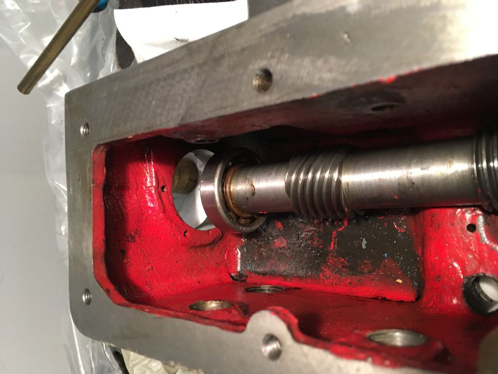

18/02/2019 09:41:24
Posted by John McNamara on 18/02/2019 05:34:44:
Hi
That is a very interesting lathe, Unusual would be another appropriate word, In particular the way the bed is set up. I am guessing it is pretty accurate too.
I would just wash out the saddle and leave well alone.
Note that standard deep groove ball bearings have clearance They will visibly wiggle, a nice scientific description! don't mistake this for wear. They may still be within spec.
Regards
**LINK**
PS "If it aint broke dont fix it"
Thank you! I'd like to think i got lucky on this one. There is a lot of work to do in terms of cleaning up, checkingand possibly even scraping. Most parts don't seem too worn out, many just dinged or damaged cosmetically. There are some areas with pitting in the bed and I haven't measured anything yet. They apron hangs off a second slide way on the front of the machine, making me think that this lathe will be a beast to regrind. So much geometry to take into consideration.
Originally these were made well on par with the Schaublin lathes of the time. This particular design seems to be made with wear resistance in mind, it has a separate drive shaft for the feeds, and the lead screw is reserved for screw cutting only. The lead screw nuts were incredibly dirty but look like they are practically unworn.
https://drive.google.com/file/d/0Bxr59DtuJda_Z0xsYmxaaEZtLWM/view
The DLZTE is towards the end of the catalogue I linked above.

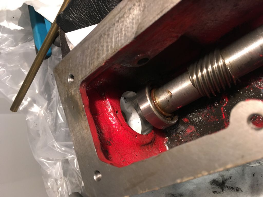

18/02/2019 09:36:25
Posted by Hopper on 18/02/2019 01:47:46:
They are handwheel bearings. Totally non-critical. It is not worth risking cracking the apron casting by putting strips behind them and pounding on things with an 'ammer and drift, thus transferring the shock loading to the casting.
You'd be better off to soak and wash out the whole apron in solvent in a proper parts cleaner or even just a large bucket etc, without disassembly. Surely the oil level in the apron will be high enough to lubricate these very low speed, very low load bearings when reassembled? Or if not, you could squirt a bit of grease into them using a grease gun with syringe fitting on the end etc. Or even heat some grease up and pour it into the bearings, if you find that grease packing is essential. Grease can be heated in an old tin can on the stove or with a torch etc.
If you feel you absolutely must remove the bearings, you might try heating them with a propane torch to expand the inner race until you can slide it off the shaft. That way you won't destroy the bearings as using a hammer and drift often does.
Personally, I'd leave well alone and go with the solvent clean up and possible regrease if the apron oil level sits below the bearings.
Thank you Hopper, yes I'm starting to feel that would be the best approach. At the moment I'd just like to keep the hand wheel assembly from rattling around in the apron casting when I'm handling it for painting. Guess I'll just have to wedge it in there with some soft material.
17/02/2019 17:15:22
Posted by Ed Duffner on 17/02/2019 17:13:38:
Hi Karl,
It looks like you have moved the shaft to one side already and one of the bearings is outisde the casting. Can you place a couple of soft bars between the bearing and the casting and gently tap the shaft inward?
Ed.
Thank you for the suggestion, Ed! I tried that and they wouldn't budge. The drive shaft is out now though. I think I can clean and re-pack the bearings adequately now. The only remaining part is the handwheel assembly and the bearing there.
17/02/2019 17:04:31
Posted by Robert Butler on 17/02/2019 16:45:59:
The images are unclear, but if there is a bearing at each end can the bearings be removed? If so you may have waggle room to shift the shaft through the bearing housing. Maybe on reassembly the bearings are then inserted on to the shaft when the shaft is back in place? The original bearings may be sacrificial but the skew gears look as though the are an integral part of the shaft. Robert Butler
Unclear how? That they don't show the whole shaft?
There is a bearing on either end of the drive shaft. I've managed to wriggle that past the gear stack that is left now, and as I suspected the bearing on the other end cleared the housing. Yes, the teeth on the shaft are machined directly into it.
The part that remains now is the hand wheel assembly. Still not enough room to persuade that one out of there.

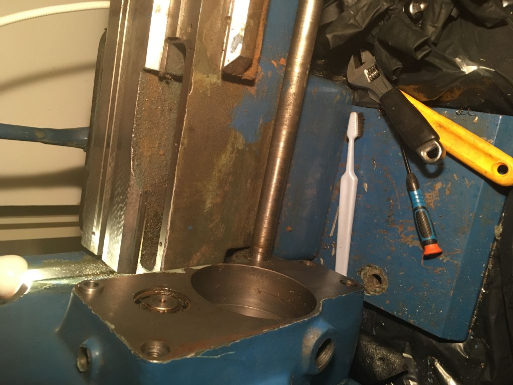

I'm repainting the lathe and all cast parts. I want to be able to clean the parts as thoroughly as possible and strip them of old paint. Also, from catalogues I can guesstimate that this lathe was made in the 1950s. There is plenty of semi dried up grease in the bearings and on various parts of the lathe. I'm not even sure if these bearings are supposed to be greased or if they should be lubricated by the oil bath that these gears run in. There is a planetary gear system in the handwheel assembly that simply oozes black grease and that is really crunchy to the turn.
I've managed to spray some bearings out with brake cleaner and will re-inject those with fresh grease (the rear headstock bearings for instance) but for these that were more poorly shielded I'd like to clean them in an ultrasonic. Or at least get their associated arbors out so that I can strip and paint the housings.
Karl
17/02/2019 14:14:35
Hello! I tried searching the forum on this subject but came up short.
I'm continuing the taking apart of my Habegger DLZTE screw cutting lathe and I've gotten as far as the apron. All the mechanics in the lathe so far seem to be in a fair conditions but cosmetically it's terrible with a lot of painted over screws and joints between parts.
The latest problem with the apron is getting the gear stacks out. I'm stuck with the gears directly behind the hand wheel. And without getting that gear off of there, I can't get the driving rod for the feeds out.
Almost all rotary, manual functions on this lathe have ball bearings and they are rather snugly fitted into the castings. I can either push them out by hand or the come loose with just a little amount of tapping with a plastic shaft. They are however rock solid on their respective arbors. Probably a press fit. Several of the components feature captive gears or captive designs where it appears to me that I need to get the bearing off of the arbor in order to disassemble correctly. I can't see how I could get a tool into any of these situations though, without running the risk of damaging things.
As is the case in my attached photos, the middle wheel is captive between the first and the bearing. The first, smaller wheel will pass through the hole in the casting in the front of the apron but not with the captive gear trailing it.
I've tried placing a plastic spacer between the captive gear and the casting and tapping the spindle out with a brass rod but it won't budge. Is this supposed to be set up in a press in order to be disassembled or am I missing something. It seems impractical from a service point of view. I think the feed rod will come out with the bearings still attached as the holes in the castings are through holes, but the bearings won't clear the gear stack that is causing the problem. I've tried shimmying it out of there but no luck.
All help is appreciated!
Best regards
Karl
Edited By Karl Mansson on 17/02/2019 14:16:37
