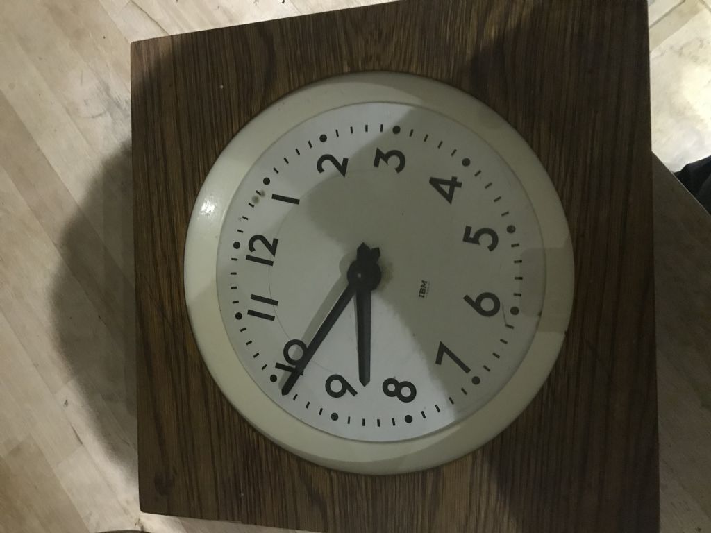

Can anyone tell me anything about this clock mechanism? Is it useable? I think it will look great in my workshop.
Simon.

That looks like a repeater clock of the type that was fitted in factories and offices. This receives a signal from a master clock in some central location that operates the solenoid to flick the ratchet to the next minute.
Unfortunately, you need a master clock to operate it!
Personally, I would remove the mechanism and replace it with a quartz movement but retaining the case, dial and hands.

It looks like a slave clock made by IBM for master/slave clock system. Similar in function from those made by Gents. You may get more asking over on the Synchronome clock forum.

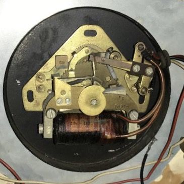

Hi Simon, I used to run one of these using a GPO clock No 36. To drive the clock mechanism will require quite a bit of current for the oomph needed at 48 Volt. I used a system of a slave relay to protect the master clock movement contacts to drive a nicad on float charge to give the neccessary oomph. Very simple and worked for years. So just saying I would advise as Simon mentions above use the relay. Be aware they are quite noisy aith a noticable clunk every 30 seconds. I presume if you operate the mech yours moves on half a minute?
I sold my clock 36 Mechanism and converted the clock to a quiet german quartz mech. Finding one with the right hands was a fiddle. Alan

A few years back I converted a very similar clock for an acquaintance. I seem to remember that the solenoid needed 24 volt pulses. I build a driver based on a watch crystal, divided down to give 1 pulse/sec. If I was doing it again I would simply divide 50 Hz mains. Be aware that these mechanisms are quite noisey. OK in the workshop, but the clunk every minute might be irritating in a quiet domestic situation.

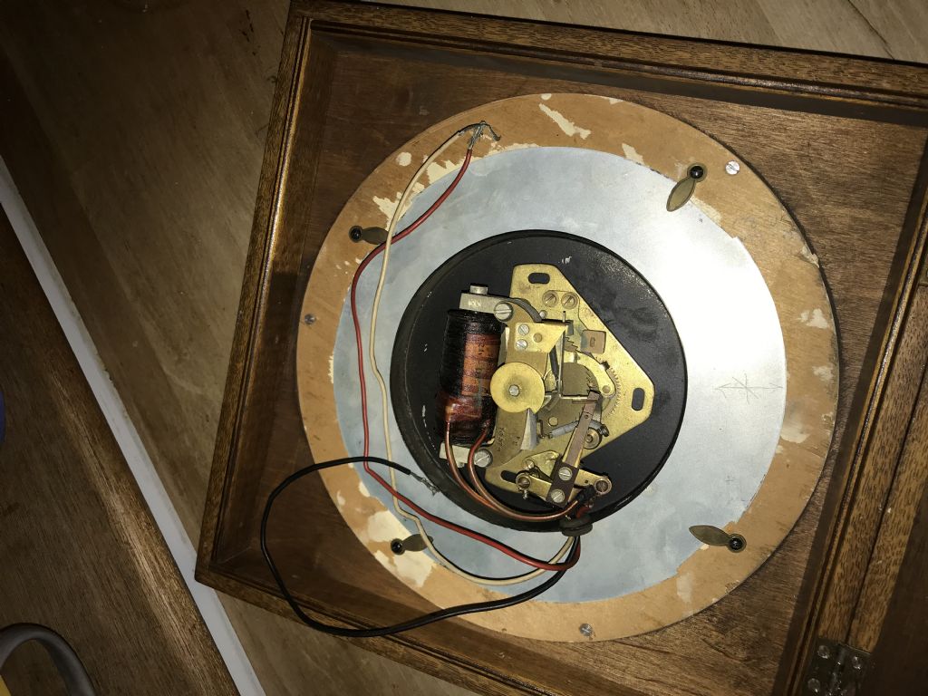

P.S. ... I note there is a number stamped on your movement, but I can't read it. cool

Bear in mind that there are going to be a million pulses a year so quite a strain on a microswitch. I looked at this some 30 years ago for a church hall and concluded it would be hard to make a mechanism that had the long term reliability and servicing opportunity of a master clock. It is all very well relieving the switch contacts with a transistor but who would repair a specialist one off circuit. A master clock had a support infrastructure of trained clock repairers, now rather less common.
Also wrt slotted discs you need a circuit that limits the pulse length to about half a second. It might be that a trickle charged capacitor would provide the punch.

This is not a "IBM/Simplex Synchronous Correction cycle" clock as suggested by SOD, it's a minute impulse with sync. Normally 1 ppm on red back pair but if out of sync a (normally manually initiated) series of rapid pulses on the white / black fast forwards until the cam switch opens. A capacitor discharge as suggested by Bazyle is a good idea. charged to between 12 and 24 V by a series resistor and discharged by a transistor through the coil.
Note that the IBM system is different in detail to the British ones.
I could be persuaded to do a circuit for you if you wanted. For a little extra I could put an rubidium standard in it so you would have your own atomic clock with 1 minute resolution

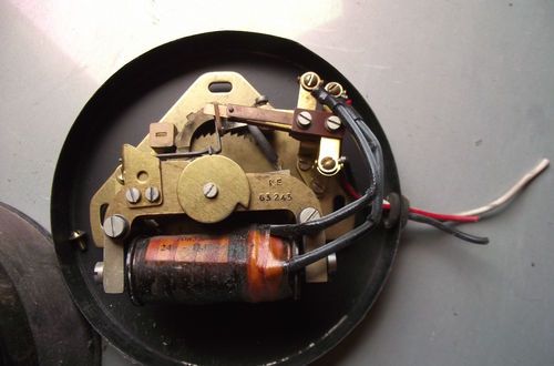

Perhaps the hidden gem in the link that Peak4 provided is this picture of a Gent's movement
Which bears an uncanny resemblance to Simon's "IBM"

Now that's interesting. Presumably someone fitted an IBM clock face to a Gent movement as a repair. I bet there's a story behind that!
It's true the movement doesn't look like a synchronous motor - I assumed, oh dear - that the drum was hidden under the big central cam.  Wrong again.
Good news really - easier to fake a Master electronically for an impulse type clock I think.
