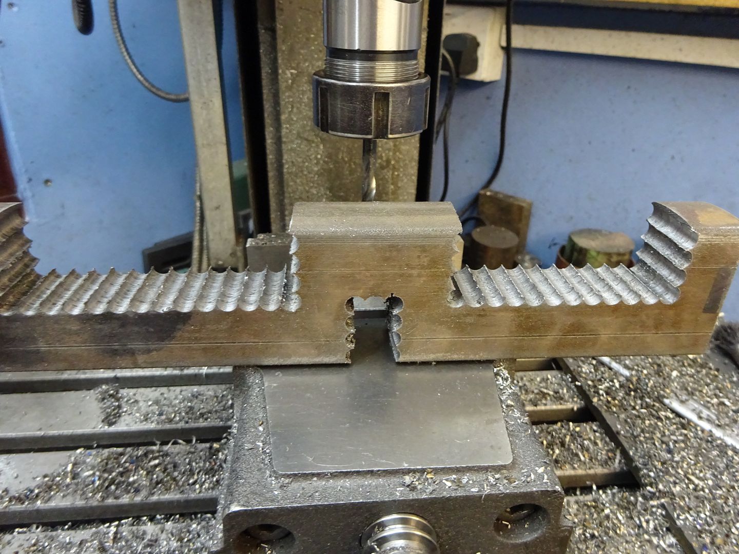

Macc's flat is bright so will need heating first, M-Machines won't.
I've tried bright in the past and you can see it move before your eyes as you stitch drill out the waste. Since then I have used flat section or flame cut from plate.
Then again you could do a built up one from PGMS and a couple of slices of round EN1A and make the balance weights as one with the webs. Silver solder or even stick it together with Loctite and it will be good to go

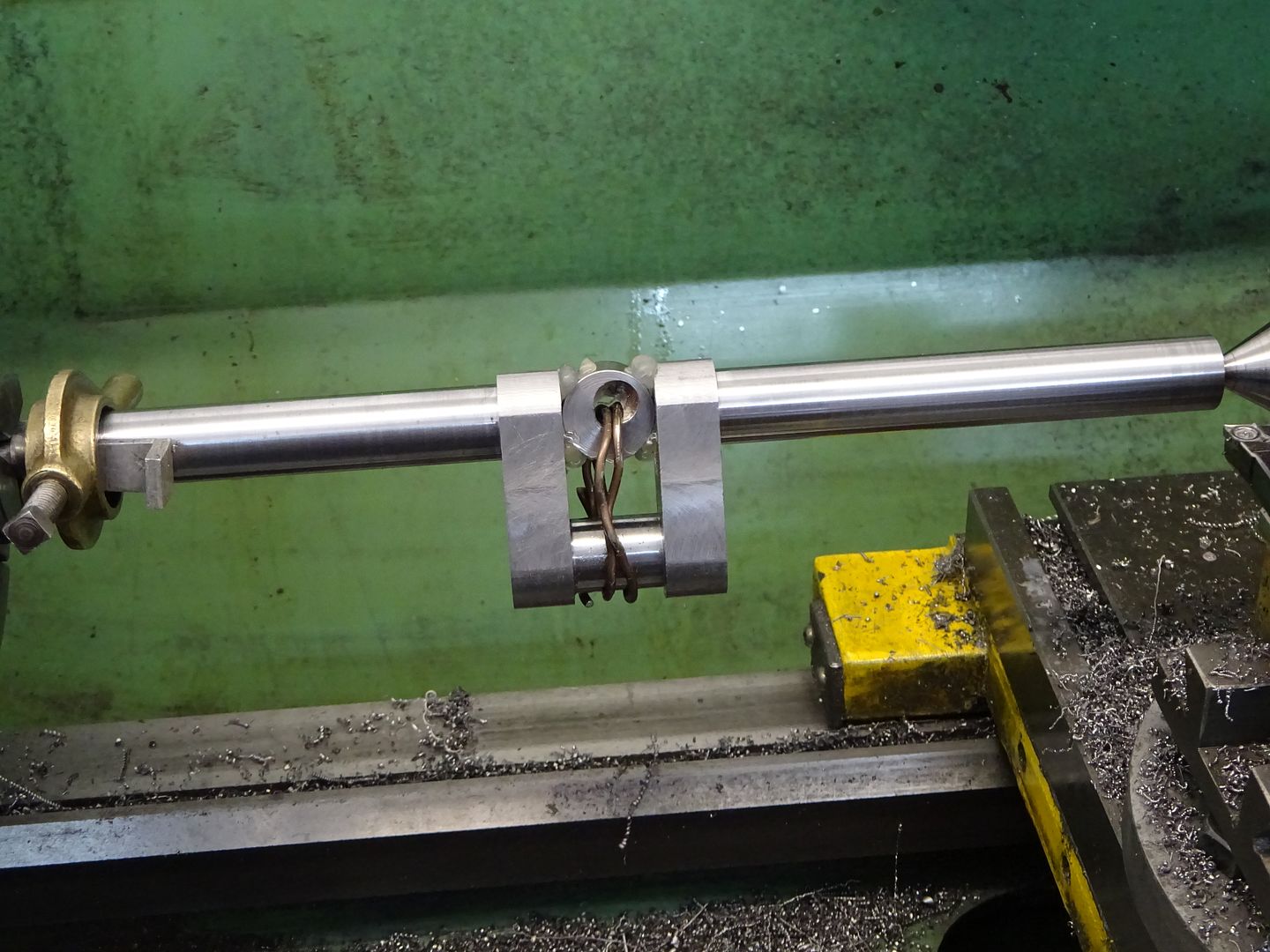

So do you reckon the
black hot rolled
will machine ok to give good bearing surfaces?
I have made cranks before using built up methods but fancied making one from solid.
Alan
JasonB16/10/2018 20:55:20
avatar
25215 forum posts
3105 photos
1 articles

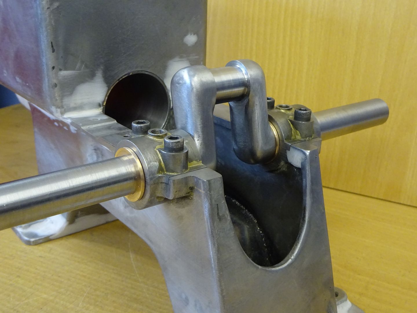

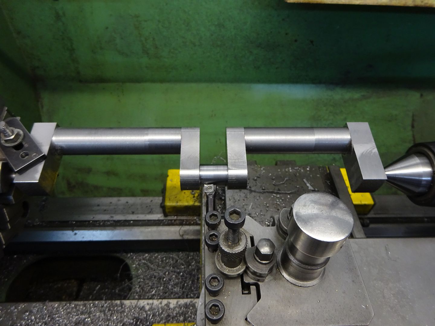

Well it can look a bit rough to start with
And still a bit dull from roughing out
But comes up Ok with finishing cuts
Bit of shaping of the webs and it is as the earlier photo, in the engine below
