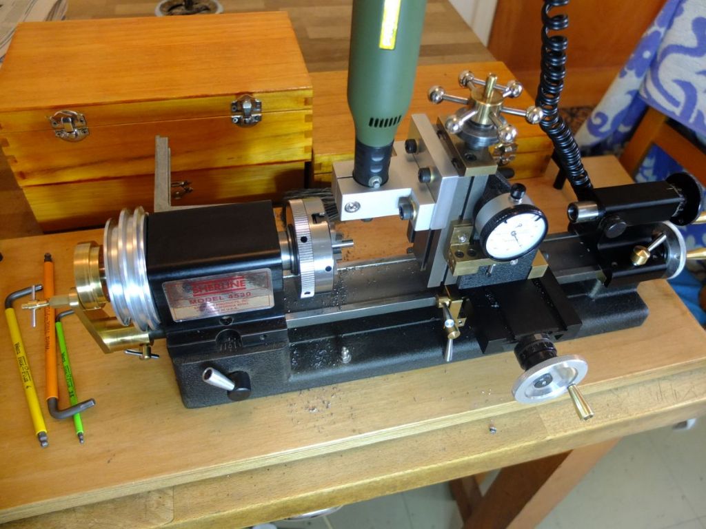

I want to make a small belt driven milling/drilling spindle to accept 8mm watchmakers collets. I envisage making the body from 3/4" mild steel square stock.
Has anyone out there made one of these or similar?
I would welcome any advice regarding bearings etc and preventing any play along the spindle axis.
Many thanks
Steve

Given that you probably want at least a couple of mm of spindle around the collet body at a minimum then a 12mm spindle, more if the head is to fit without excess overhang. into a 3/4" housing does not leave much room for bearings, would probably have to be plain bronze to keep them thin enough.

I was planning to use a 12mm spindle. The 3/4" dimension is not set in stone - I could go up to 1 inch square stock.
I realise I won't have much space so I am thinking about oilite sleeves. What concerns me are the thrust bearings to prevent play.

I have considered the ready made approach but the spindle you mentioned is a little large for my Sherline lathe.
I'm also considering using 20mm round bar for the housing so it will fit in the clamp seen in this picture.

May I suggest that the bearings could usefully be magneto bearings. That is a trade description so you don't have to buy one of Mr Bosch's masterpieces and strip it down. They are like small cup & cone bearings, and they work like small tapered roller bearings, so if you adjust the pre-load on assembly you can get a free running shaft with no end play and no side play. Here is a link to an example:

Thanks Tim, I've had a look at these and they seem ideal but the outer diameter is too large for the compact housing I'm trying to achieve. I'm looking at possibly a needle roller cage between spindle and housing but am still puzzled by how to eliminate endplay.

I have a potts milling spindle which I use a lot.
I had problems with spindle end play and solved it by removing one of the adjustment collars and replacing it with a slim thrust ball bearing (from simply bearings). The remaining collar is squeezed lightly on to the bearing ring and the end float is gone, completely. I locked the collar in place with small grub screws to retain the setting.

Plenty of small lathes just use a pair of ballraces for the spindle and end play is dealt with by threading the end of the spindle so a nut/nuts can be used to take up the play.
Assuming a 12mm dia spindle with a larger "head" to accomodate the collet taper then you can get thin ballraces 12mm ID and 18mm OD which you should be able to get into say a 20mm casing, could even narrow it down in the middle if you want to get it into a toolpost. This would mean a small amount of overhang due to the bearing not being around the widest point of the collet.
If you wanted to have the whole of the spindle within the bearings then you would need say a 15ID x 24OD thin bearing at the tapered end but could still use the smaller 12mm ID at the far end. Body would need to be 26mm or 1" at a push but could still be thinned down for most of it's length to make it easier to clamp but I would think one flat face would be a good idea.
The "head" would bear against the inside of one bearing and your fine threaded nut against the one at the opposite end. Spindle protrudes beyond the nut so your drawtube can bear on the end of the spindle
