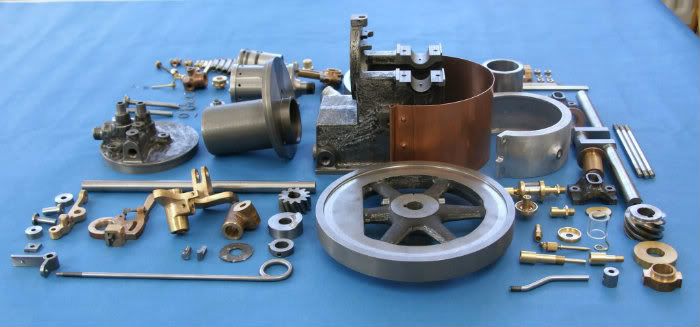

Phil P03/09/2018 23:56:16
851 forum posts
206 photos
What you need is a pair of gears like the ones in front of these castings.
My dad made those many years ago on his CVA hobbing machine.
Phil
