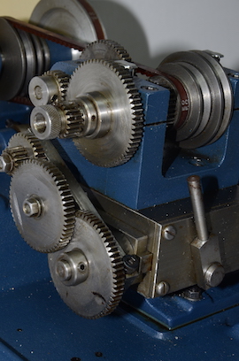

Sherlock06/08/2018 19:46:05
52 forum posts
11 photos
That Looks Great Jason I shall definitely like to try that. When you say a simple gear on the spindle to index please would you mind elaborating on that? or if you could link to a picture maybe that would be great so I can visualise it.
Does it go behind the chuck, like a division plate? then something I'm guessing gets fastened somewhere else to index to those teeth?
I went an ordered a scissor type knurled anyway for the sake of £14 and after realising the tool shaft is removable so I can just unscrew and take my angle grinder to it in a pinch.
Edited By Steve Sherlock on 06/08/2018 19:46:18
JasonB06/08/2018 20:04:25
avatar
25215 forum posts
3105 photos
1 articles
You should be able to use the large gear on the left of your spindle under the cover, a simple detent of some form to engage between two teeth will allow you to divide work into quite a few numbers

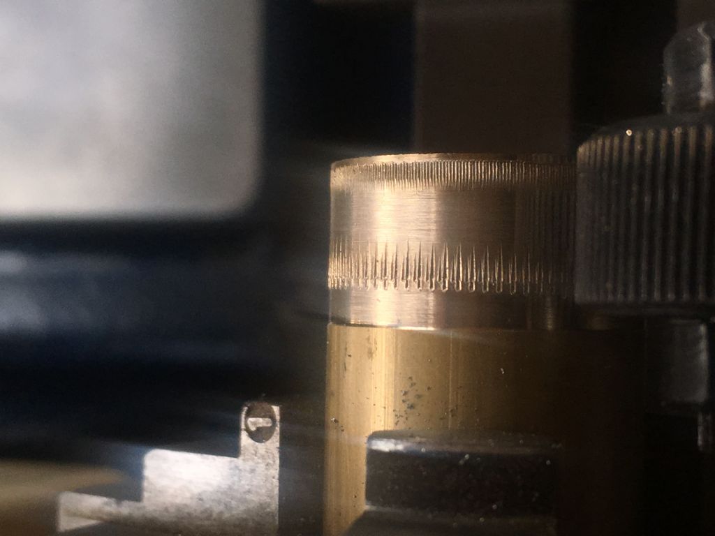

Sherlock10/08/2018 16:33:07
52 forum posts
11 photos
Ok guys, I went with one of the scissor types. Had a little play with it today....
Now, After everything I have gleamed from the subject of knurling, I wasn't expecting things things to go smoothly and I was correct. Trouble is I seem to get knurls on the edges and not in the middle, like rail tracks.
I know there are other problems on there such as double lines etc, but been trying to save on wasting stock so using the bar more than once to practice on to see if I can get it to cut in the centre to no avail.
I tried changing the wheels from diamond to straight. Tried the bar stock rough, then tried after turning it to size.
tried with and without cutting oil. Clamping directly on centre and a little off centre. clamping down quickly to gain a bite. All to avail.. Any ideas where I might be going wrong, Do a pair of 'rail tracks' with no knurl in the middle suggest I am doing something obviously wrong?
Roderick Jenkins10/08/2018 16:54:15
avatar
2376 forum posts
800 photos
The first thing I would do with a small lathe is to put it into back gear, you will need lots of torque. My usual technique with a scissor knurl is to start with only a third of the tool width clamping on the job. I introduce the tool to the job and adjust the wheels so that they are finger tight on the diameter of the job. I then withdraw the tool and tighten the tool by about a quarter turn. Switch on the lathe and then advance the tool with the cross slide. This should produce a good pattern. Once the pattern is set then the tool can be advanced towards the headstock with the leadscrew.
HTH,
Rod
Andrew Johnston10/08/2018 16:57:31
avatar
7061 forum posts
719 photos
Start at one end, with the knurls just overlapping the work. Once they've started to form a good depth of knurl you can move the knurling tool along the rest of the knurl. Trying to form the knurl full width will probably require more force than the tool can provide, unless you have a friendly gorilla in residence.
Andrew
