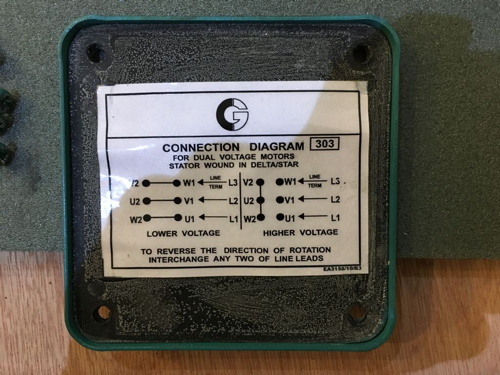

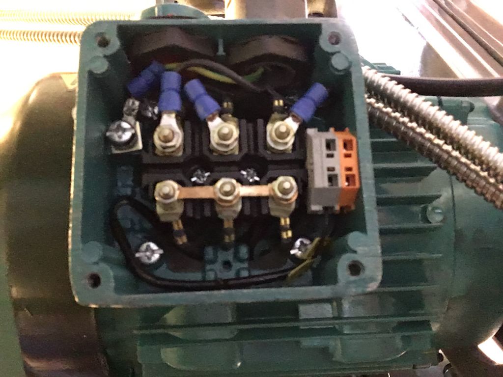

I have revised the controller parameters (they were slightly low, but not greatly so). Slightly improved performance, but still gutless at 50%. I fear that the motor is wired as star, not delta. Unfortunately the S7 installation results in it being almost impossible to access the connector on the motor. Checking/changing this will be a PITA!
I’ll post the results when I have dug managed to get access to the motor: this might take a while...

The cover plate is not very useful, but reference to t’internet suggests that the motor is wired as star.

You need to remove the three links connected in series first.
Then, place them as per the left image on the lid, I2 connects to W1, etc....
The links will appear side by side if you wire it correctly.
This will remedy your lathe's poor performance....
If the motor runs in the correct direction, dont swap the incoming wires...

John, thanks for confirming that the connections are wrong. I’ll rewire & try again after dinner.
