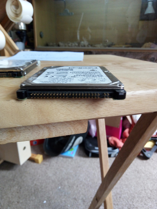

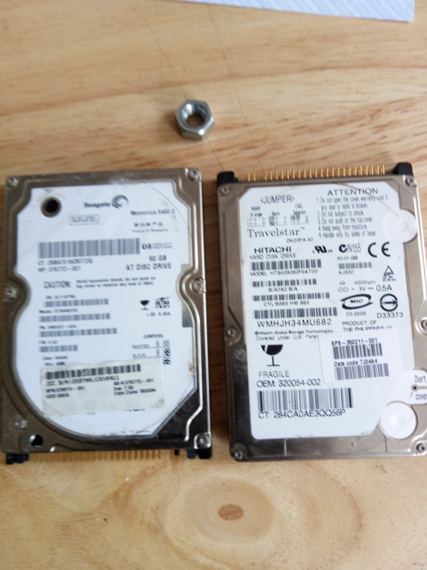

have got 2 old hard drives from a laptop which died couple of years ago.
is there anyway to get info of them?
think all my old bike pics are on them.
i know you can get boxes to fit them into as external hard drive as got one guy at work sorted it for me but as left now.
but wouldn't know what type to get.
or even if i could get usb cable to fit them.
not good with comps would normally speak to eldest but in japan at min.

If you still have the laptop then pull out the HD connectors
Then find out what they are called
Then search ebay etc for same connections at one end and usb/sata/ide connectors at other end so you can plug them into a working unit
One problem may be master/slave jump switches, you should configure as slave if you are piggybacking onto an IDE/sata
USB is simplest route if you can find it

HD connection is IDE, try this:- **LINK**
Regards Ian.

If you do a search for 2.5" IDE external drive case, you will likely come up with something like this for not much money. (other sources are available wink ).
Pretty much plug and play, your host PC should automatically assign a drive letter for it, but note that the USB connection lead appears to be a splitter.
It's not, the single end goes into the external caddy, and the double end needs both plugging into two adjacent USB ports on the host computer. Only one carries data, but the other allows for additional power to be drawn, as USB only supports a limited current output to power external devices.
Make sure your Antivirus/spyware is up to date before plugging in your external case, scan the drive before otherwise accessing it, and maybe even work offline initially to be even safer.
Copy your data as required, and then use your new-found external drive as an off-site backup for your data, or as an operating system image for emergencies.

If you already have an old desktop it might be possible to plug your hard drives in as second drives. Then you don't need to buy anything at all, take the side off and see if there is a spare plug

I have got data off an IDE drive with a USB caddy, cost, iirc, about £15. With a caddy the disc acts like a USB drive.
