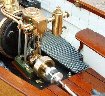

MichaelR03/03/2018 15:01:18
avatar
528 forum posts
79 photos
Posted by pgk pgk on 03/03/2018 14:07:52:
Thinking lazy...I wonder if one could et away with an expndd metal sheet bedded onto steel plate with a thin layer of clear epoxy?
pgk
I used that method on my model boat, bonded on with Araldite, then painted matt black then fine sanded the paint off the diamond ribs. The alloy diamond mesh was from a car body repair kit. Mike Checker Plate
