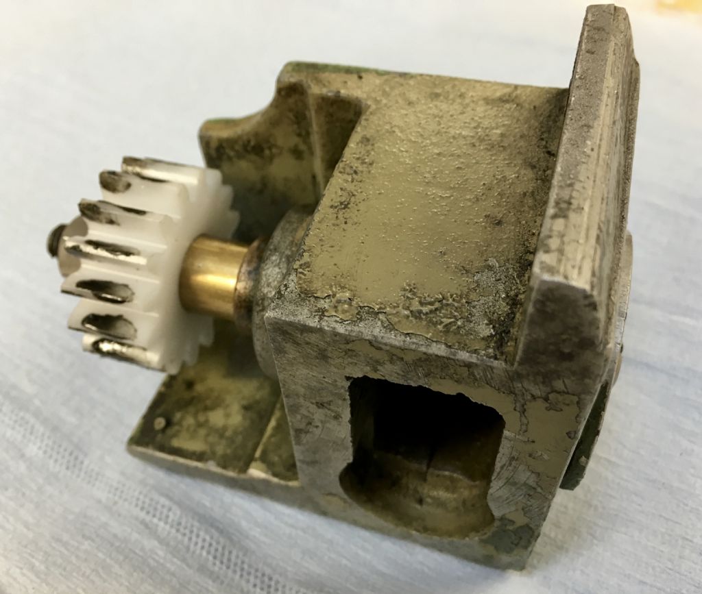

Hi there.
Bit late joining this thread but suddenly had to remember how to cut threads on a lathe the other day.
One problem was that previous users of my M300 had decided to loose the small gear wheel. pin and bush on the DTI
Looked for a replacement in the usual places including Harrison's themselves but they were wanting silly money.BTW I guess you will all know that small Harrsion lathes are all sourced via Taiwan.
Somebody recommended HPC Gears in Chesterfield and they suggested that I try a 16 tooth gear to run up and down the imperial 4tpi lead screw. Part No. ZPG2-16
I turned up an new bush and drilled the nylon gear to accept the 1/8"dia pin.
(Is it my imagination or is this device a mixture of imperial and metric measurements?}
Works just fine for others in a similar boat.
Gear wheel plus post and packaging and vat was £22.
Somewhat better that the £100+ prices I had seen.
Cheers
