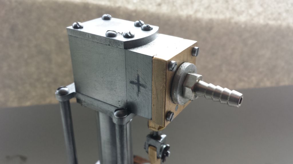

20180318_085902.jpgHi All
I am currently designing a small displacement lubricator for my jepson engine.
I have decided to go for the type which attaches directly to the side of the valve chest where the cross is in the photo.

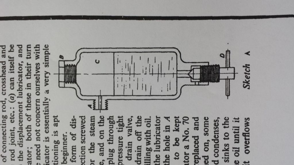

I am using a the simple drawing from a K.N. Harris book as the basis for the design but do intend to add a needle valve to regulate the flow. K.N.H. recommends a No. 70 drill for the20180316_150928.jpg oil supply hole (0.028". The smallest drill I have is 1 mm. so I felt that adding a needle valve would be advisable.
It is easy to see how steam under pressure enters the lubricator however I am puzzled as to how the oil travels back into the valve chest. K.N.Harris has no idea either. Anyone got any thoughts?

Posted by geoff walker 1 on 03/04/2018 19:06:12:
My theory is that it is a dynamic system, not a static one.
Pressure causes steam to enter the lubricator.
The steam condenses and drops below the oil, allowing more steam to enter, until it raises the oil level level above the hole.
The constant pressure cycling means the oil and steam can gradually change places. If the pressure drops so oil drips out, then when it rises more steam goes in when the pressure rises and back to the start.
I would guess that the death of such an arrangement is if the hole is too long so the oil never gets 'sucked' out the end when the pressure is low or if it is placed too far from the valve chest in a location where the pressure doesn't cycle enough.

Its simply dissplacement - oil and brass body are cooler than the steam passing the opening so a little condenses, water being more dense than oil sinks to the bottom of the holder and in turn dissplaces the same volume of oil - only place for it to go is out the same hole the water came in from - its then moved by steam.

Hi Neil / Fizzy
Thank you for your replies.
Have to say I like your dynamic theory Neil, much the same as I was thinking.
Pressure building up in the lubricator exceeding the incoming pressure of the steam, hence the oil is drawn into the valve chest. I would imagine in some form of misty miasma. Just my thoughts.

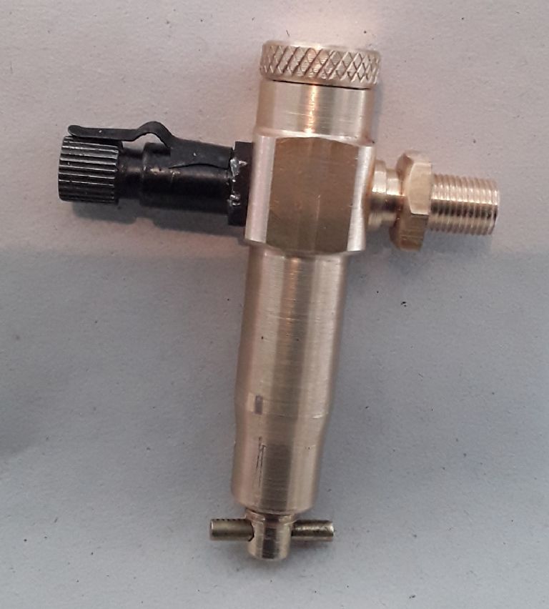

geoff walker 108/04/2018 09:38:32
521 forum posts
217 photos
......and here it is designed and made, just hope it works ok. Body is 1/2 inch square and the needle has been salvaged from an aero carb
